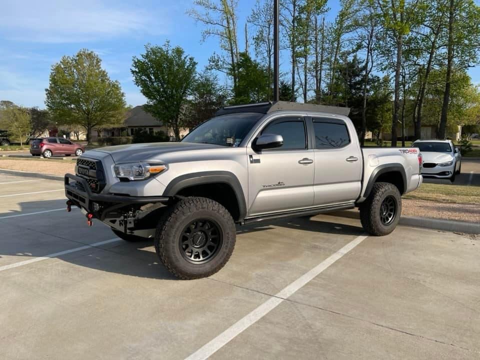

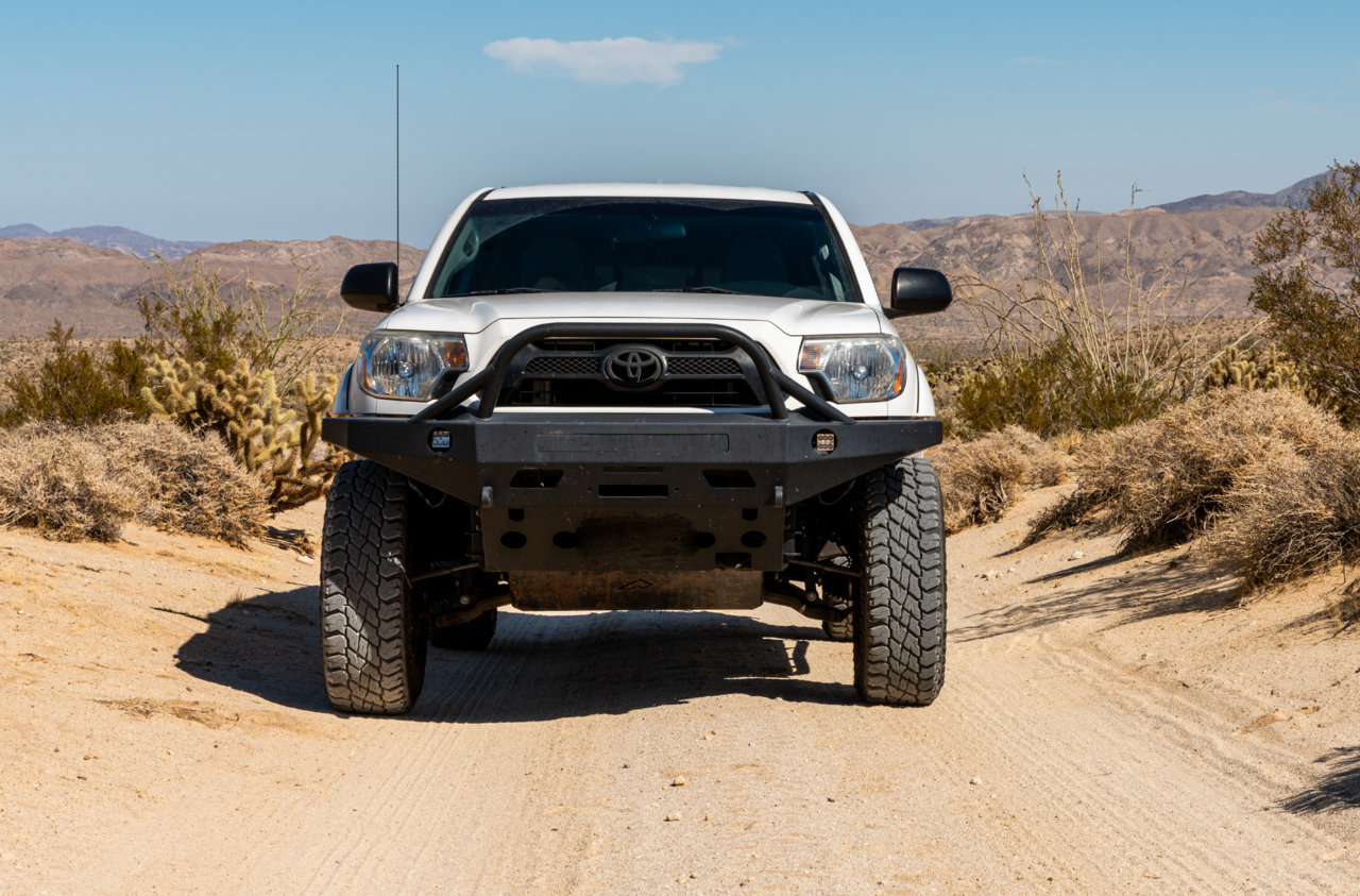

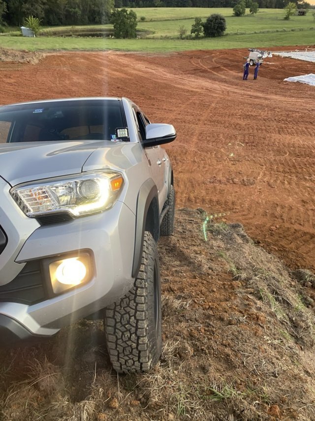

    35x10.5 Kenda Rts still trucking along. Put them through a week of desert at Koh without a problem, drove home smooth and quiet back to Washington. Near 27k miles on them now.

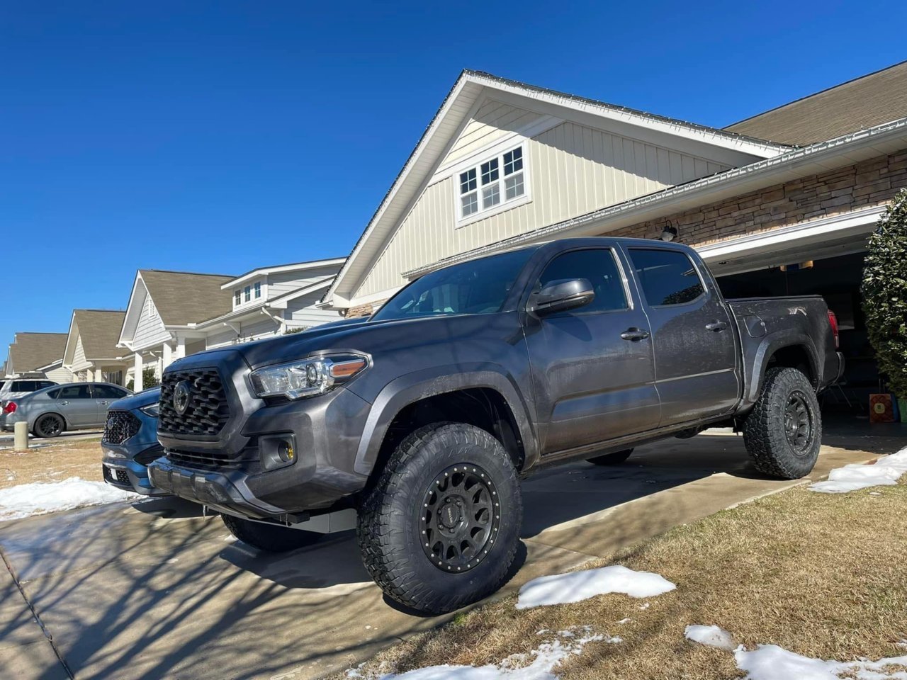

    17x8.5 methods on Toyo 255/80
    These are other members trucks

    Loving my Coopers. 255/80/17 on a 8.5 rim. It's my daily, i have a 60 mile round trip commute 4 days a week. These don't kill my tank as bad ass 285 mud terrains did.
