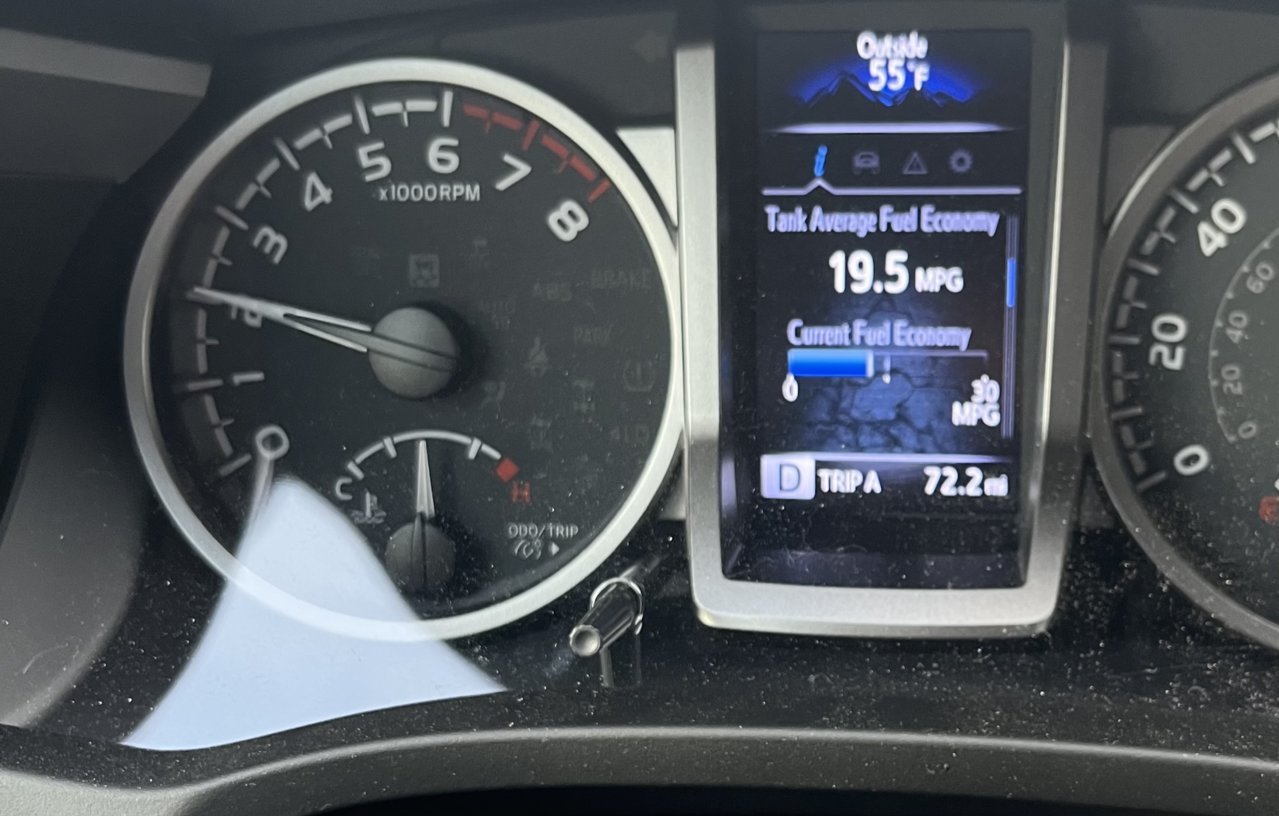

    Quick update about my mileage. After changing tires and losing 3 mpg I started combing the forum. I did some messing around with tire pressure. I use a Blue Point (Snap On) analog gauge. I have settled at 34 psi in the front and 31 in the rear. I took a 100 mile trip through hell from Harford County, Md to Burke, Va. I was on 95/295/495 dealing with aggressive driving and speeds ranging from 60-80 mph with less than ideal conditions with lots of slow downs and speed ups. Anyhow, I took a picture of my dash indicator and when I topped the tank off on the way home I did the calculation and came up with 19.3 mpg. I am satisfied with this. My final thought is this truck does Ok with highway mileage and not so good around town. I am averaging around 15.5 around town.

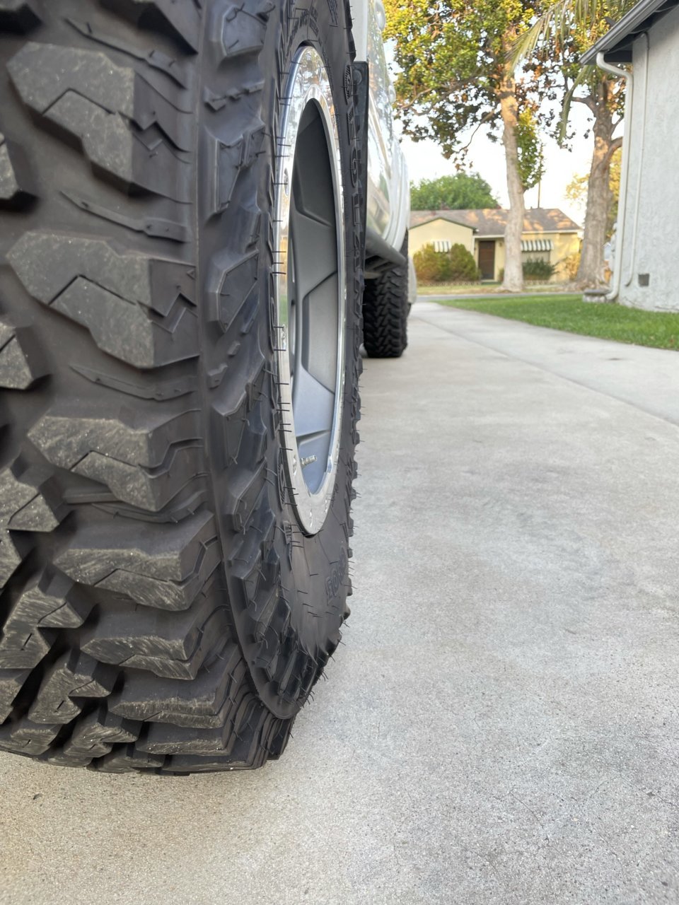

    Nice I’m running 33x10.50 Kendas on a zero offset wheel with no rub. Are getting much rub with these and what offset wheels are you running? Thanks

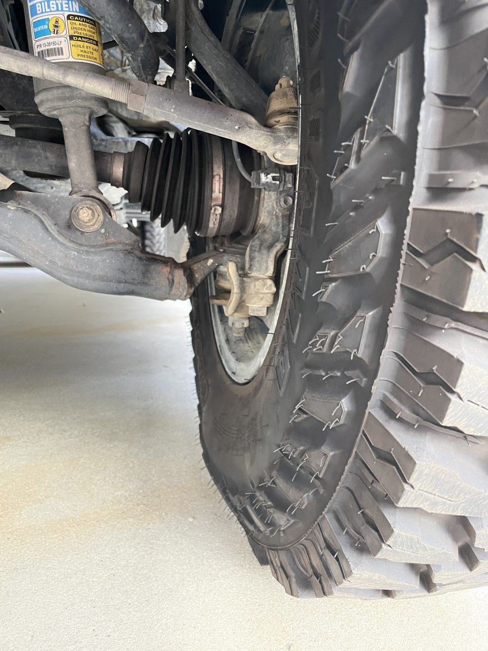

    Yeah I ran the 33x10.5s with little rubbing as well. I have +18mm wheels with 2'' wheel spacers currently which is needed for rear shock clearance. When I had just 1.25'' spacers/same +18mm wheels on, I had to cut the cab mount as far back as possible, pound the firewall, pound the pinchweld, get rid of almost all the fenderwell plastics, slightly trim the front fender near the door, and trim the flares just a hair.
    The 35s will bottom out on the inner fenderwells in several places no matter what your offset is, unless you run a bumpstop spacer.

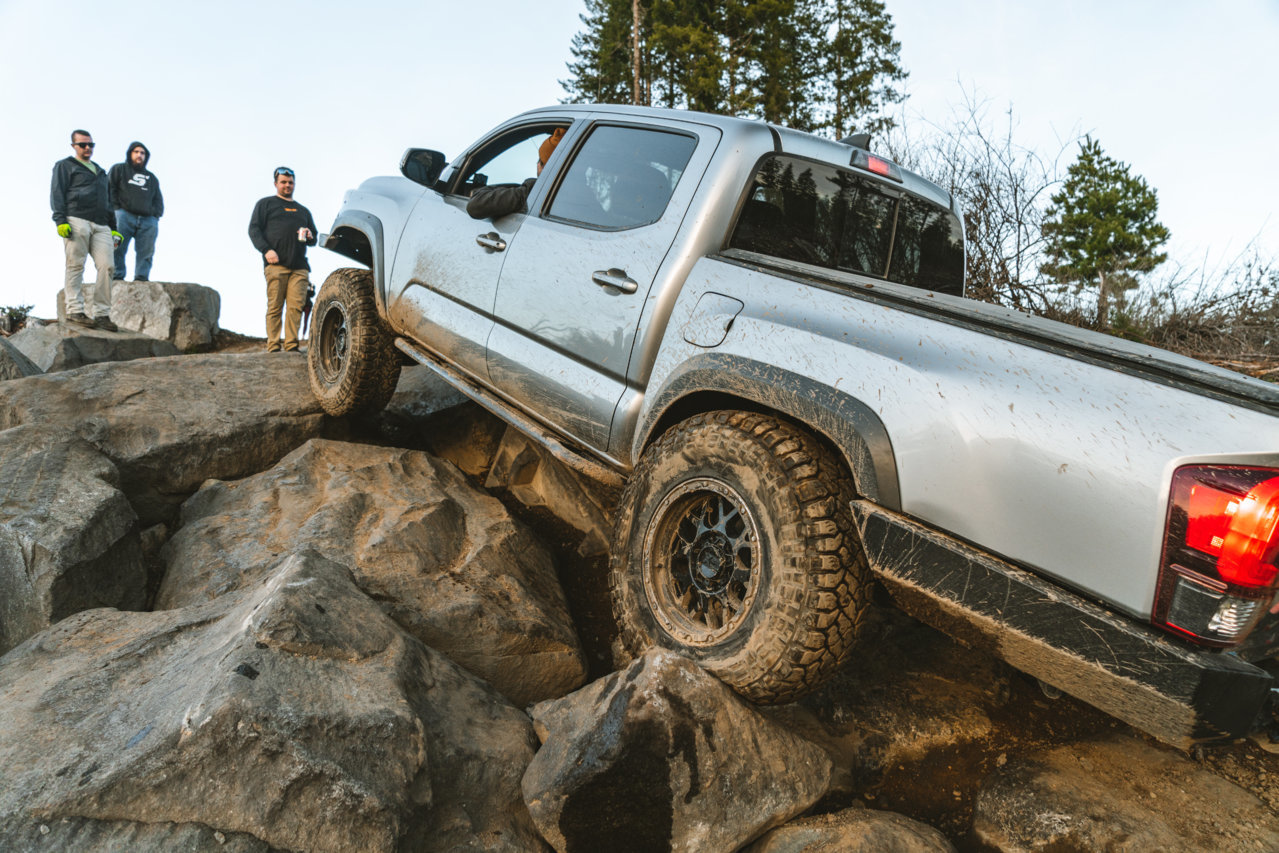

    I am running 35x10.5R17 Kenda RT’s on 17x7 +4mm T4R Pro Wheels. Had to CMC, hammer pinch weld flat, hammer firewall and inner fenders. Trimmed the bottom rear corner of the fender and I ditched my fender liners instead of trying to heat mold them. I didn’t have to cut the fenders and flares but may still do it later if I switch to a 35x11.5. Running SPC’s with LCA all the way forward. I pulled my coilovers and cycled lock-to-lock with stock bumps and it still had to do some self clearance the first time out on the trail. After that, no rubbing. This was also all done originally at stock ride height.
    @Buttskevin21 and I used pretty much the same formula to make it work.

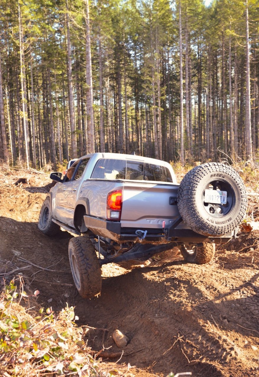

    Thanks for all the info. Did you happen to take any pictures of what you had to do to get the spare up there?

    I can try to snap a photo later but you’ll need to cut the exhaust just after the axle, cut of the exhaust hanger from the frame and hammer the tabs flat on the cross member. I also moved my spare back about an inch but I don’t think that is needed.
