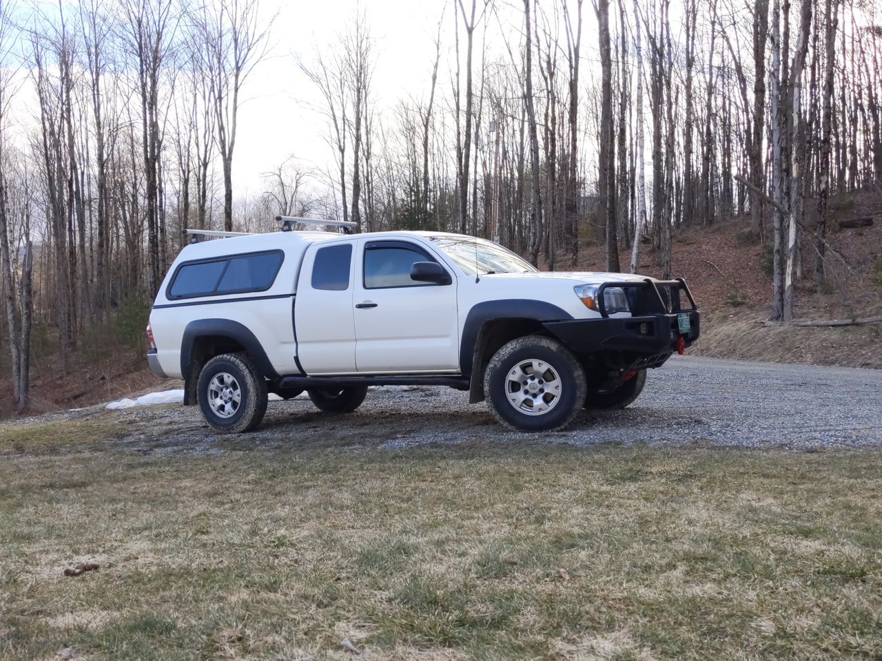

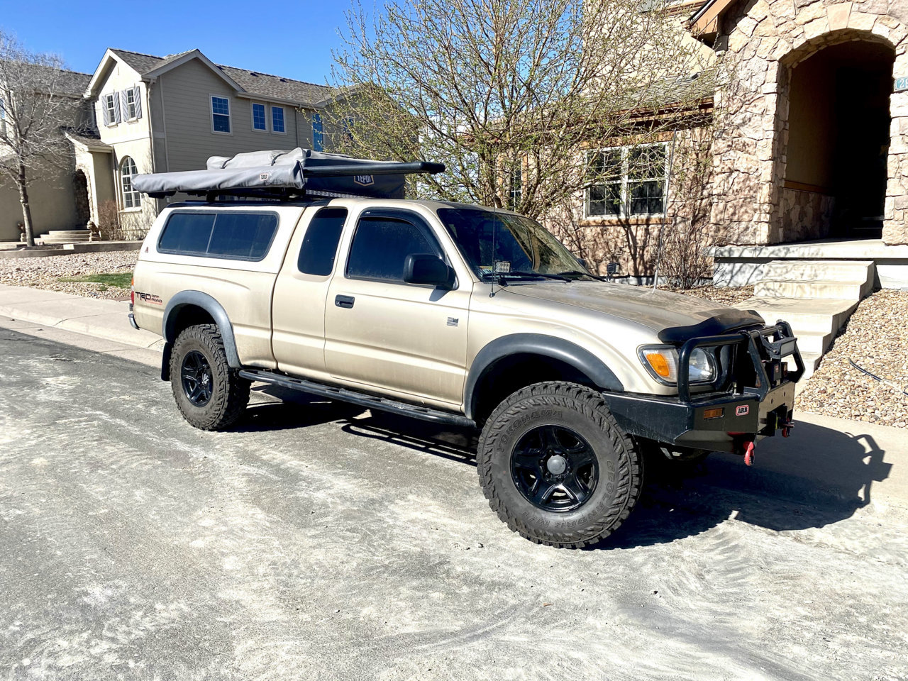

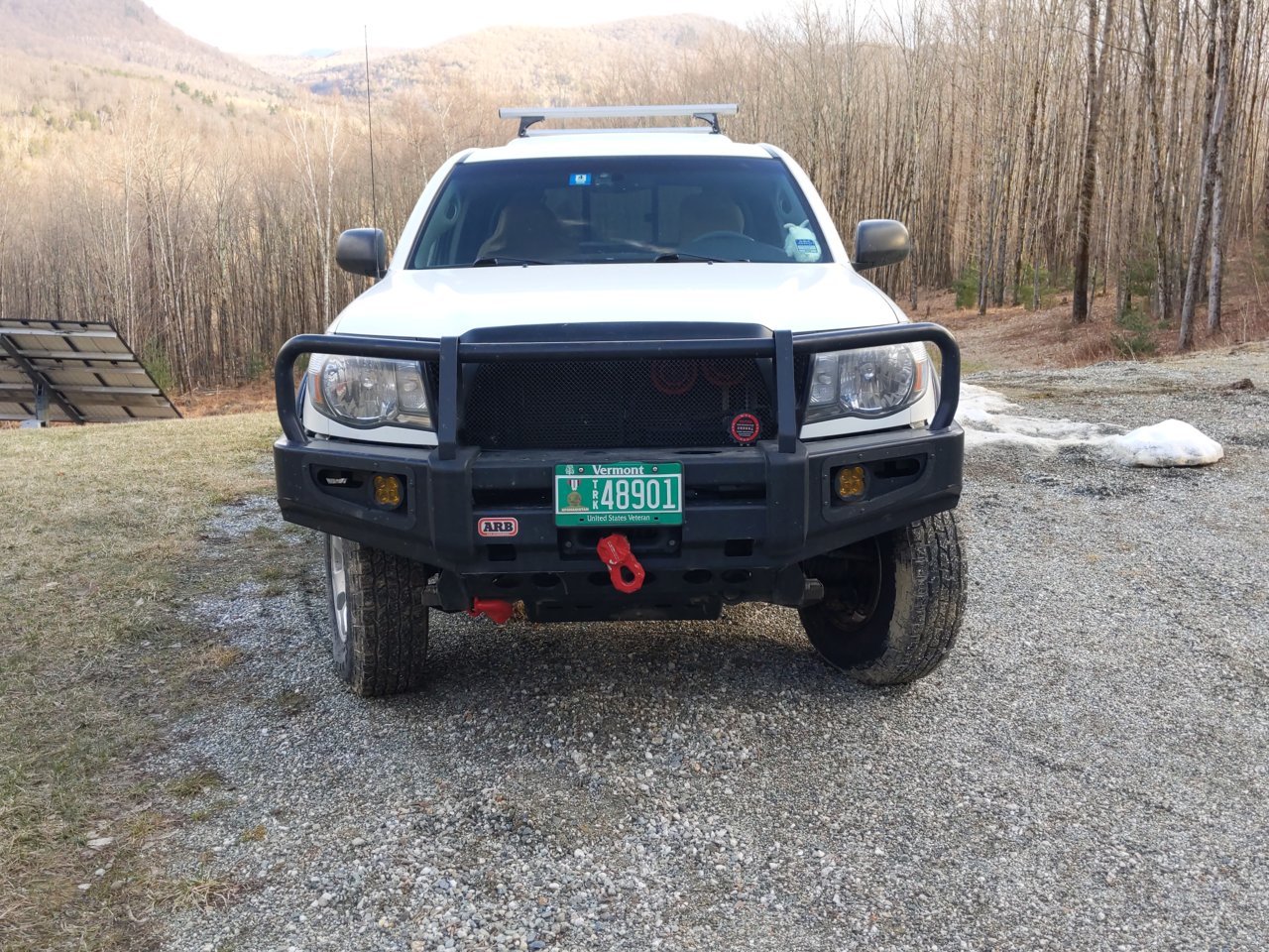

    Thanks for this, any chance you have some dead on front and rear shots to see how wide the tires/tread look?
  5. Mar 25, 2022 at 11:21 AM
    #4925
    climber-420
    climber-420 I love tight cracks
    Sep 29, 2008
    #9583
    321
    CO
    2004 Gold Ext Cab TRD 3.4L V6 Manual
    255/85/16 BFG KM2's, 3" OME lift, Dakar's, Nitrochargers, Grey Wire Mod, ARB Bumper, ARB CKMA12 air compressor, WIts End Pacifier, Warn M8000, Uniden 520 XL CB, rear diff breather mod, full time power to aux 12V outlets, Rago Fab ditch brackets, Titan Rod Vault, Extreme LED's front and rear,
    Nope, but I can go take some here in a bit and post it up.

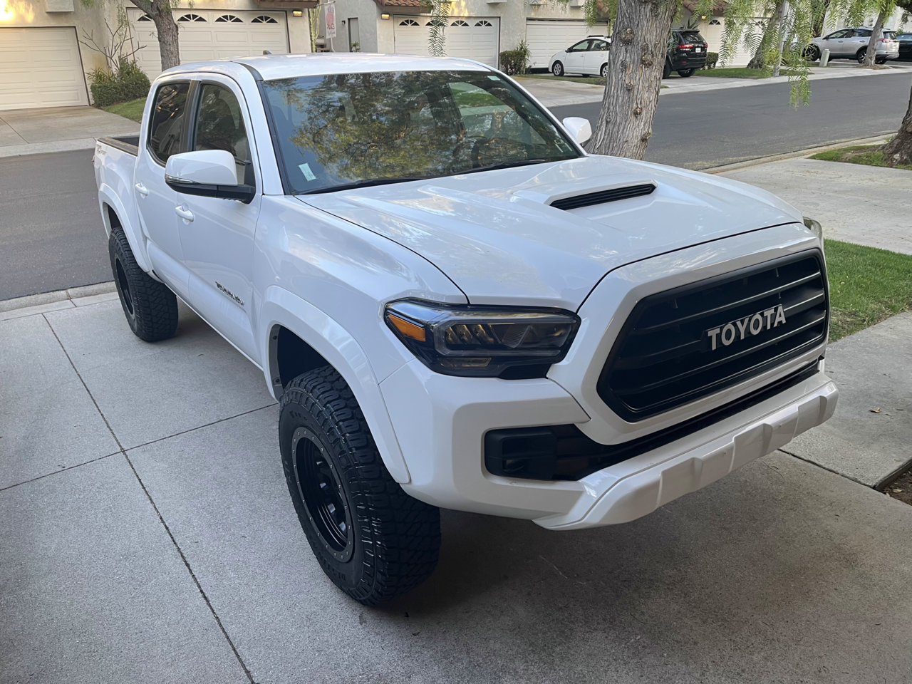

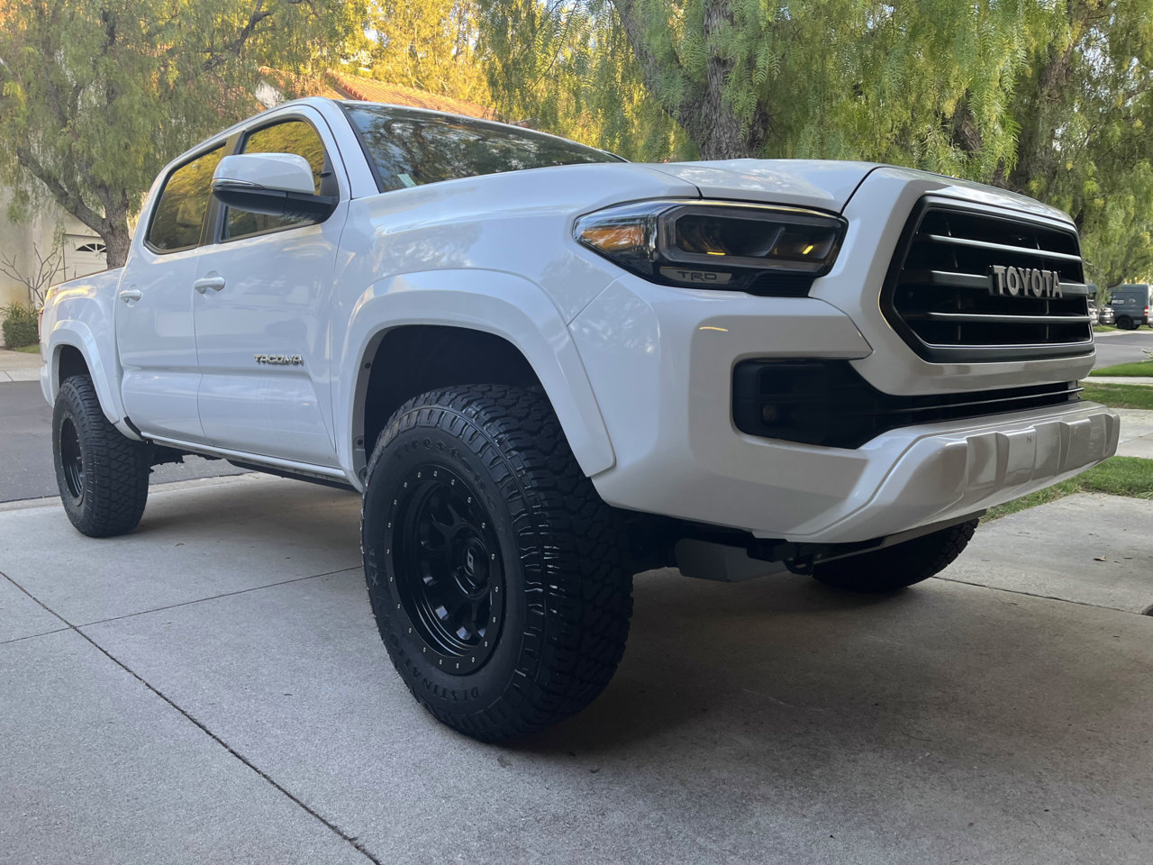

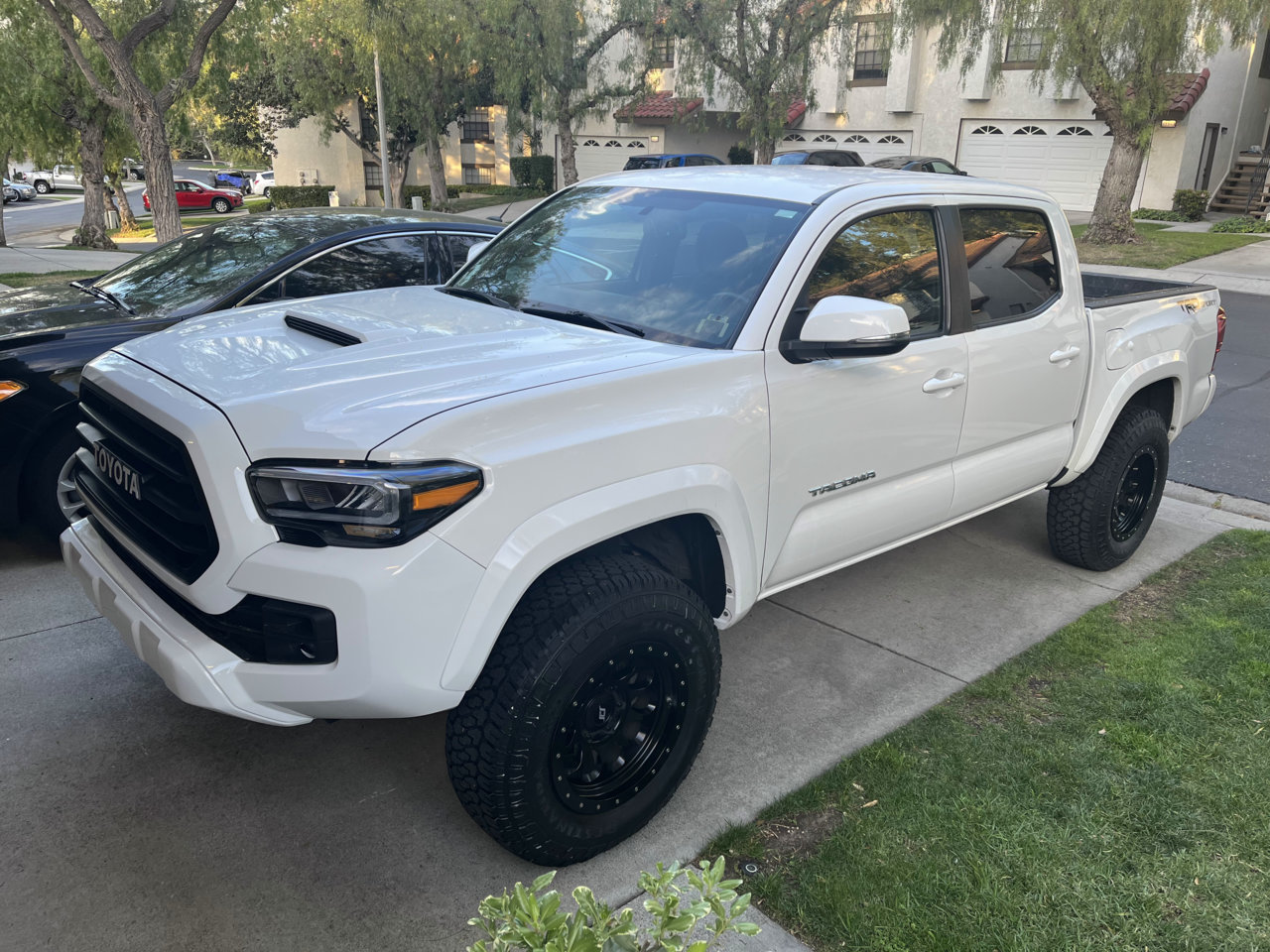

    Just got the 255/75/17 Firestone XT's on today.
    I think I might have got one of the last one's in stock for now I guess there is a production shortage with the XT's according to Firestone. I tried a bunch of different local tire shops, Firestone stores, and tire specialist like Tirerack.com. They were all out but I happen to stumble across them on Amazon and they surprisingly had them in stock and shipped them to me at separate dates.
    They're don't quite fill out as much as the what I previously had (285/70/17) but am pretty pleased with the looks considering the trade offs. Def looking forward to trying out a skinny tire for the first time. I do think these XT's are the lightest weight most aggressive tire in this size that will relate to better MPG/functionality. The duratracts were right around this same weight but I think the tread pattern will effect mpg/performance as others with experience have mentioned. The XT's are only 40 LBS.
    Here's a thread on the XT's if you'd like to see:
    https://www.tacomaworld.com/threads/firestone-destination-x-t.623548/
    So far already feels a lot lighter. My only issue is the rims I have (SCS Ray 10's) are 8.5 which is the max width for this size and they bulge out a little more than I'd like. Might be switching to the Pro rims down the road or if anyone has any other suggestions on light weight rims I'm all ears.
    Anyways wanted to share this set up here to help those wanting a visual if you're thinking about going this route.
