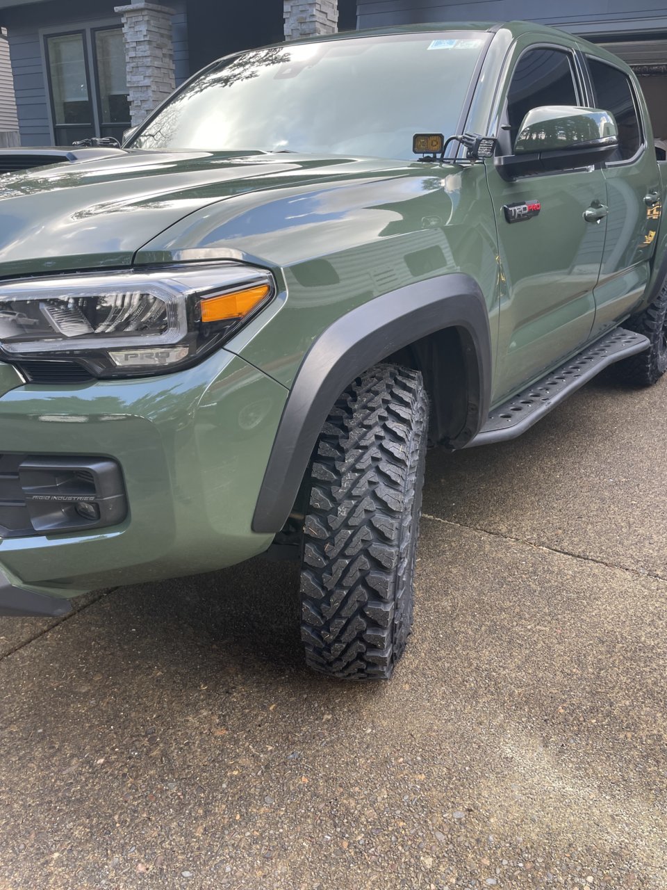

    what are peoples thoughts on having a factory size spare with their tall skinny tires? plan on putting spare on rear if i ever need to, but cant quite convince myself to spend another $500 to get another 33" and oem rim... pic because i think it should be illegal to post on tacomaworld forums without including one ;)

    33’s or 35’s? Can’t make it out from the picture
