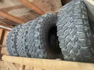

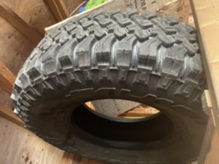

    Hey everyone-
    I sold my taco with the winter tires on and still have these in the garage. I ran them for maybe 4-5k miles before winter last year. They are [​IMG][​IMG]33” tires that fit on my 2021 without a lift and without any rubbing. I’m not on here much anymore so feel free to call/text me at (3zero3) 720-1065.
    $750
    Prefer local pickup in Montpelier VT but would consider shipping at buyers expense.

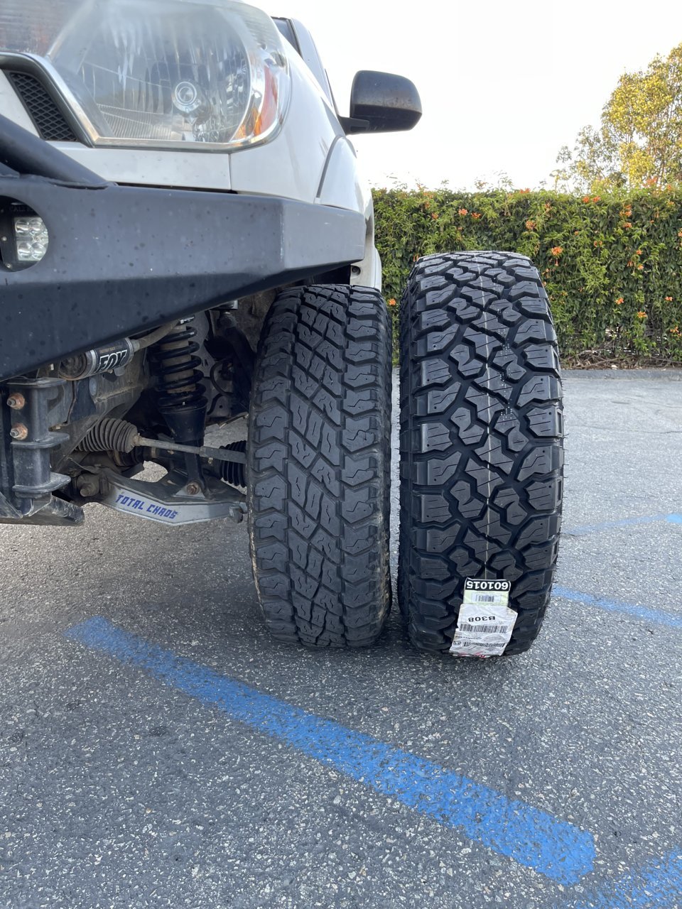

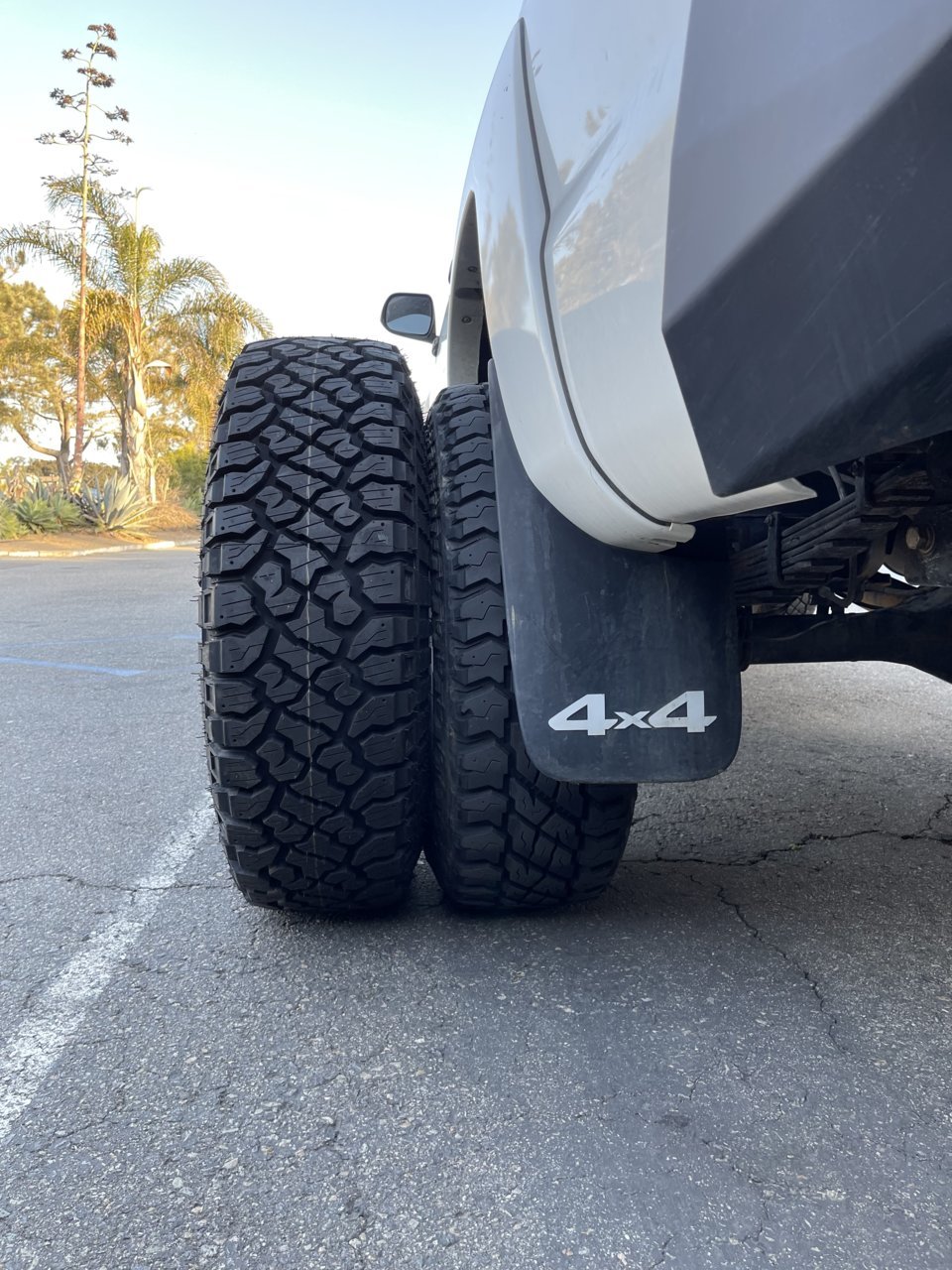

    2015 Toyota Tacoma TRD Off Road 4x4
    Things and Stuff.
    Bumping up from 33’s to 35’s. Skinny gang! 255 coopers to 35x10.5 kendas.
  16. May 13, 2022 at 8:43 PM

  17. May 13, 2022 at 9:14 PM

    2016 TRD OR DCSB
    Yes, very curious about this since I have skinny 33s and want to run these kendas down the road
