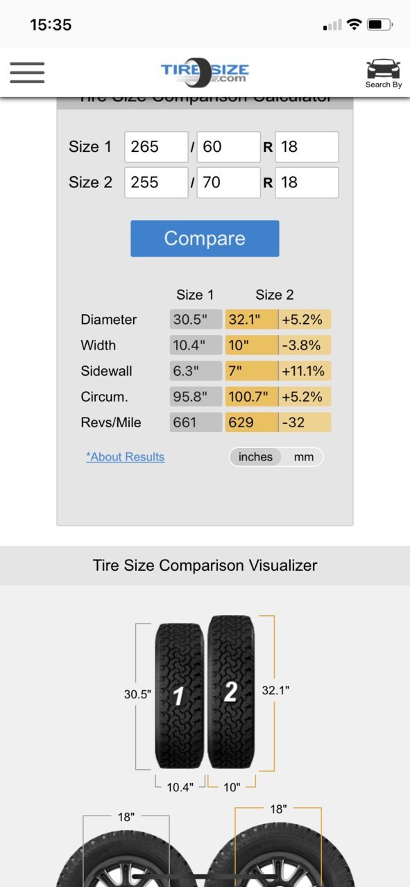

    Considering 255/70R18 tires over my stock 265/60R18’s … moves it to a 32.2” tire. Just finished installing my Bilstein 6112’s at full height, SPC UCAs and ICON RXT in the back. 2014 DCLB 4x4. Trying to avoiding any rubbing or cutting or re-gearing..your thoughts?

    That’s strange.. I’ve driven Pikes Peek in CO with stock 265/60r18’s and had no issues…rarely downshifting to 4th. Maybe I’m missing something… if so apologies.

    One of the differences is @codemancer has a 3rd gen which is notorious for gear hunting and I think @NmapFE has a 2nd gen which is pretty good at hills (I've driven both).
