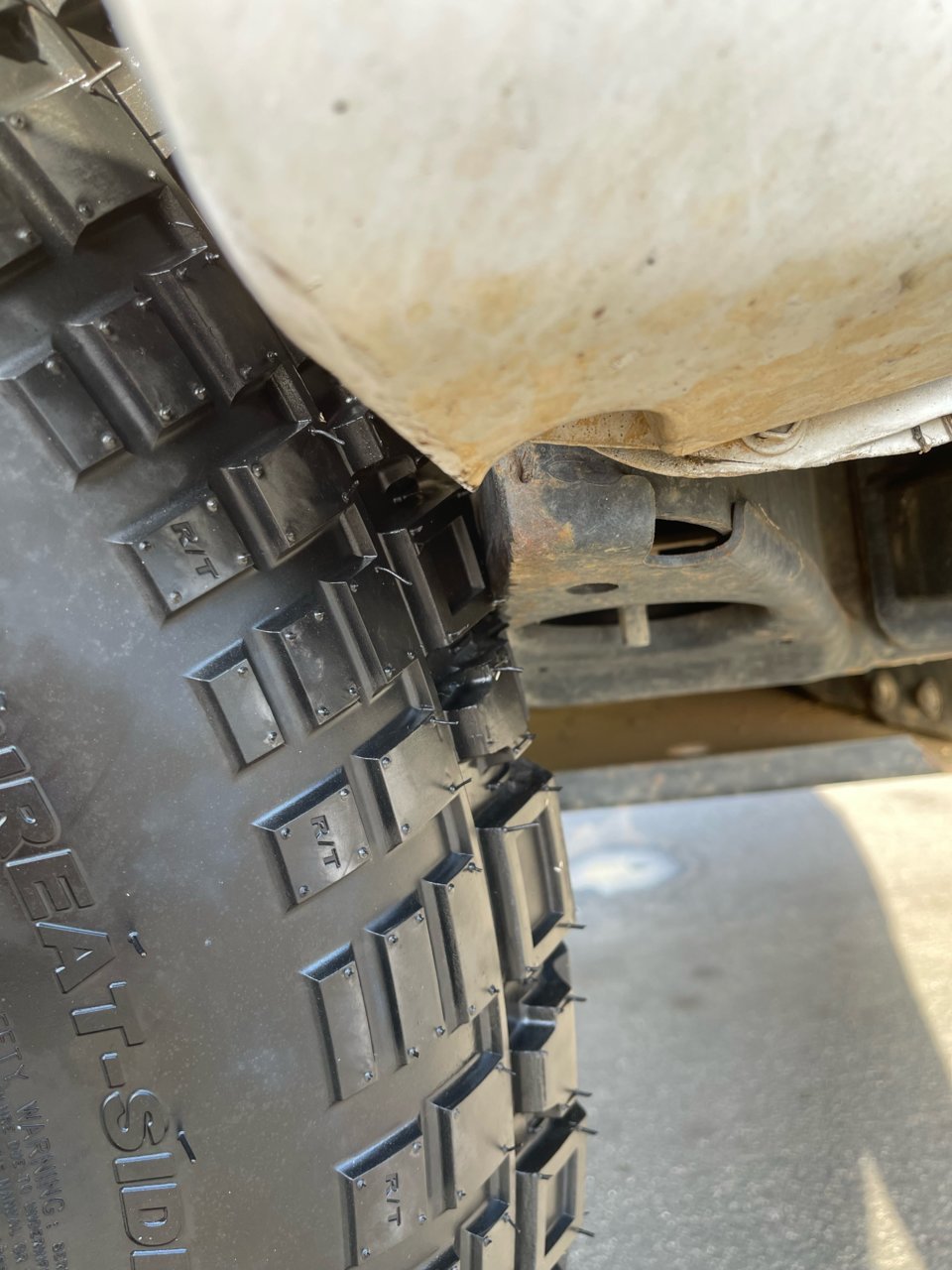

    Get an alignment and have them set as much positive caster as possible, should help getting it away from the mount.

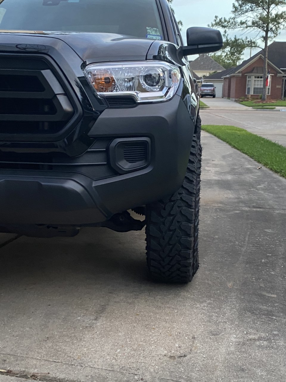

    255/75/17

    What brand/model are those guys?

    Yokohama G003

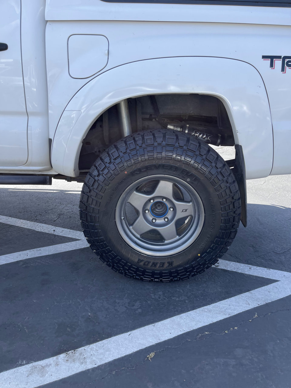

    I got tired of waiting on the Mickey Thompson Baja Boss 255 85 r17s (35x10) to be in stock so I bought some 35 10.5 Kendas! Hopefully I can get these on next week.

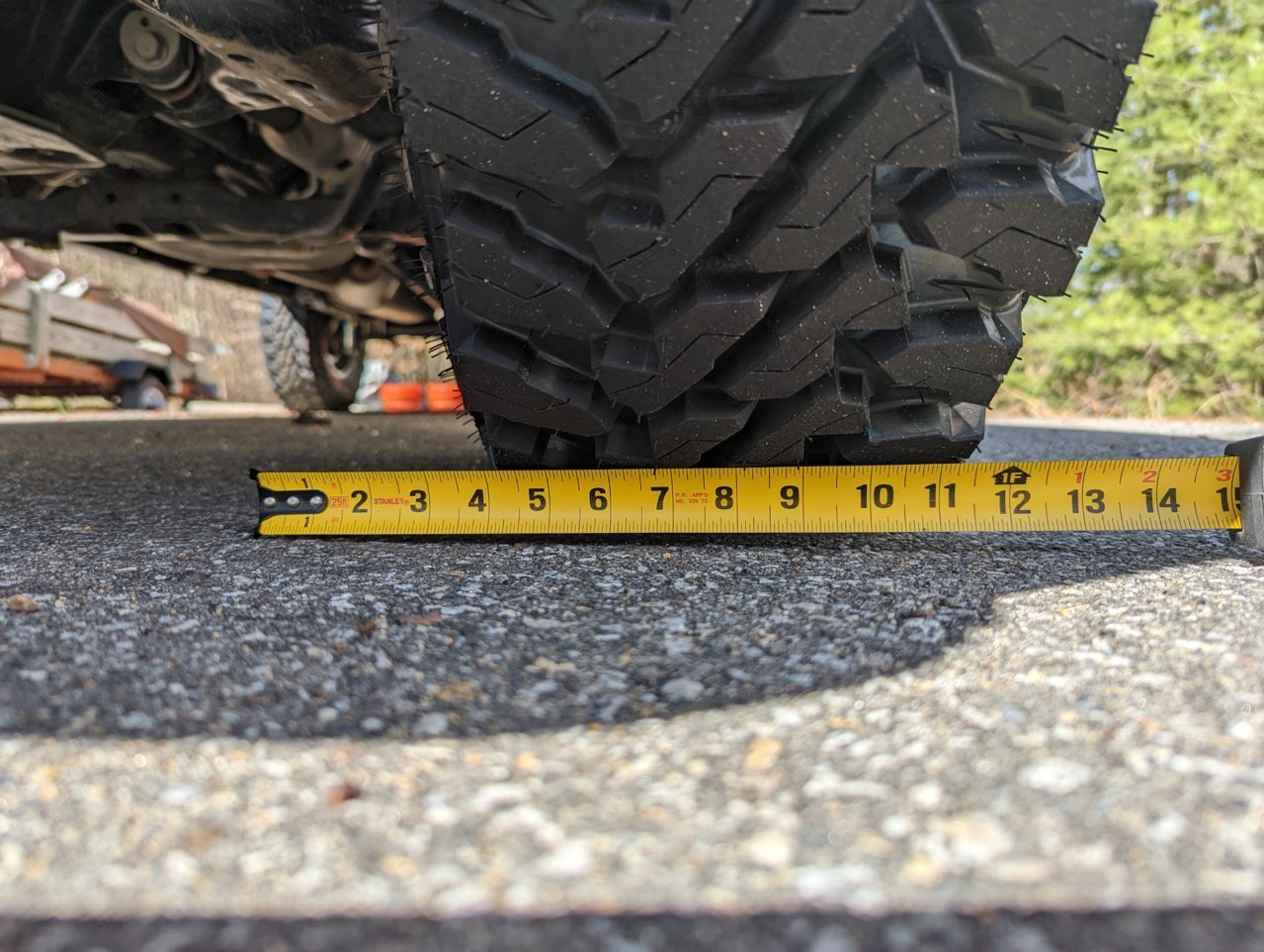

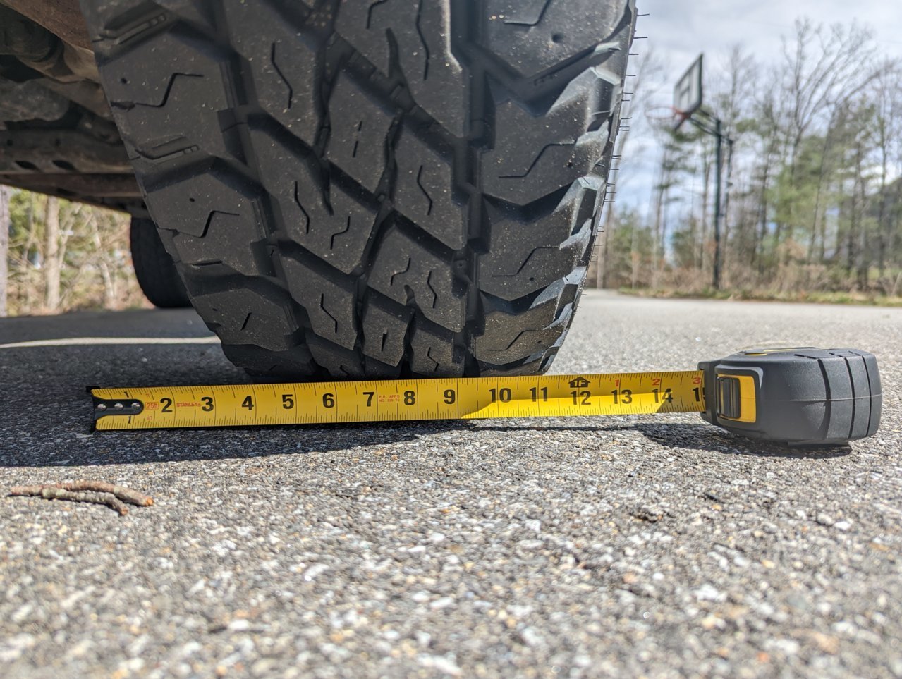

    Thanks again for this measurement. To your naked eye do they look vastly different in width from what you remember/see?

    What’s the blue right inside the center cap around the hub?

    That cab mount will rub even more under full bump.

    Spidertraxx spacers

    Yes, that’s a spacer. I was making contact with the bypass shock mount on my lower control arms.

    It kinda depends on what point you look at on the tires.
    I don't notice either of them being "significantly wider" than the other.
    Next time my son comes by I'll try to take a "head on" photo of both trucks side by side.
    He's more lifted than I am, so proportions won't be exact, but both will be mounted on the stock size wheels.
