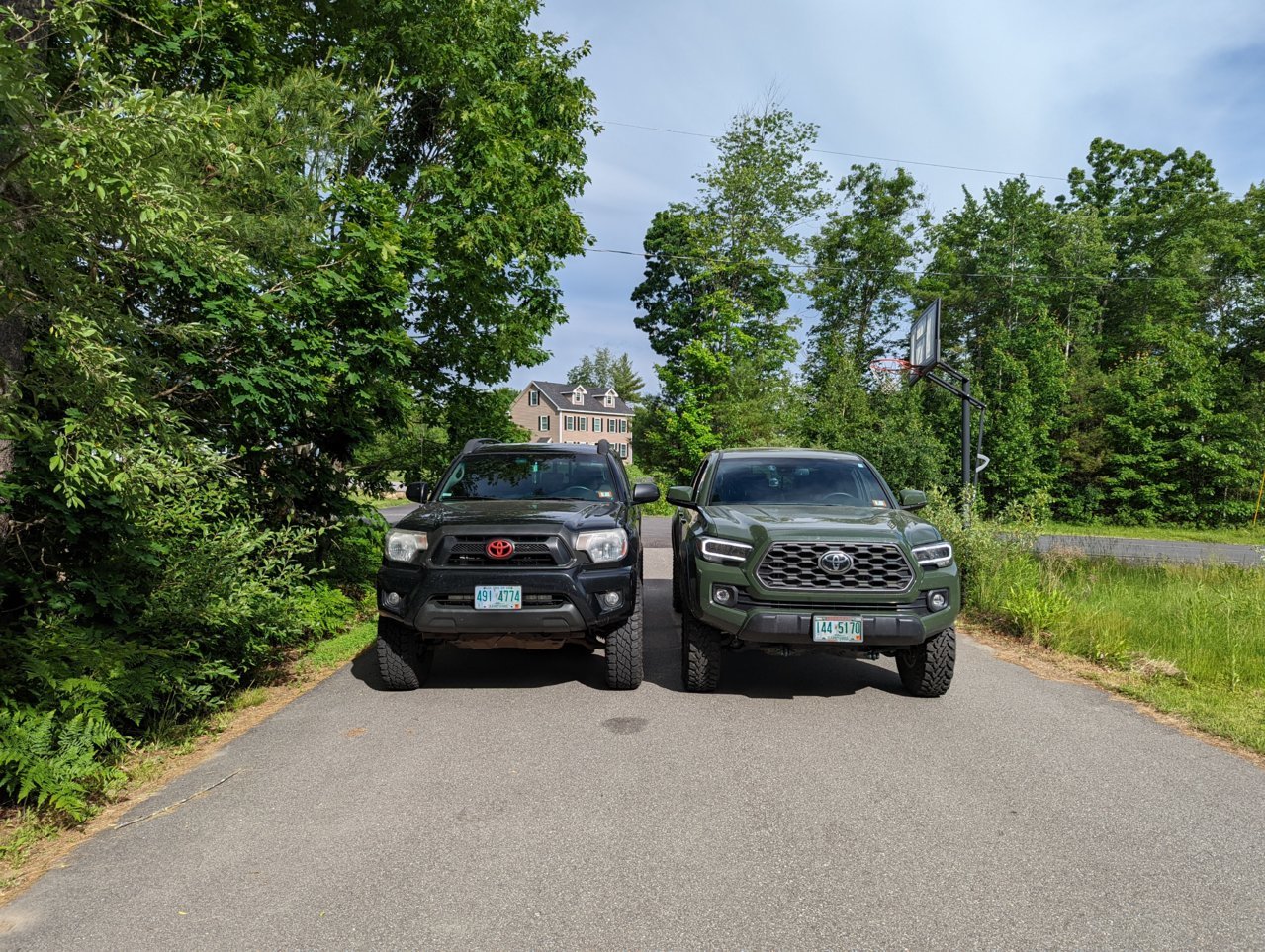

    Pics of my son's 2014 (with 2021 SR wheels) with 255 85 16 Cooper ST MAXX (left) and my 2021 (with 2018 SR wheels) with 255 85 16 Yokohama Geolander MT 003s.
    Mine has 5100s with 885s, his has 5100s with 886s, so his sits higher than mine.
    Also, in the pictures it looks like his has more "poke", but that's because he has his fender flares removed right now.
    At this point I'm pretty sure the coopers look wider because they are a bit "fuller" (i.e. the % of tread that is "filled" is higher) than the Yokos.

    I can't express how much I appreciate the follow-up besides to at least just leave a like. Members like you make this a great place.
    This actually puts them much closer that I thought they were. For sure I think you're right with the tread on the Maxx going a longer width of the tire makes it fuller. But it's actually closer than I thought. I think I'm going Geolandars just dur to price at this point...and they do have a mean side profile.
    Again, thanks so much!

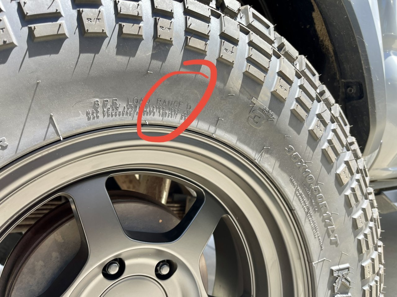

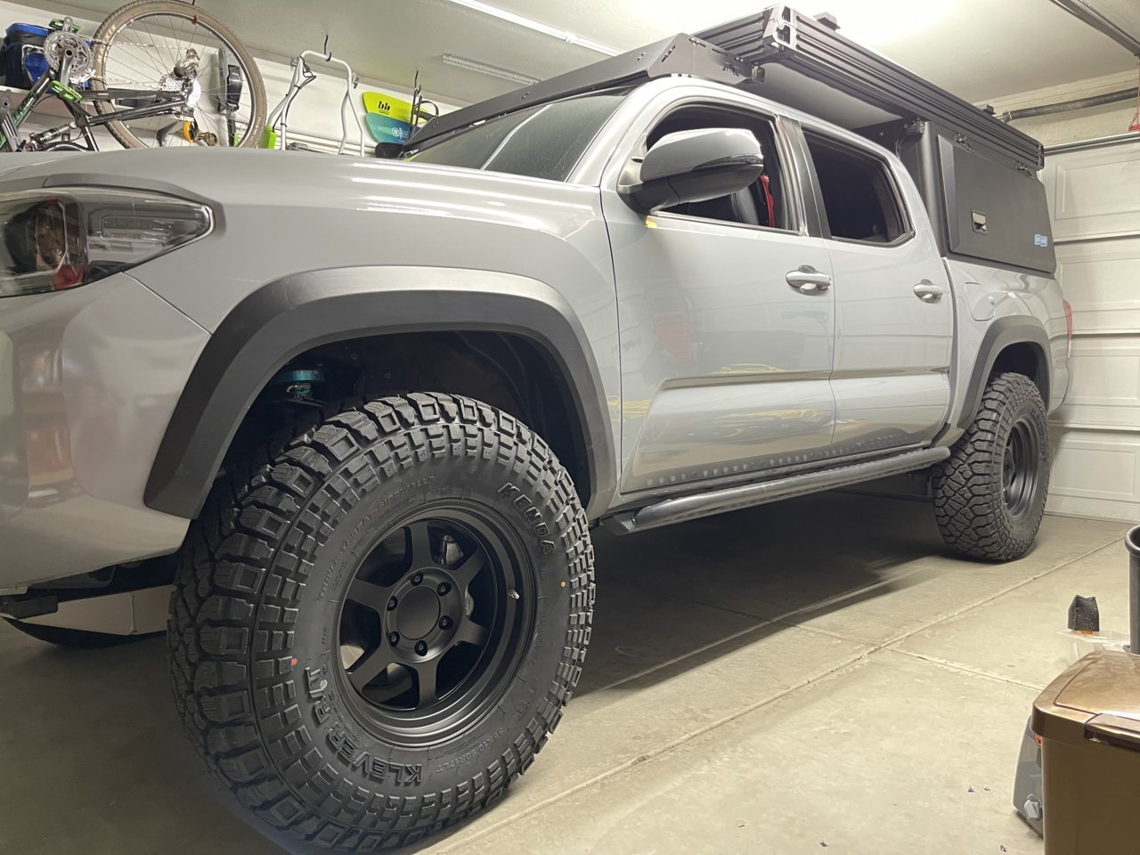

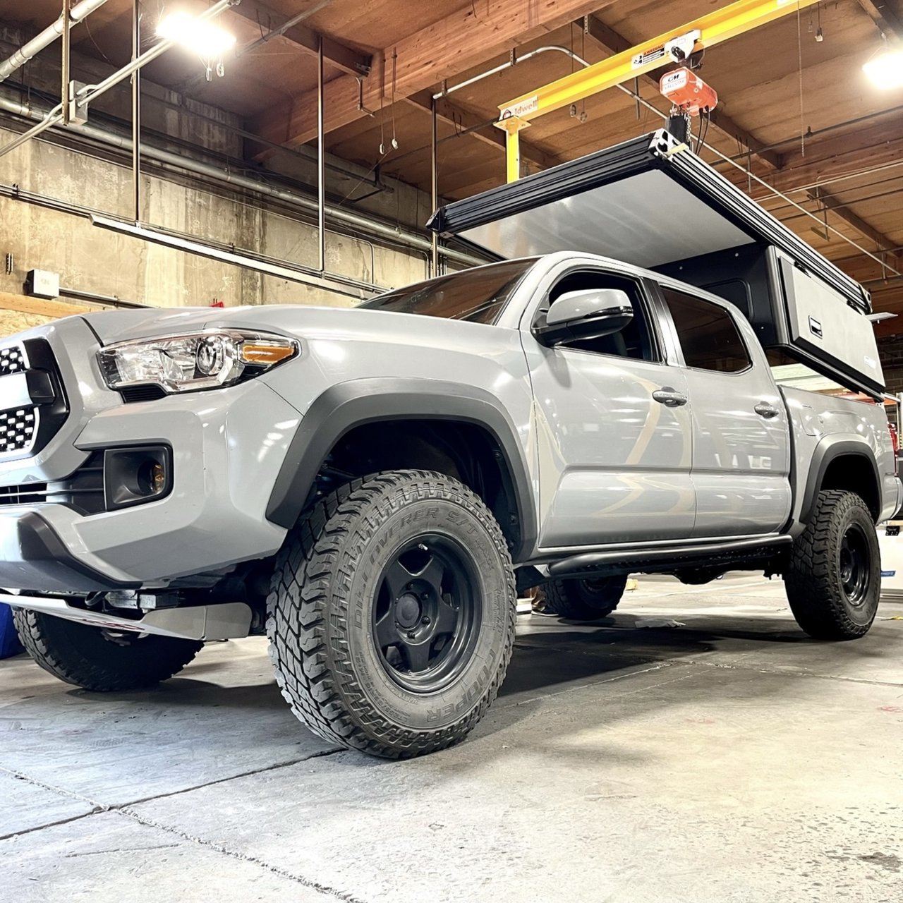

    35s are on and I can still fit in the garage with the camper! The ride is noticeably smoother with these being D load compared to E load ST MAXX.
    Kenda klever RT 35 10.5 r17
    Cooper ST MAXX 255 85 r16
  17. Jun 17, 2022 at 11:33 AM
    #5237
    montijo505
    montijo505 Moon soon?
    May 31, 2014
    #131003
    2,368
    Rio Rancho, New Mexico
    08 4Runner SR5/ AKA The Great White Pig
    I thought those Kenda were E rating after all?
  18. Jun 17, 2022 at 11:40 AM
    #5238
    99ranged
    99ranged Well-Known Member
    Feb 29, 2020
    #320675
    305
    Northern CA
    '19 TRD OR
    D :)
