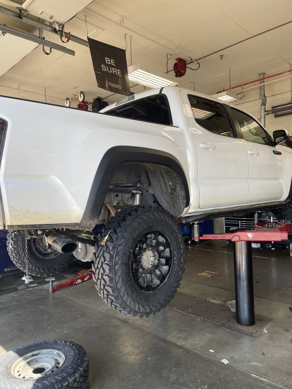

    And in case anyone's wondering about the 7.50-16, I tried it.

    There you go !!!! Now that is slicing some Papa John’s bro ! Lol

    Your personal thoughts when you were running those 235’s ? On road and off road opinion.

    Had Discount Tire mount them and tried them out for a few days but at the chalk-tested air pressure, they felt like they weren't stiff enough across the tread blocks. So the steering was extremely squirmy and dull, wouldn't react very quickly to inputs and bumps in the road made it wander quite a bit. In another thread on here I had pics of the tread face measurement and it was only about 6" of contact with. I swapped them for the 235s from Yokohama to get a little better road feeling back.

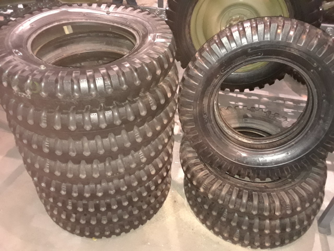

    These are authentic and 'nearly' original pizza cutters dedicated to off-road use. 6.00 x 16.
    The Model T tires are the original and strictly off-road; as there weren't any paved ones then.
    (Ok, I'll cave. Europe had cobblestone roads dating earlier than 1908...)
