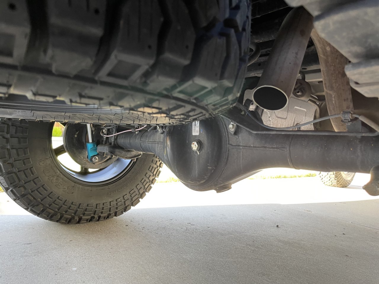

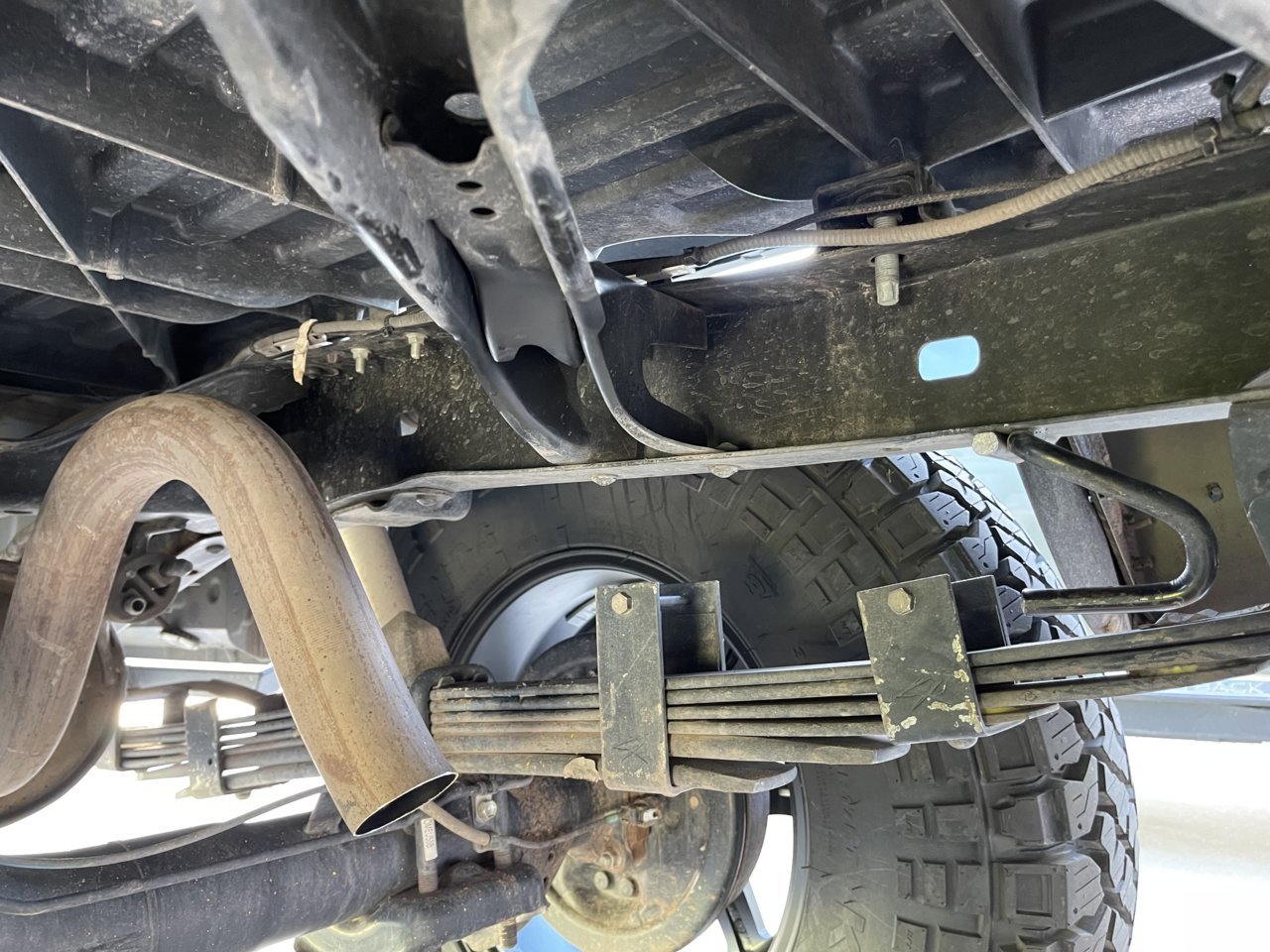

    Any photos of how you chopped the hanger off the frame?

    Here is how I did mine using a sawzall and a hammer. I wish I cut the exhaust just a little lower. Tire hasn’t melted yet though so it’s fine haha

    I did the same as the above but cut off both hangers in that location.

    This is Awesome! 35s with the spare in the stock location!!

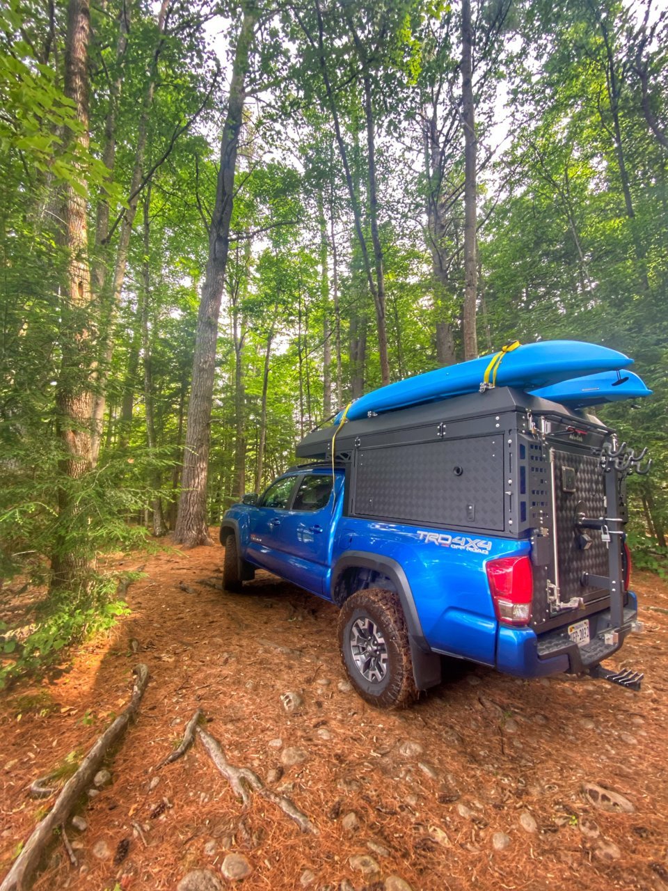

    E3954970-8BEA-4A79-9633-C447E6750BC2.jpg Got a little mud on the new Duratracs. 265/75R16

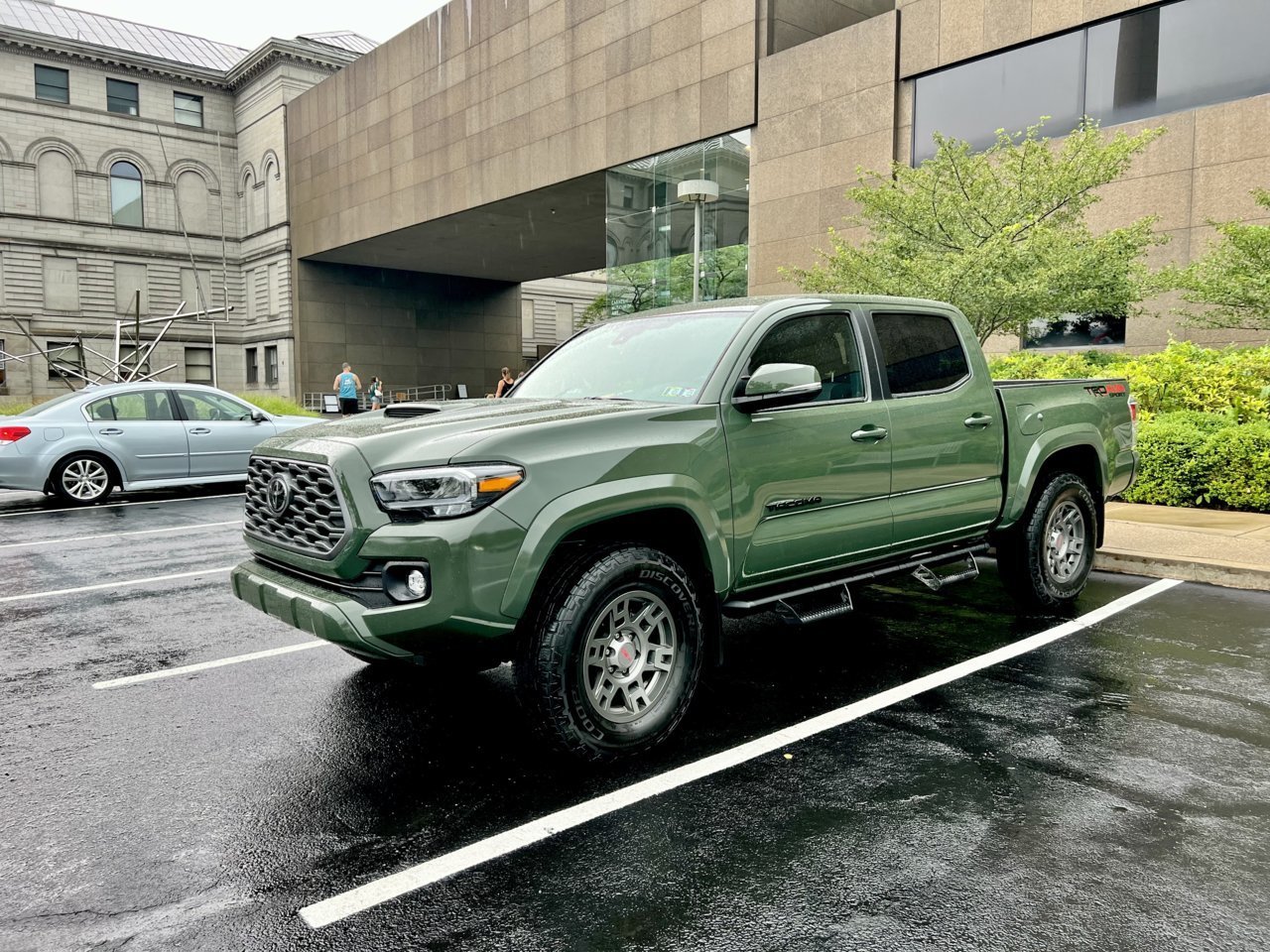

    Thank you for your patience. Please see attached.
