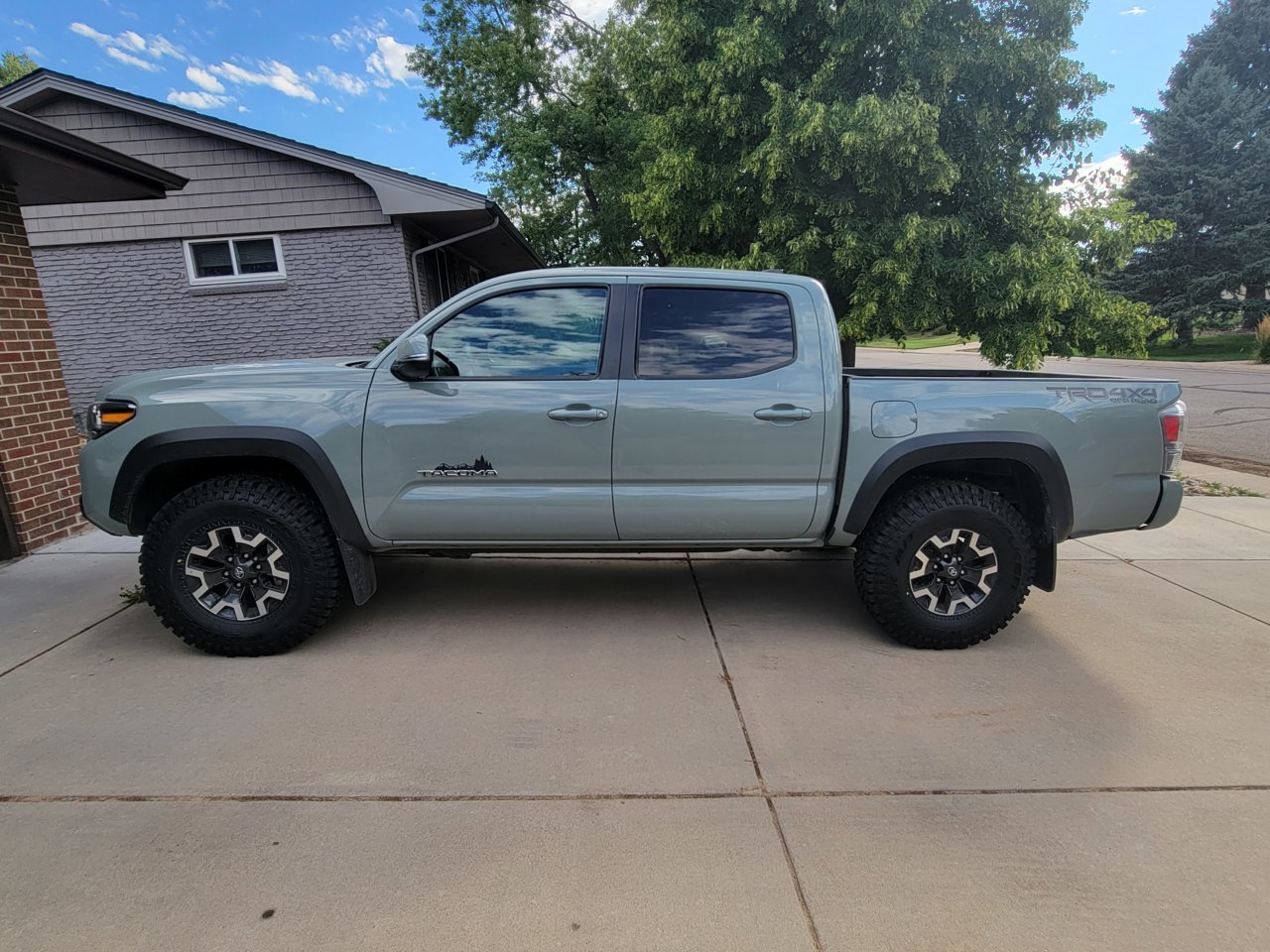

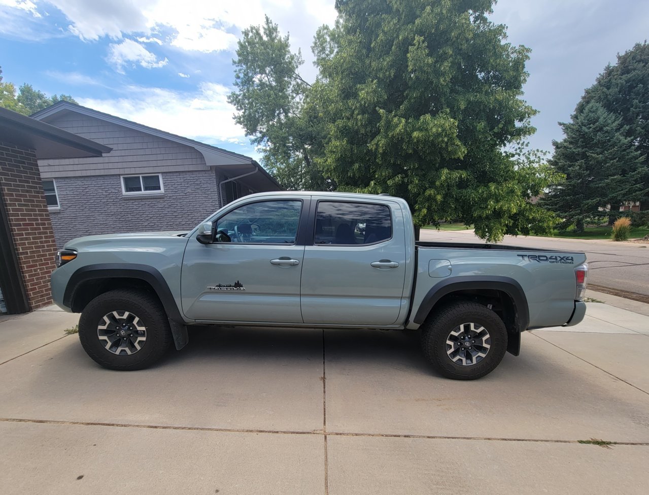

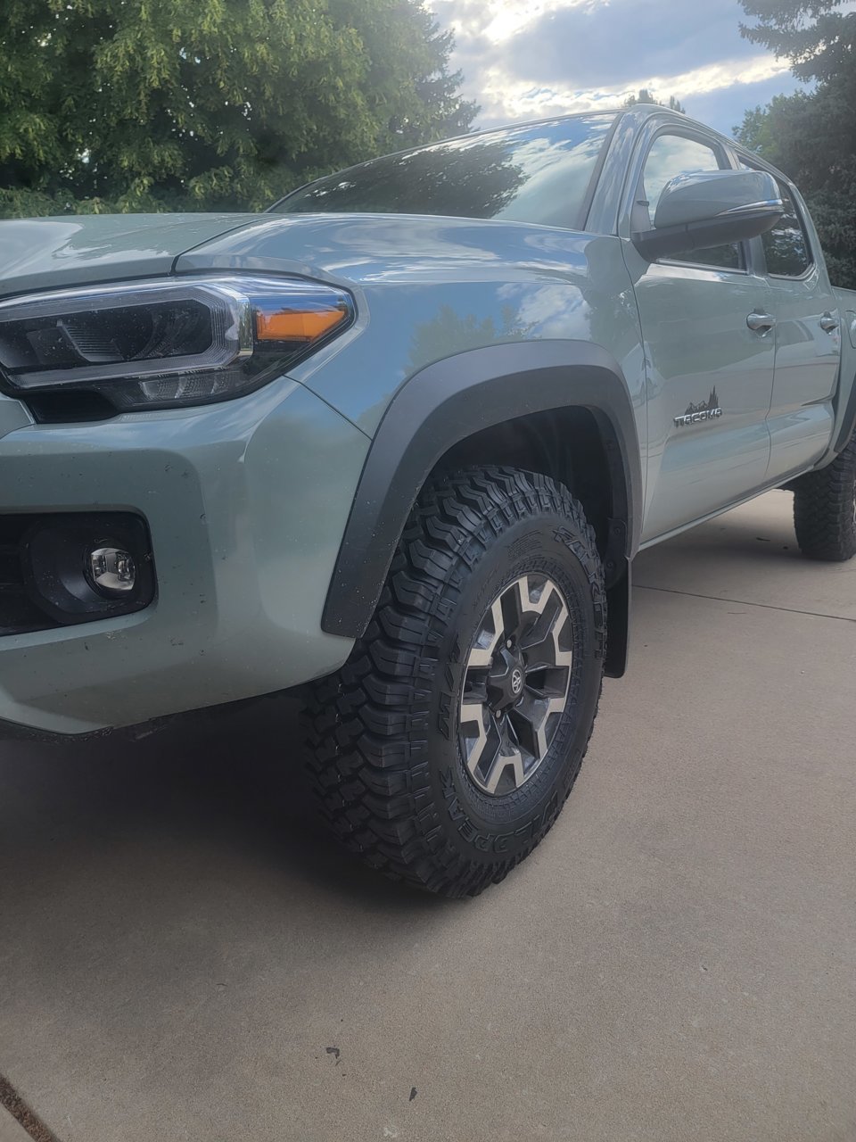

    Just put on some Falken Wildpeak M/T's. 255/85 r16. I'll have to remove the front flaps but was going to anyway. TRD OR, bone stock.

    That looks Saweet! Is the stock steel wheels the same offset as those alloy wheels? I would guess what you have is stock wheels if I had to guess the stock wheels alloy or steel would be the same offset. I didn’t say I assume! I just don’t know and fishing for answers before I start moving 4 sets of tires and wheels around to make it come together

    Thank man, I think so but don't hold me to that. As others have said, it's a tight fit so I'm looking forward to flexing a little on the trail. So far I've been shocked by the lack of hum with the Falkens. Naturally they'll get louder with wear but my 265/75 General X3's from my last Tacoma were wayyyy louder.

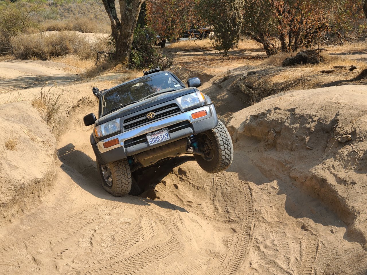

    You know, you tagged me earlier and I forgot to get back to you!
    I'm going to give you 2 answers, but the first is really the one I suggest for you.

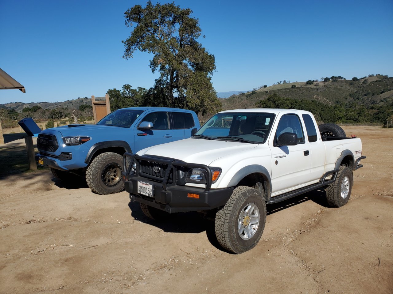

    I ran 235/85/16's on my Tacoma, and like you, it was also a Prerunner.
    I drove it everyday, way more than the other 2 cars I had at the time, and I thoroughly enjoyed it even though they were E-rated. In fact, I would only go E-rated if I ever got an A/T or M/T because...why not? Those that complain about how "stiff" they are need to learn how to perform a chalk test and set their tire pressure accordingly.
    I drove that Tacoma everywhere, and even wheeled plenty with it too! I dare say I had taken that turd through the mud plenty of times, just had to make sure I didn't let off the throttle so I didn't sink.
    I had a great experience with Falken Wildpeak 3 season A/T's. They're cheap (in my opinion), balanced well, and wore in pretty damn nicely even though I wasn't always rotating them as often as I should've. I never had rubbing issues but I also did run factory offset wheels first with Tacoma wheels and later 4Runner wheels. And paired with the 4.10 gears I had? I think it was a combination meant to be.

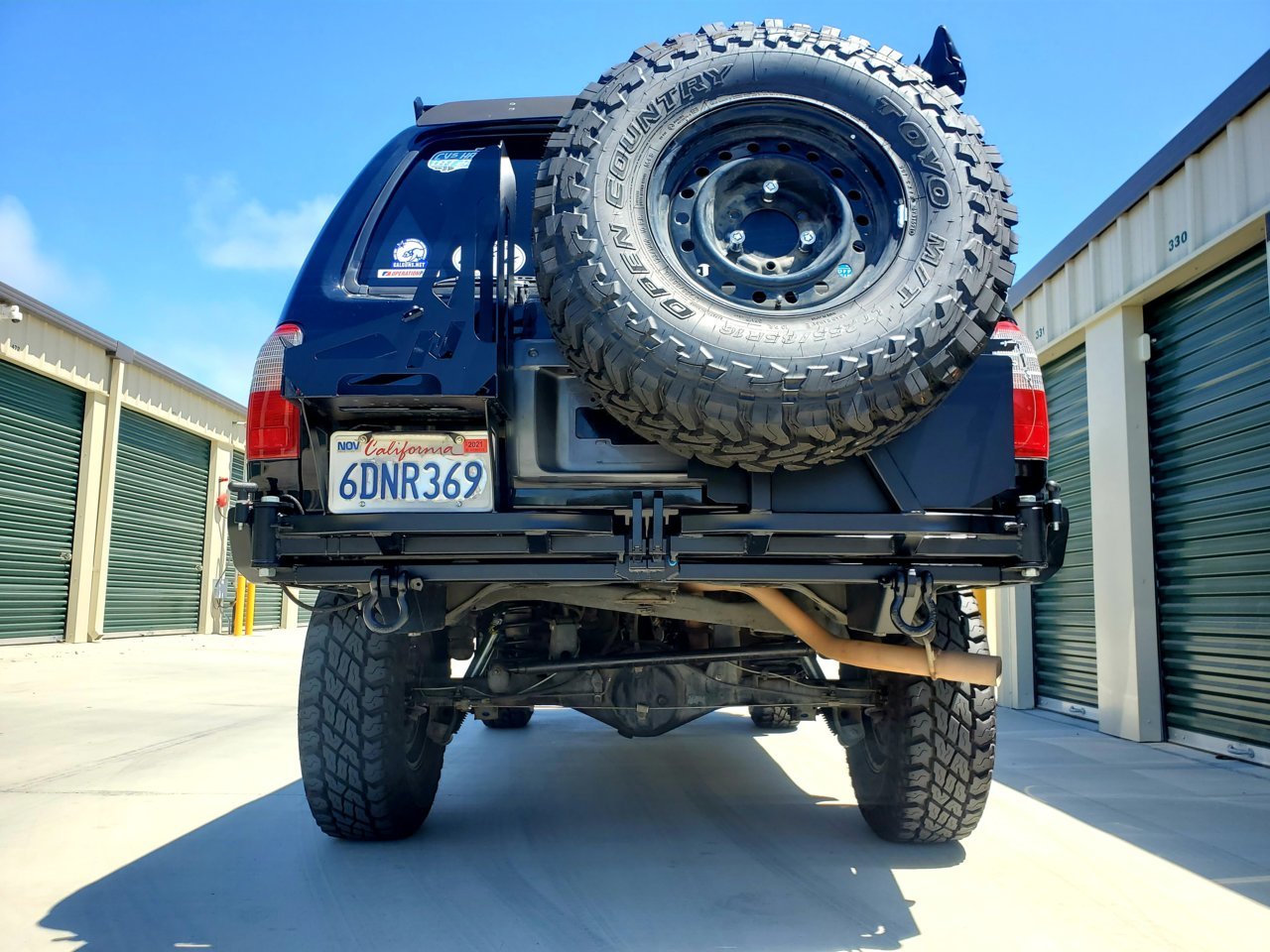

    Now my other suggestion would be to run 255/85/16s. I ran them on my 4Runner and god damn, they made it look good!
    Unfortunately, running those tires on a Tacoma isn't as quick and easy as it is on the 4Runner. Even though the suspension is 99% identical up front, the wheels sit a tad more forward on the 4R than they do on a Tacoma.
    Easy fix for you guys though as you just have to take care of the pinch weld.
    I also didn't notice a change in "sound" really, even though there was more contact on the road, but that could be attributed to the tires I ran. I had Cooper ST Maxx.
    Like the Tacoma, I drove the 4Runner everywhere...but being 4x4 I pushed that thing a lot further and drove it in snow, mud, sand, dirt, rock, you name it. My only gripe is they were a good deal heavier than the skinnier 32's...only an issue if you have a really bad back like I do. But now that I think about it, they really weren't all that heavy to begin with. Maybe I'm just confusing them for the now 285/70/17 that I run on the Land Cruiser.
    The 4Runner did have 4.30's if that accounts for anything, but I doubt it did much to help the slightly larger tires over 4.10's and 32's.
    Anyway in short, if you're ok with doing the pinch weld mod, and lugging around a heavier tire as well as paying a bit more, then just go for the 33's. It'll really change the look of your rig.
