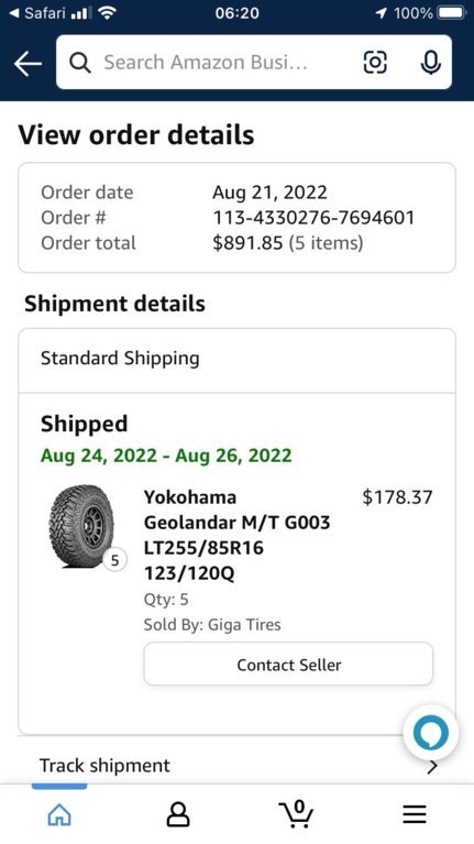

    I didn't see any promotions or anything, just happened to be tire shopping at the right time.

    Just got an email notification that Giga Tire cancelled my order and is processing my refund.
    Oh well it was worth a shot.

    Could take a screenshot of the price and see if discount tire will match it

    It looks like this may have been an error on Gigatires part as the listing no longer exists, however the tires are still available. We would not be able to offer a price match to this. With this said there are currently less than 5 sets of these tires left in the country so if someone is considering the Yokohama G003 option in the 255/85R16 size, you may want to consider purchasing soon.
