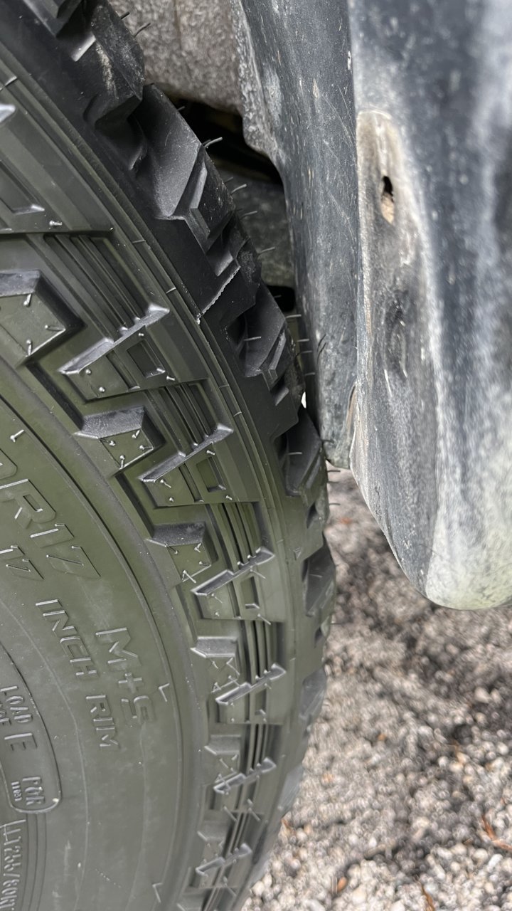

    Found one place I’m rubbing in the front that isn’t too bad, and I suspect I will rub the rear when flexing. I’m going to look into an axle relocation after I get back from a wheeling trip to check it out. It’s clearly closer to the back of the rear fender than the front.

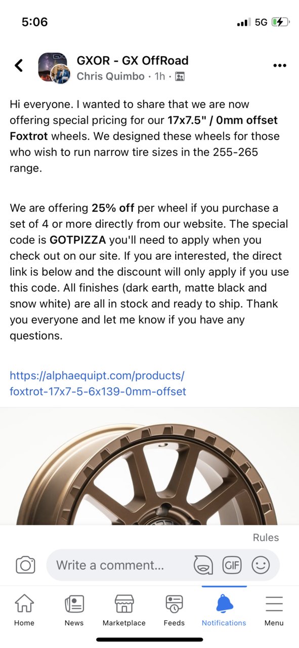

    Heads up for anyone in here, I saw this sale posted in a Lexus group for narrow wheels for pizza cutters. They have white, black, and bronze

    Interesting. I really wish more companies offered wheels that weren't massively wide. Unfortunately, I find these ones terribly ugly and that double valve stem setup is just a bit odd.

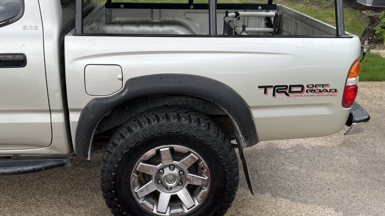

    My wheels are my OEM PRO wheels from 2019 , which are 16”. I didn’t cut my OEM bumper. I ordered the small front bumper caps from R4T and painted them to match. Your wheel offset will be different than mine on your OR. You’ll have to research and see what’ll work. I do have my lift , a CMC, pinch weld is flattened and sealed etc. If you’ll have a street queen you’ll get away with more. I off road hard, so I did a good amount of cutting etc to get rid of any rub areas and I’m fully armored front to back with 1/4” steel.
