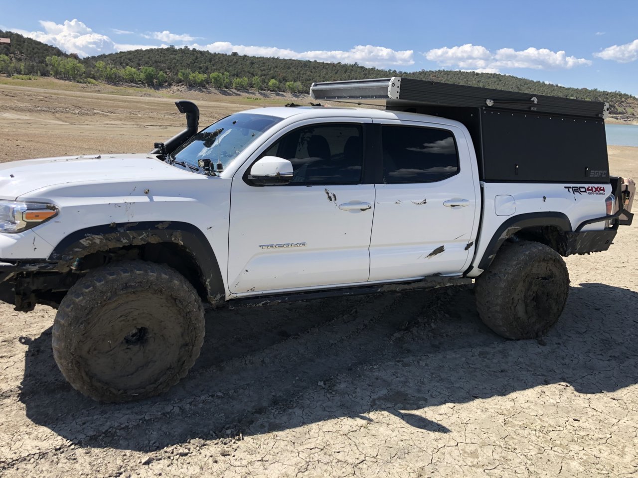

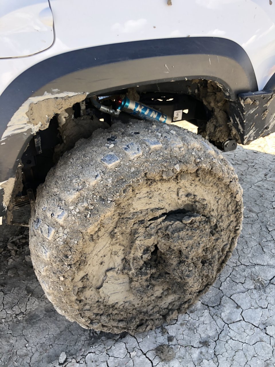

    Worst one was this summer while driving down to a lake as the water line had receded, we stayed about 20 feet from the waters edge to be safe and all of a sudden the top crust broke and the truck literally fell through into a bog which was basically the lake bed. While I do have treps, a skinny tire would not have made it out, the skinny would have just dug in further.

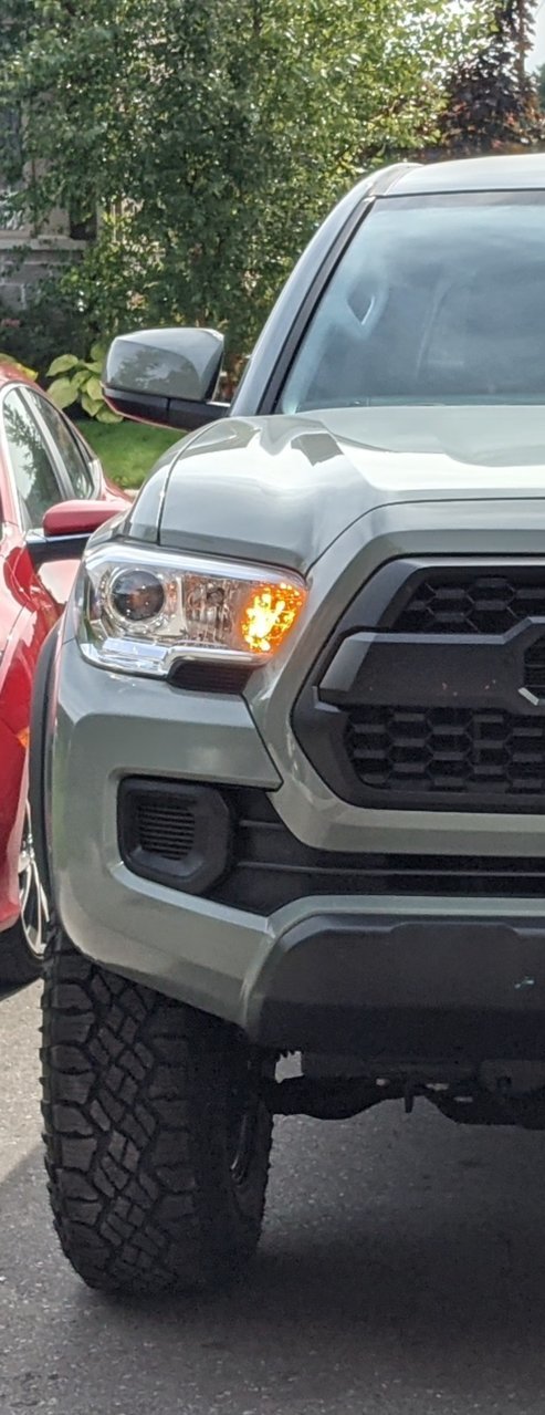

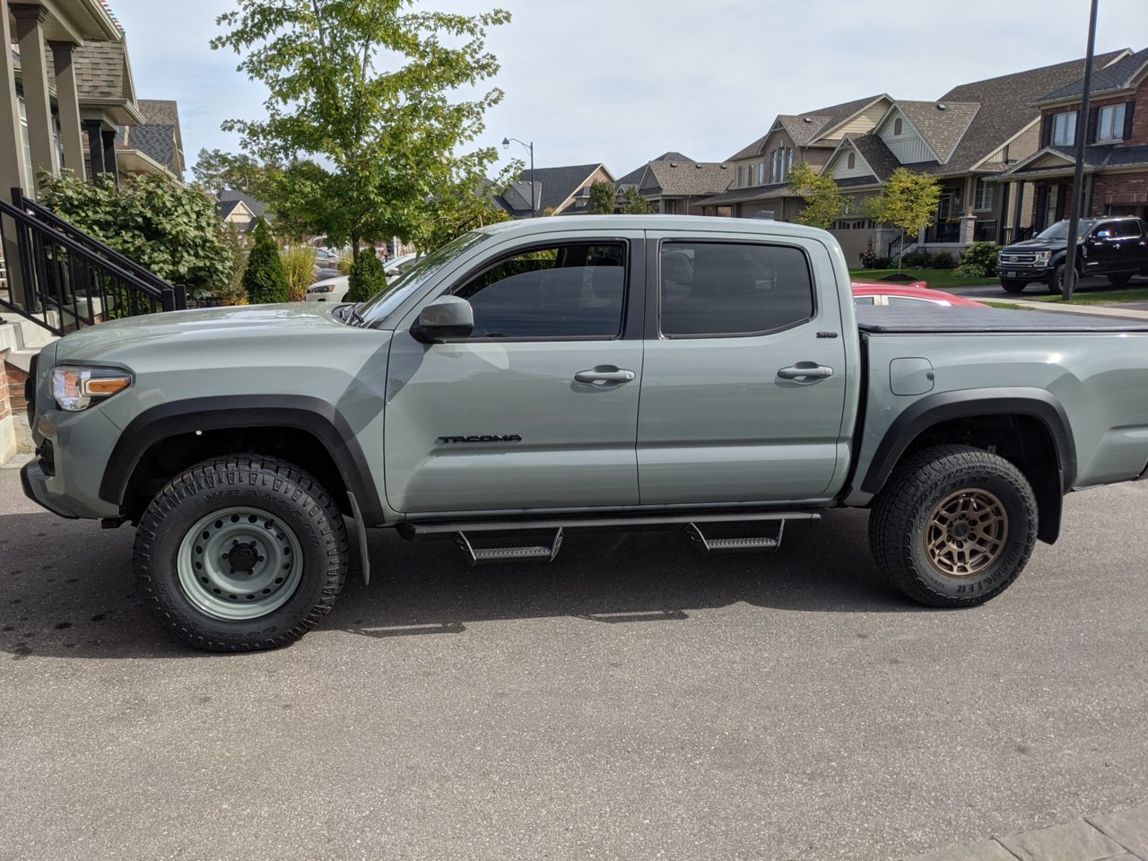

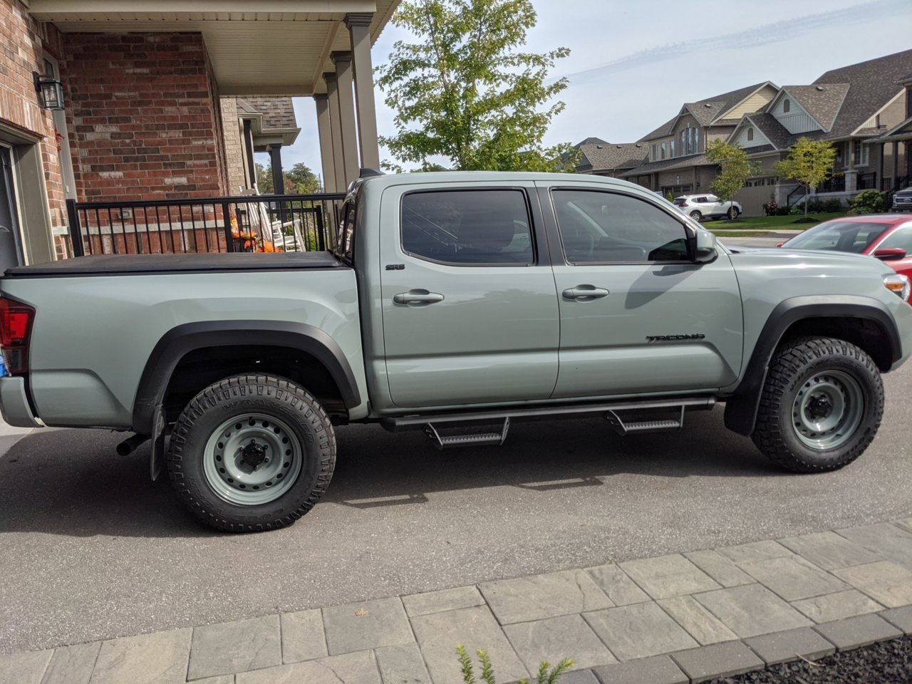

    Looks good. I may go 255/75 next time around depending on market availability. 255/80 seems to be sold out a lot. But I have plenty of life left on my tires for now.

    Speaking of anecdotes, here is the aftermath of that lake visit I mentioned. Quick sand is real lol

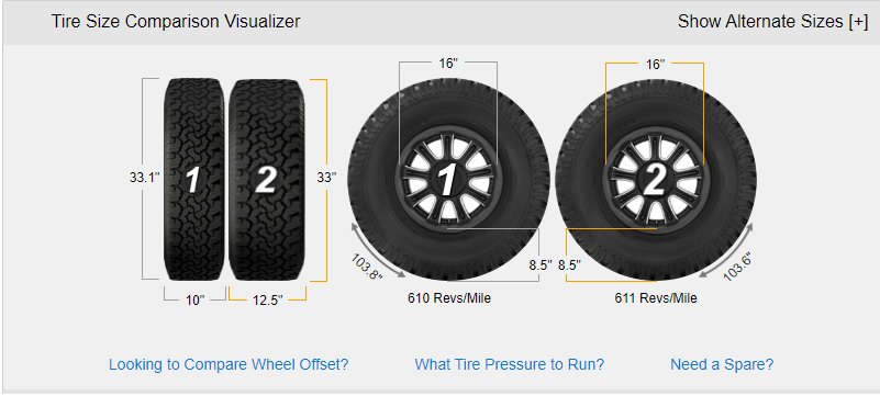

    1. Agreed - though its probably moot, I would say this has more to do with tread design and type (e.g. MT vs AT) than pure skinny vs wide. Probably not even 1mpg
    2. Disagree as discussed above
    3. Overall vehicle weight will impact acceleration and braking but the typically not associated to tire weight. That being said the average weight of the 255/85r16s in the first post average 56lbs per tire. A General Grabber ATX 285/75 R16 weighs 58 lbs. Their 33x12.5 weighs 59.8 lbs. So again the difference is negligible as we are talking a weight difference of maybe 10-20lbs max for all 4 tires. I used general because thats what I drive but point is that weight is negligble.
    4. 100% Agree
    5. This was never debated as the post is skinny vs wide NOT tall vs. short but agree. But as mentioned a skinny tire ha less contact patch than wider.
    6. See above, the argument was never about tall vs short. a 255/85r16 has same amount of sidewall as a 33x12.5r16
    As far as 1 and 3. Downsizing as in switching from a 12.5" wide tire to say a 10" wont provide much other than maybe slight mpg gain if you even see it. Will you run burn less energy running with 4 toes instead of 5?

    I think the two general tires you compared have different load ratings and different wheel sizes.

    One of my big issues with the "255 vs 285" argument is that, since tire sizing is bullshit*, it's really an argument of two theoretical tires with identical heights, loads, and tread patterns, with one being slightly narrower and lighter.
    *For example, Cooper advertises the 255/80R17 STT Maxx as being 32.8" in diameter, but I want to say that my spare measures in at something like 32.2" sitting fully inflated on the back of my truck. Maybe even less.

    Doesn't matter, not a big enough difference to invalidate the point. the 285/75 r16 is a 10ply load E tire. The 33x12.5 is load C but I used it as a reference because they dont make a 33x12.5 in E. However if I use there metric 305/70r16 10 ply load E its still only 60.1 lbs.
    255/85r16 average - 56
    285/75r16 - 58
    305/70r16 - 60
    I mean its 4 lbs difference per tire :rofl:
