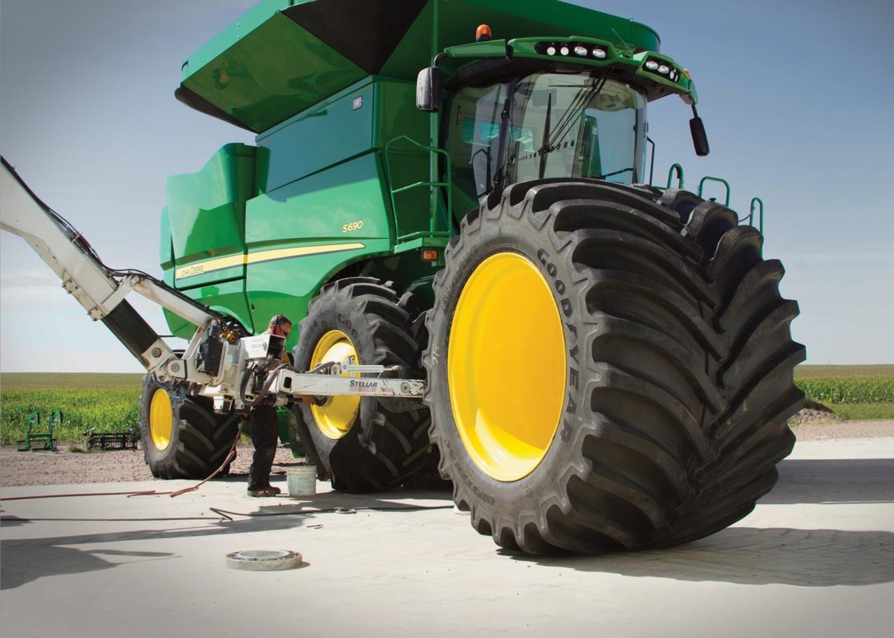

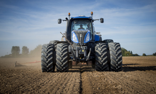

    Ya old tractors that spend more time in a shed than farming. Dude thats why so many tractors are always stuck in the mud have you ever actually worked a farm or been to a mine? Thats why they run dual wheels.....
    Check out this article of the benefits and why farmers switch to fat tires :rofl:
    https://www.ntstiresupply.com/ptk-shared/lsw-singles-are-they-better-than-duals
    What weight would you consider super heavy?
    40s usually come in a 13.5 and 42+ come in 14.5. Most tires maintain about 1:3 width to diameter ratio. Class 10s run a 35x10.5 tire, they also only weigh 2000lbs, basically a SXS at that point.

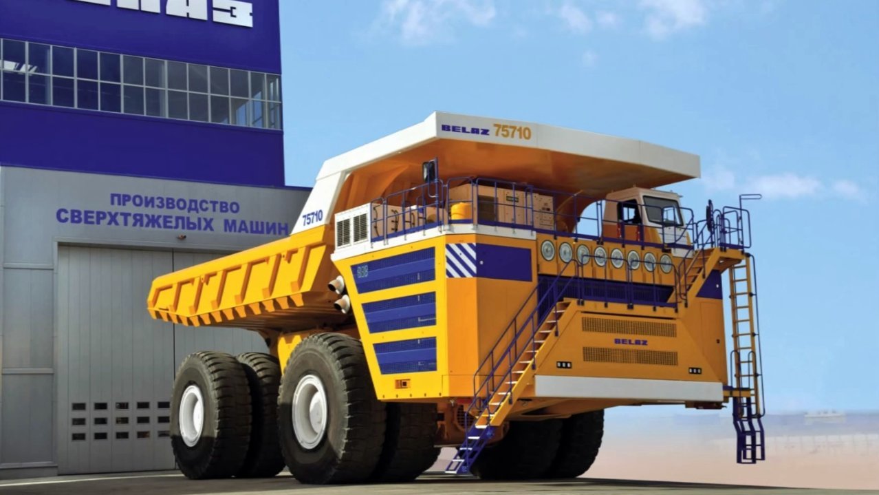

    Pictures of real examples aren't an opinion. The article isnt my opinion. :frusty:

    @JoeCOVA the tractors you posted, and most tractors are designed for specific purposes. Tall skinny tires are incredibly useful in a farm, as are the super wide LGP tires you posted. It’s all about what you are trying to do. Most “do it all” tractors are on the skinnier side of things because on a farm that’s more appropriate for the majority of the time, pending your crops. As for mining vehicles, sure the tires are wide, but they are also 6+ feet tall, so I would guess (I’ve never measured) that they would be considered “skinny” based on the aspect ratio. The duallys are generally for tire punctures, and maintaining the stability of the machine carrying such a heavy load.
    And before you ask, I grew up on a farm and currently work with heavy construction vehicles and mining equipment.
    edit: it’s all about what you use a tire for, each individual here has made that determination for themselves. This may not be the hardcore crawler thread, but we all came to the decision based on reading all kinds of threads and the type of roads we drive/look we want to achieve.

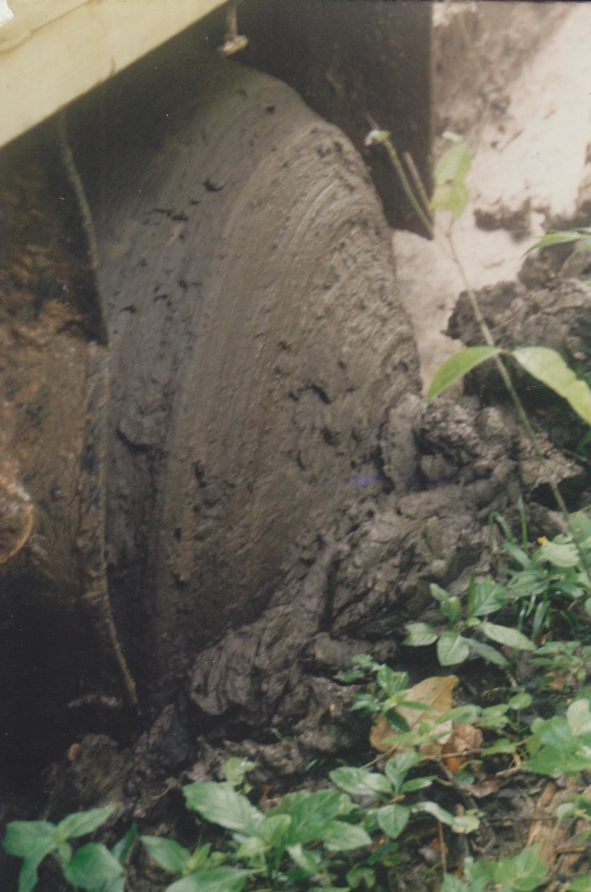

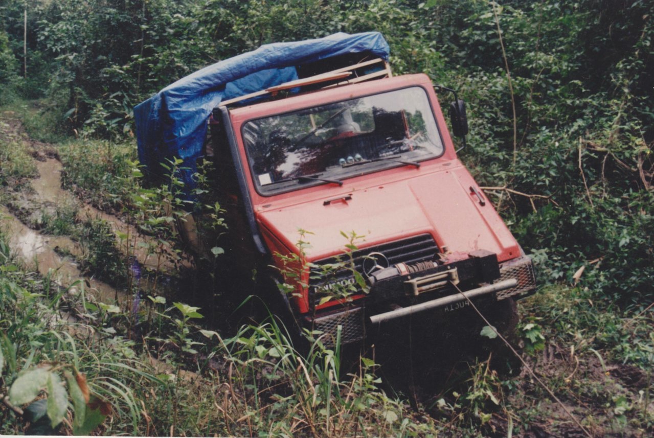

    High level physics?
    There are definite applications for low ground pressure applications. Farming being one of them as compaction is a huge detriment to seed germination. There is also a trend, regulatory, toward low ground pressure vehicles in forestry. Hence the growth market in Forwarders. In mining, low ground pressure also has advantages in stacking materials.
    Jungle mud and fat tires.

    I would also, for arguments sake, say that the massive tire you posted above is a “low profile” tire and those are known to be garbage off road. So again, there is a time and place for every tire

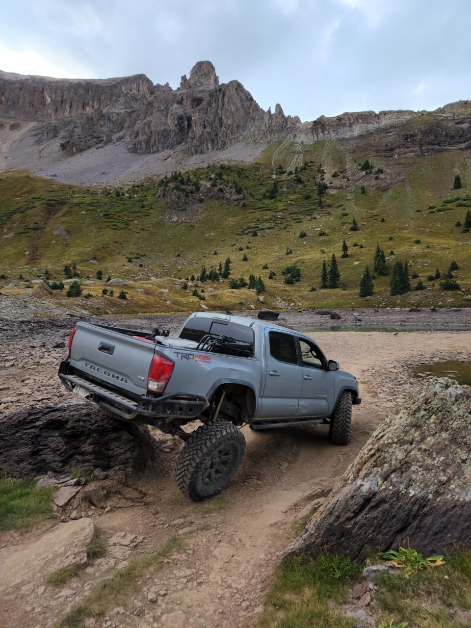

    Let's see some people putting there skinnies to work how about. Even though 37x12.5s aren't necessarily skinny

    Fucking rad!!!

    You backed right onto that rock; you should have used your backup camera to avoid it!
    /s
