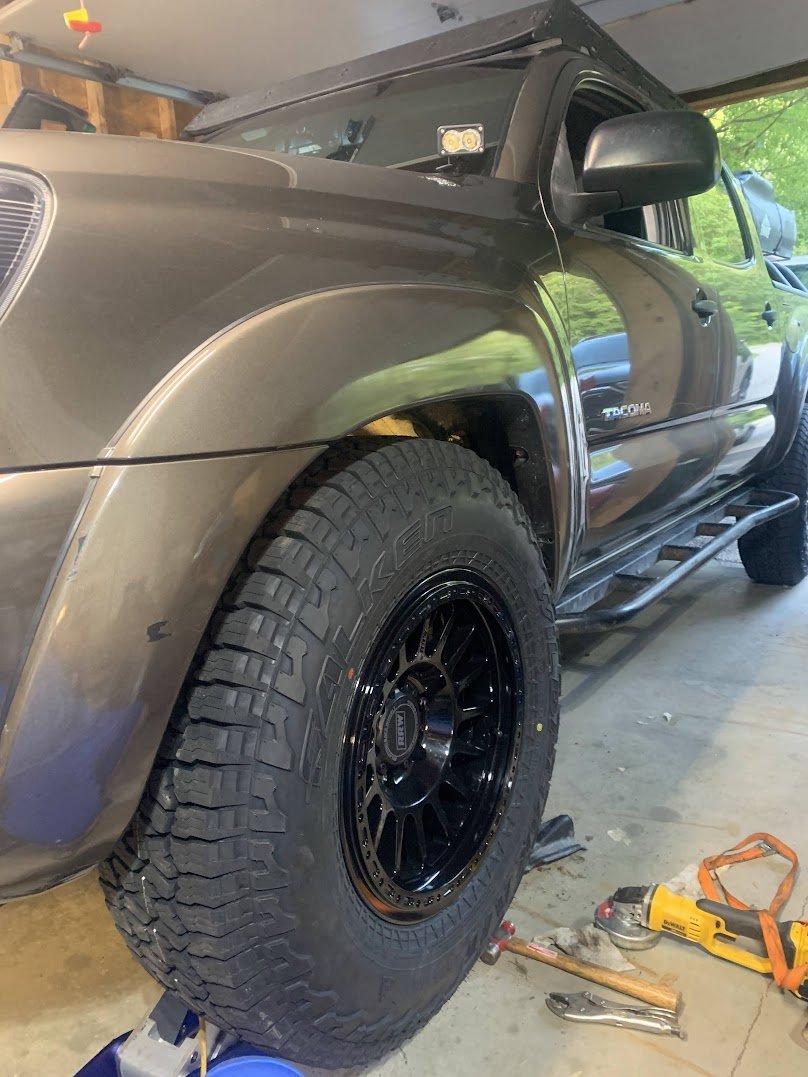

    Kings 2.5” front and rears from Accutune / ICON RXT LEAF PACK black badges doors and tailgate / method 315 / 255/85/16 Yokohama G003 / magnaflow exhaust , axle dump / meso int delete kit / meso led map lights / dome lights / wheelers front super bumps / accutune Flip kit with spacer and new bumps / Cali raised fog light pods / Cali raised ditch lights / RCI FULL SKIDS / SLIDERS / RCI rear bumper / rigid backup lights / tuned on 4.88’s
    3D001937-F732-4A01-8CF5-4D8EAF9119A4.jpg Another shot 255/85/16 :cheers:
