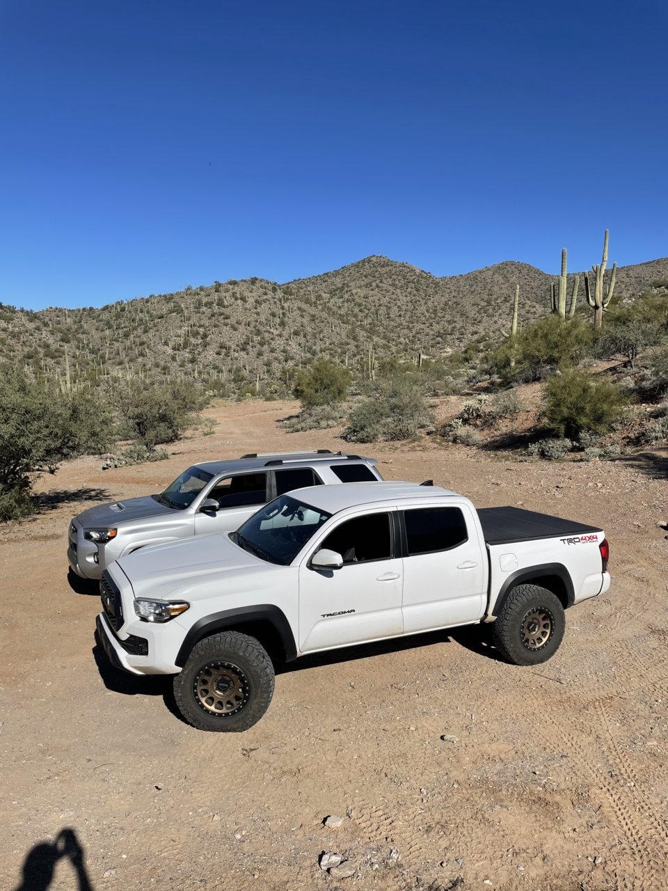

    Thanks. The skinny 33s have been great for off-roading. You should enjoy them.
    I somewhat recently bit the bullet and purchased the flush center caps from Method and I like the look of the wheels a lot more now.

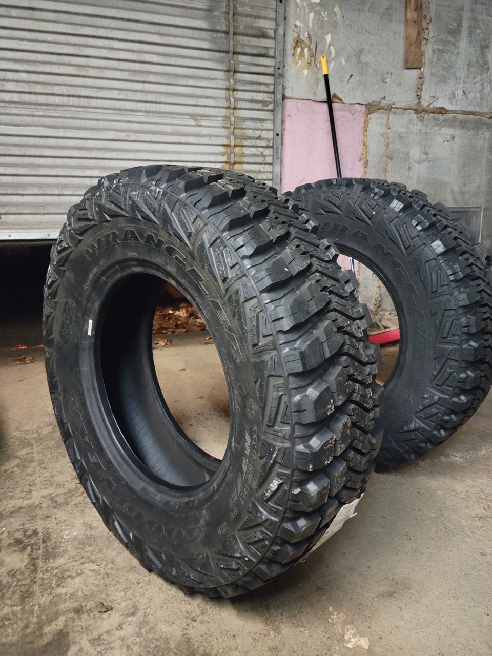

    33 10.50 17 mtr's showed up yesterday. Stoked to get them on

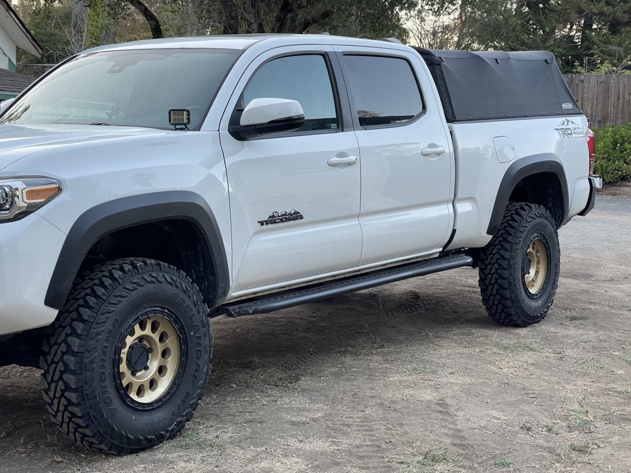

    Kings 2.5” front and rears from Accutune / ICON RXT LEAF PACK black badges doors and tailgate / method 315 / 255/85/16 Yokohama G003 / magnaflow exhaust , axle dump / meso int delete kit / meso led map lights / dome lights / wheelers front super bumps / accutune Flip kit with spacer and new bumps / Cali raised fog light pods / Cali raised ditch lights / RCI FULL SKIDS / SLIDERS / RCI rear bumper / rigid backup lights / tuned on 4.88’s
    I’m liking these a lot. Snow , rain etc. preformed great. It is a daily but have a short commute. No balancing issues at all. I will definitely get these again
