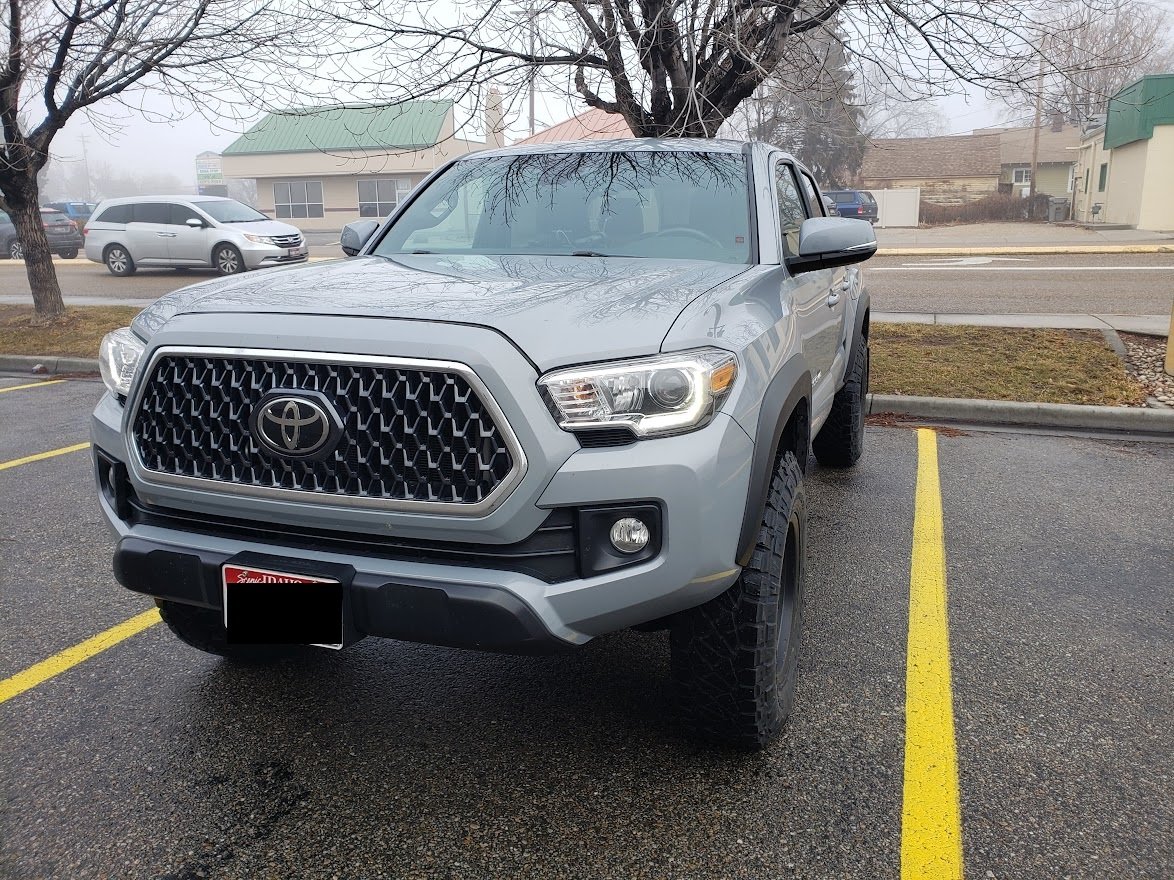

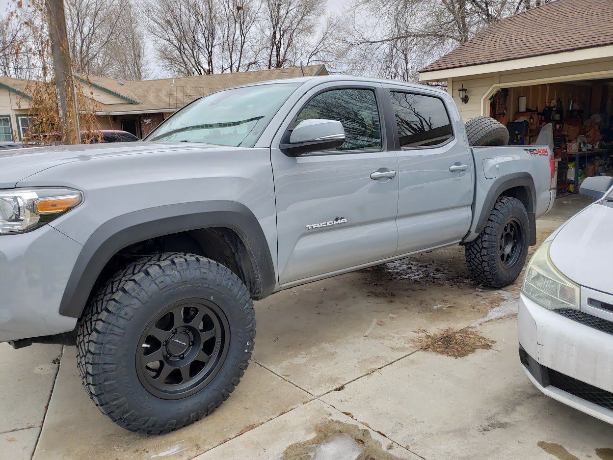

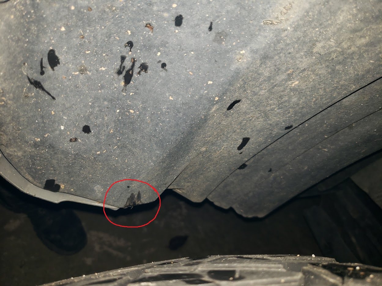

    Well, I am back to report minimal rubbing with the below setup.
    Method 701 17x8.5 | 6x5.5 | 0/4.75" LT255/80R17 (33.31" x 10.04")
    Alignment specs and ghetto pic of the skinnies that honestly don't feel all that skinny.
    The only rub I get is about 4mm patch on the front fender liner and same on the rear (closest to the firewall).
    I need to still cycle the suspension all the way to validate how much total rub there is, but I think a heat-gun will solve my problems without much trouble.

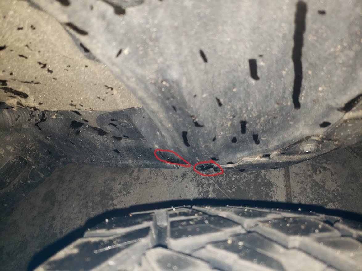

    Also for now, these are the contact patches of rubbing which seem to be pretty consistent/common for other folks too.
    Some more and some less, depending on tire width and off-set.

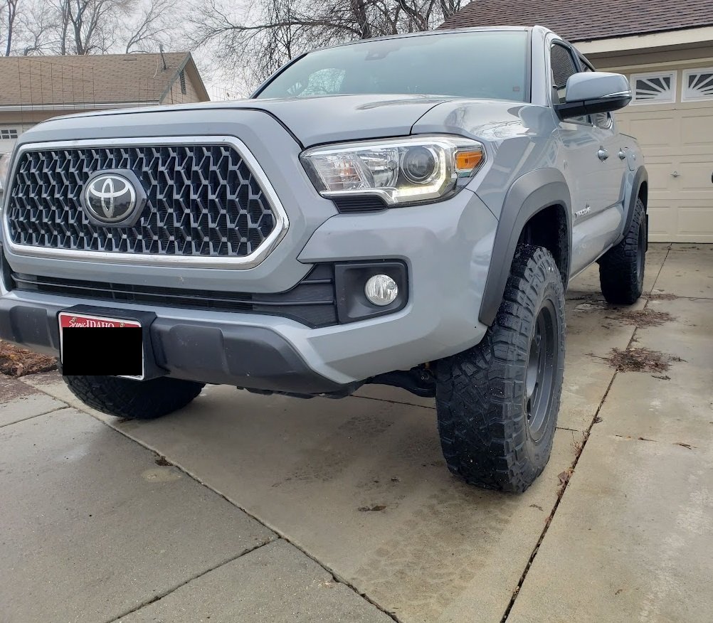

    I do have these different angles of the front if helpful though.

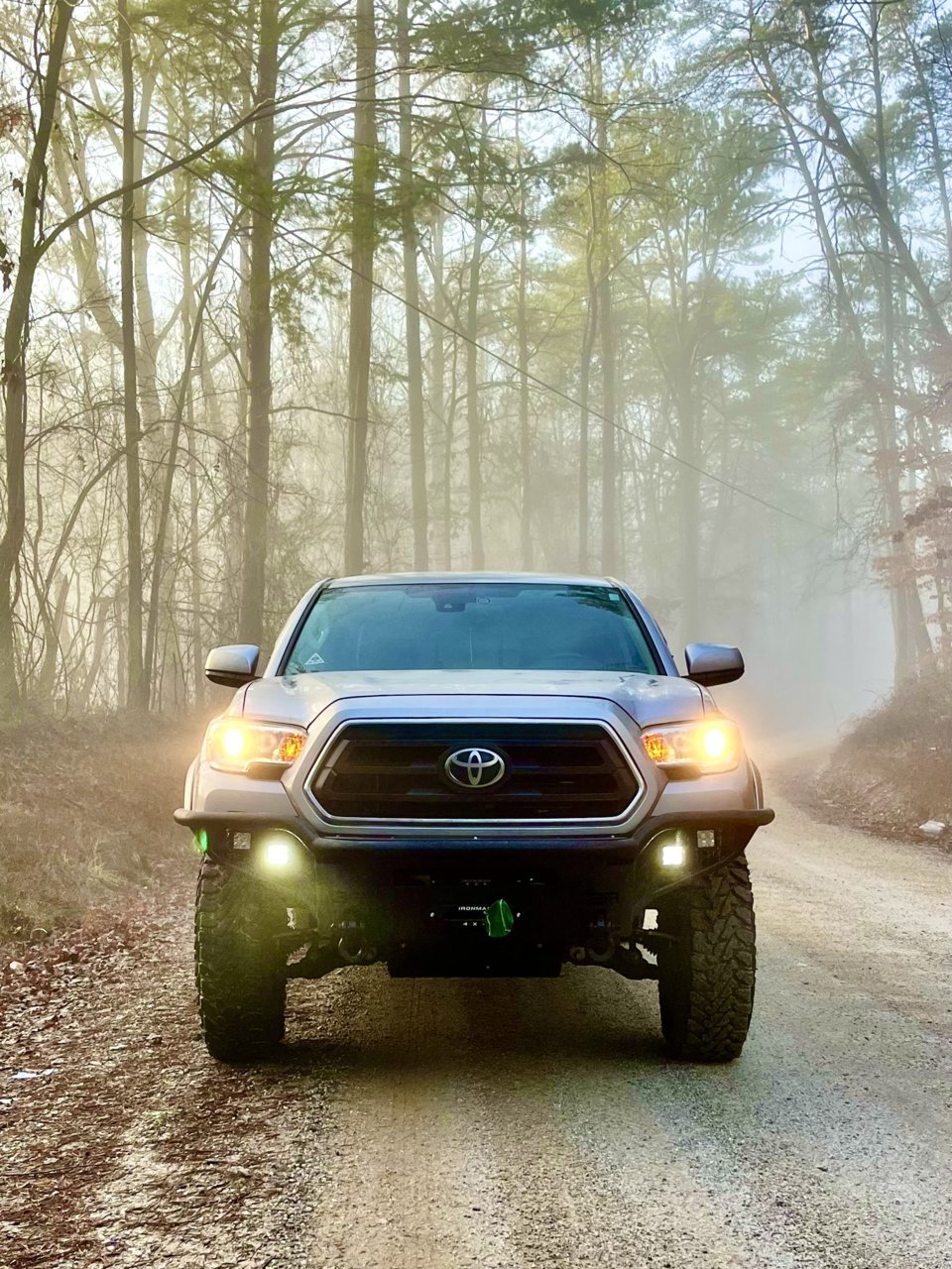

    Never did get around to posting in here when I first put em on, so here’s a front shot for those on the fence. 255/85/16 Yokohama g003s.
