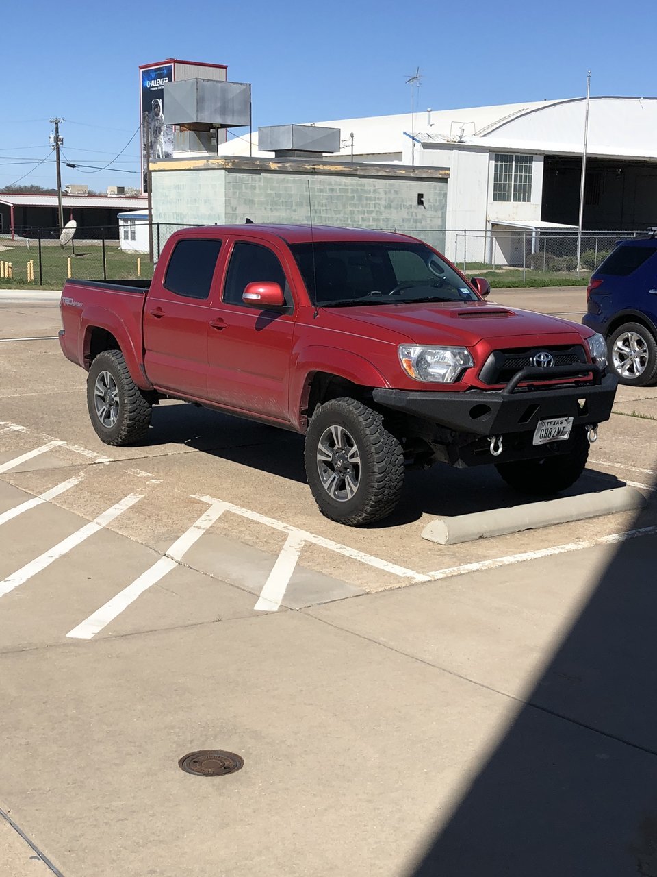

    Free to me a set of 255/75/17 bfg mt’s will go up to 255/80/17 next time in a AT.

    Can't beat that price!

    I know right they are off my Dad’s rubicon he stepped up to 35s even got the spare tire.
