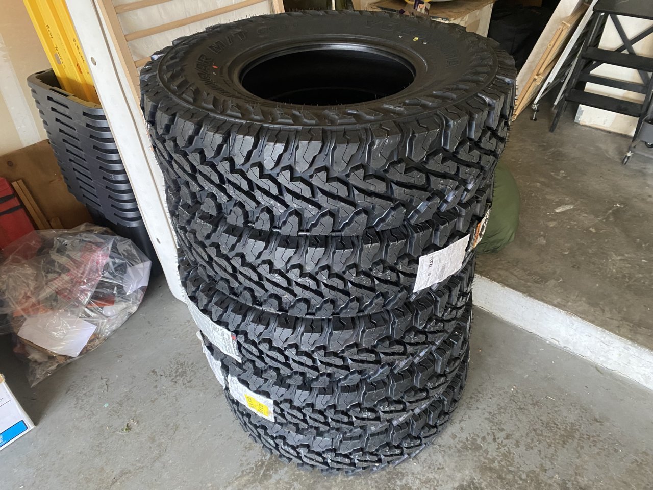

    Look what came in the mail today :D
    I went with Yokohama Geolandars in 255/85R16. Ordered through tirebuyer.com
    5 tires for $1295 before taxes and free shipping.

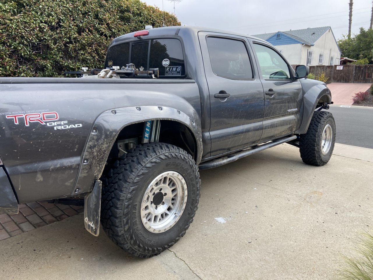

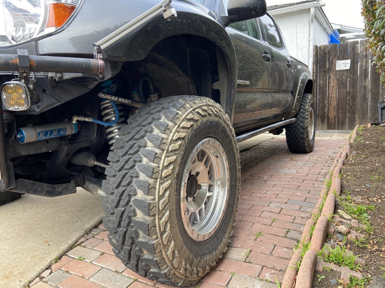

    trint99 and SalmonTaco[QUOTED] like this.

    That’s a great tire. I got them in 285 and regretted not going skinny. Good choice :thumbsup:

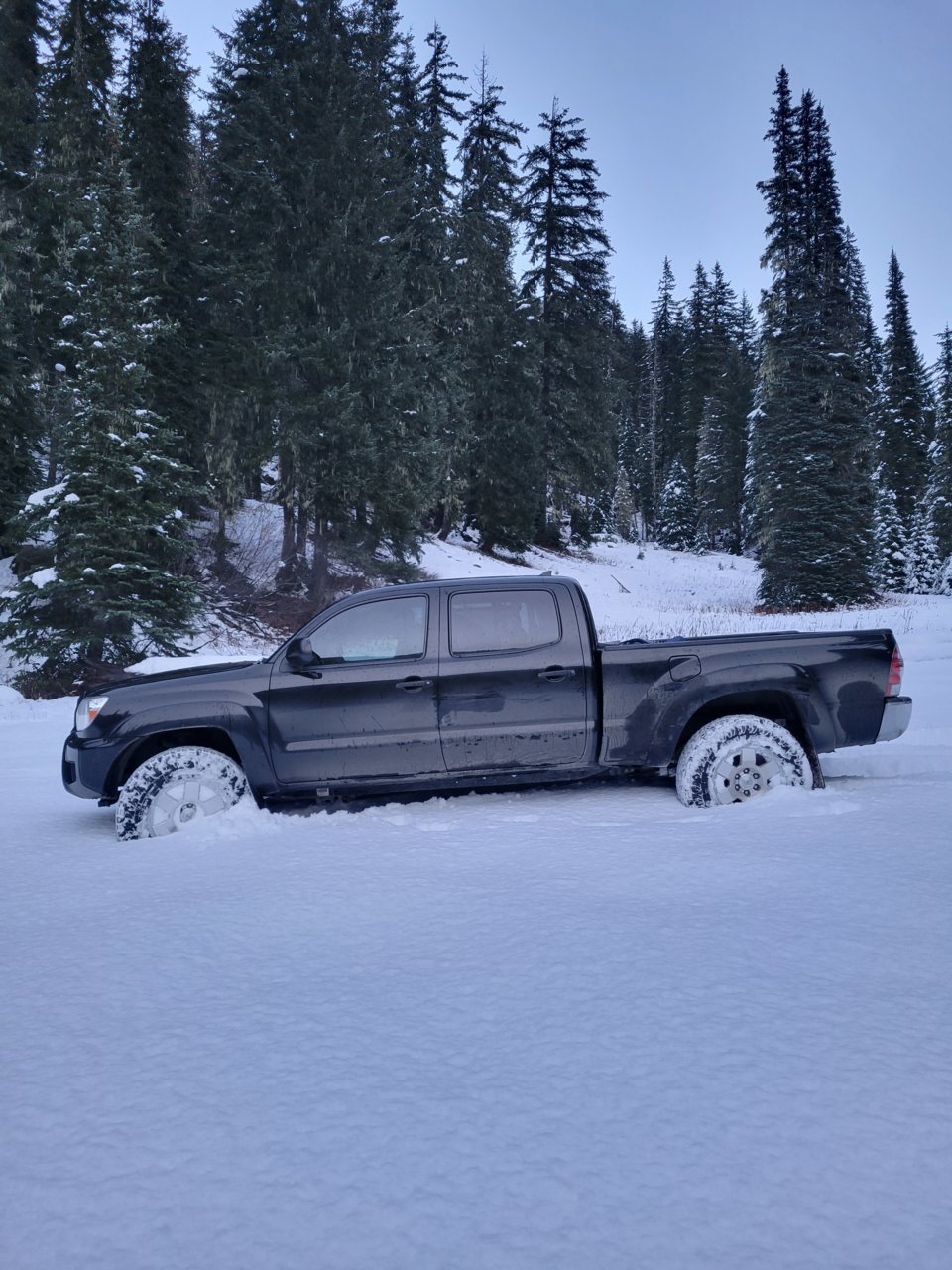

    You would be amazed at what chains could do for you in that situation.
    https://www.nosted.com/en/trygg-standard-double-duty
