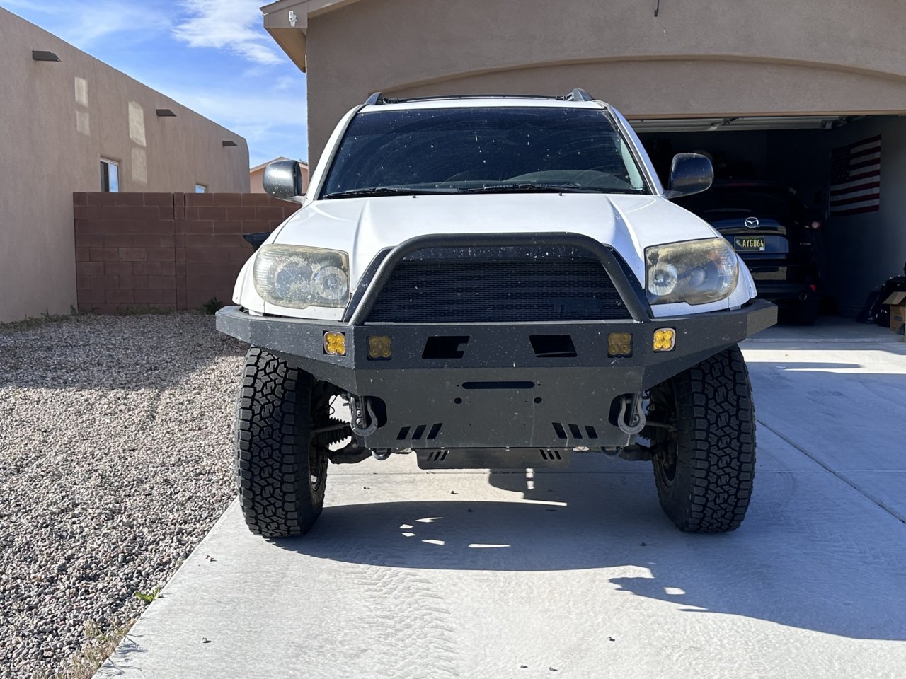

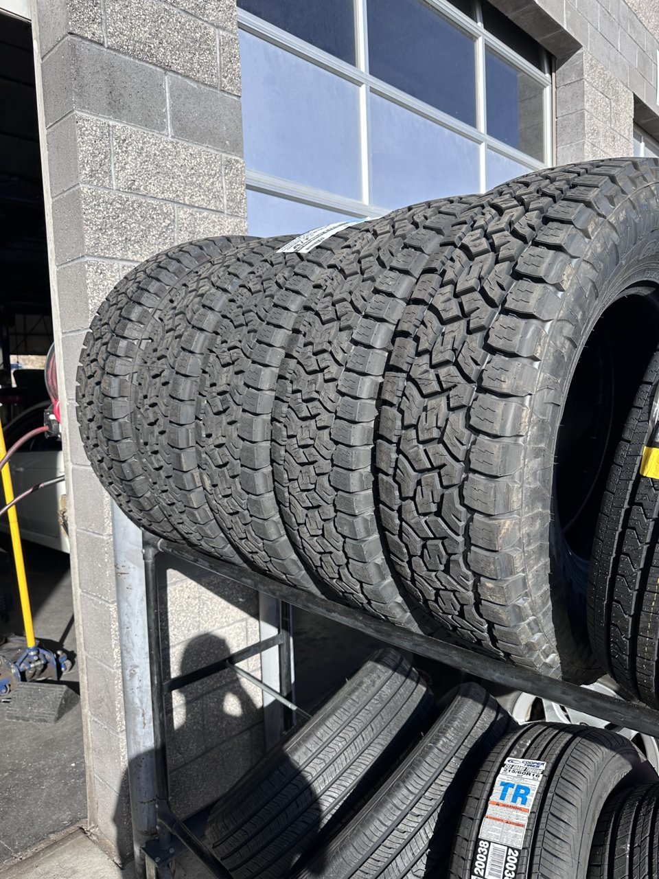

    Tire shop just called "hello sir, you know the tires you're putting on are WAY smaller than the ones you have, right?"
    Currently has 285/70 Duratracs. I was so annoyed. Just put the fucking tires on. Mind you this was 4 hours after I dropped it off. Hope they finish it by end of day as I work all day tomorrow and won't be able to pick it up.

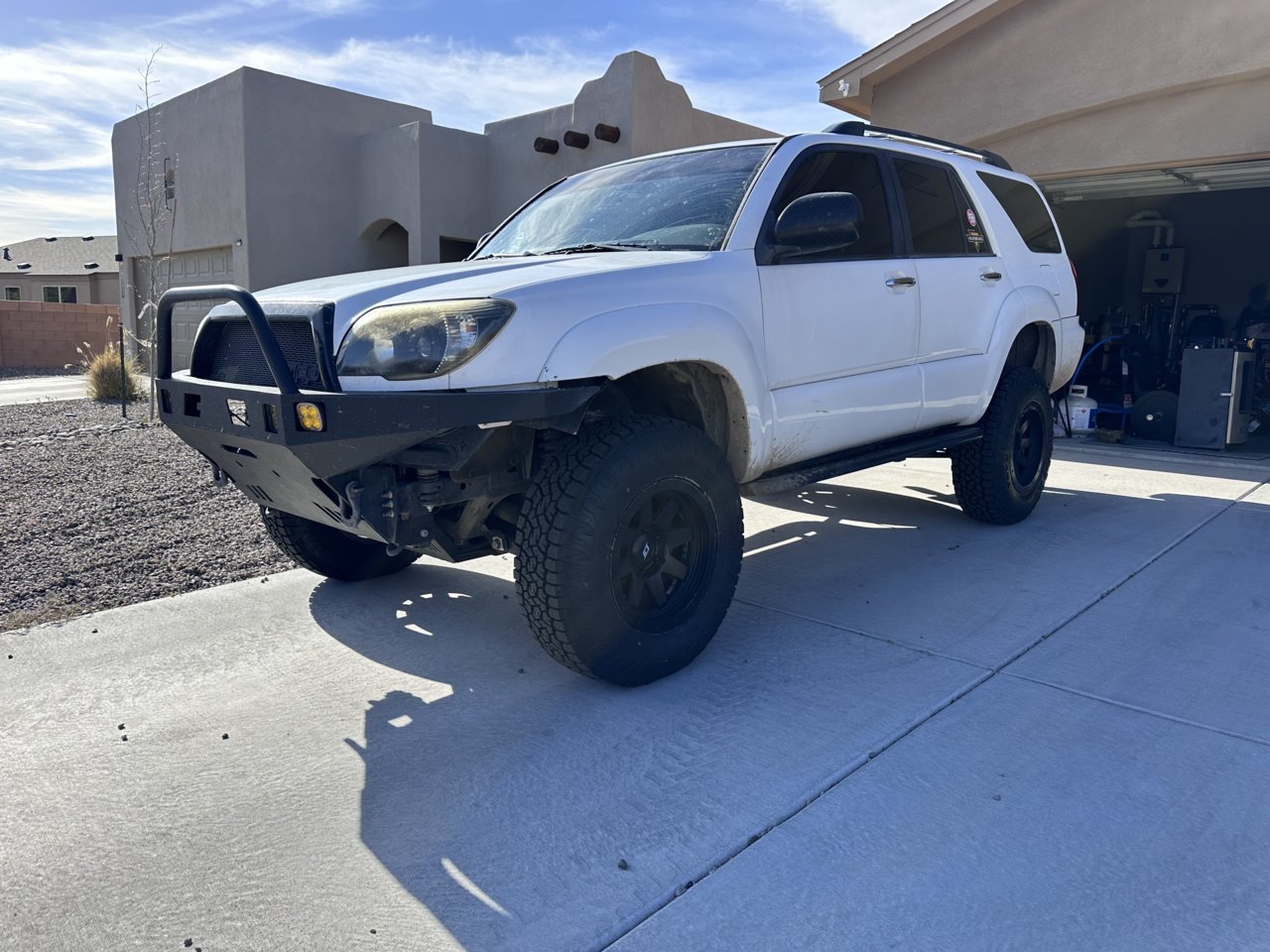

    Just on the drive home I can already tell the difference. Drives better/feels lighter. Hard to explain. Gets up to speed and doesn't seem like it's trying as hard. Will be sticking with this size.
    Also looks much better than I thought it would. I was worried they would look small but they look great!

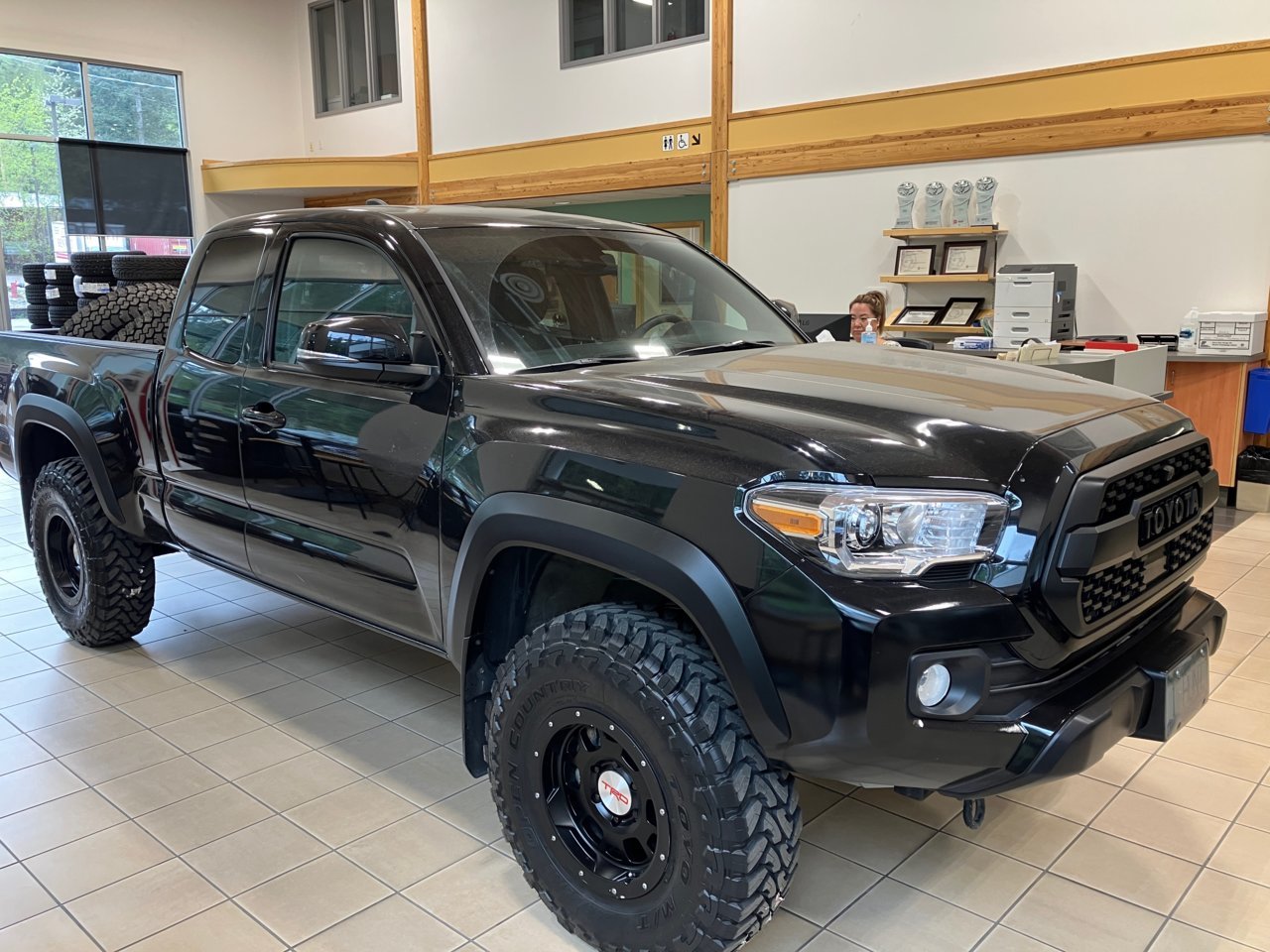

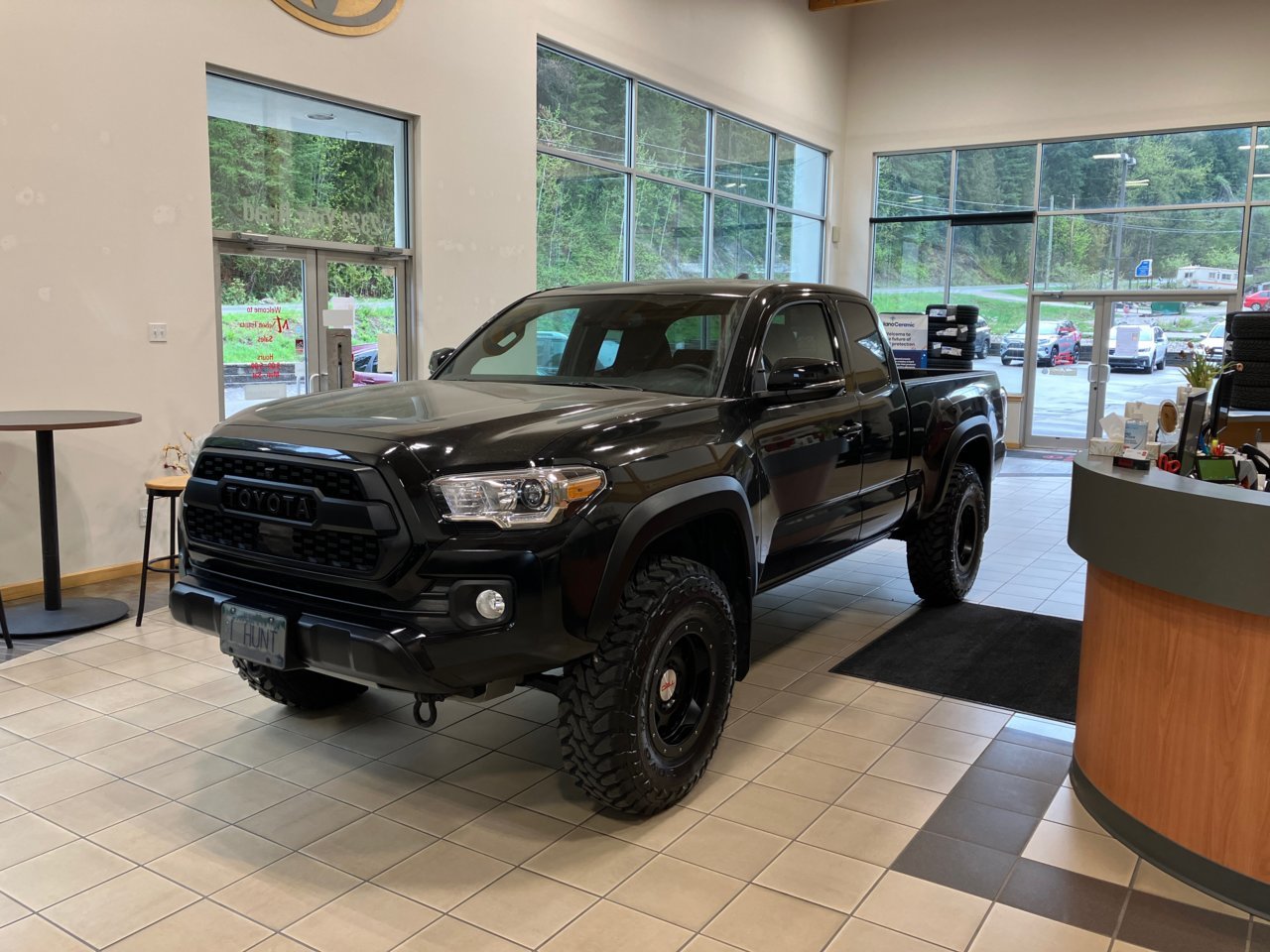

    Also posted in the "what did you do to your 3rd Gen today" thread, but thought I'd confirm here that Toyo MT 255/85/16 tires (33.5" OD) on the TRD "Beadlock" rims (16x7.5 10 mm offset) have no issues on a TRD Off-Road with the TRD lift kit (2" front/1" back). OEM mudflaps remain unviolated.
    Dealership liked how it looked too; they stored it in the showroom until I picked it up.
    No rubbing in some tight-turn parking lots and up and over some curbs. Bush test coming next weekend, but it's all looking good.
    That's the previous Toyo M-55s in 235/85/16 on some winter rims in the bed...from past experience, I know the MTs are not great on ice or compact snow. Would like to get the M-55s studded, but they have >10,000 km on them and apparently that's a bit too much wear to allow them to be studded safely.
