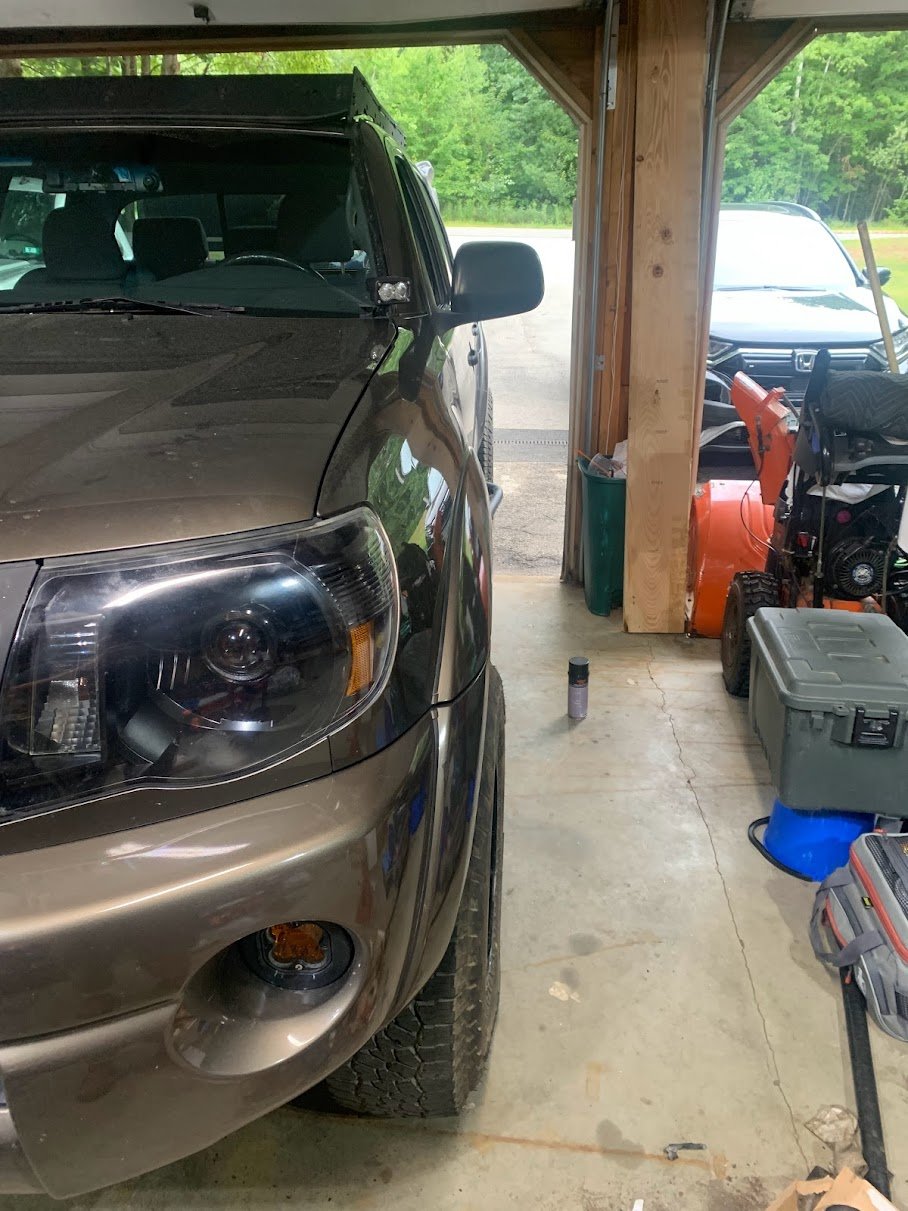

    Hard to say. I only had them on for about a month before I found a deal on the bumper, but I had no issues on the forest roads during that time. I know it looks like it’s touching at the back, but there was room to breathe between the tire and the liner. Just couldn’t get a picture to show it. Stock upper and lower control arms as well. The local alignment shop tech hasn’t even twitched whenever I take the truck in. I’ve been totally happy with them so far though. Biggest and most aggressive tire I’ve ever ran, and I have no regerts.

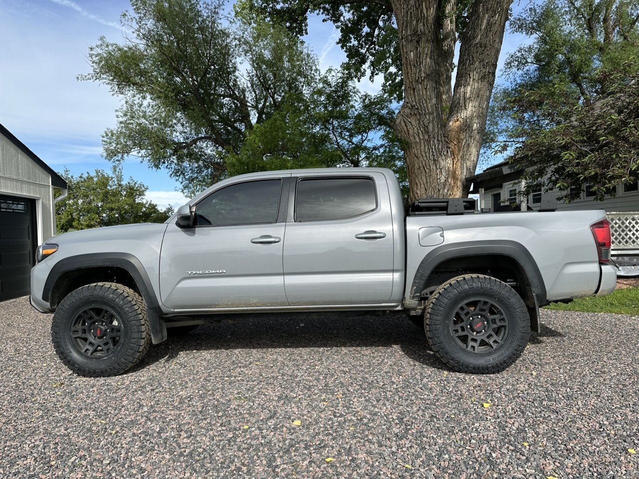

    Rubbing mostly comes from wheel offset and tire width. 255 80 17 should fit stock without rubbing but I put them on 0 offset wheels and thy rubbed a bit during compression.
    I think 0 offset provides enough poke without looking dumb. Keep in mind ride height effects your track width in the front. I am at 1"

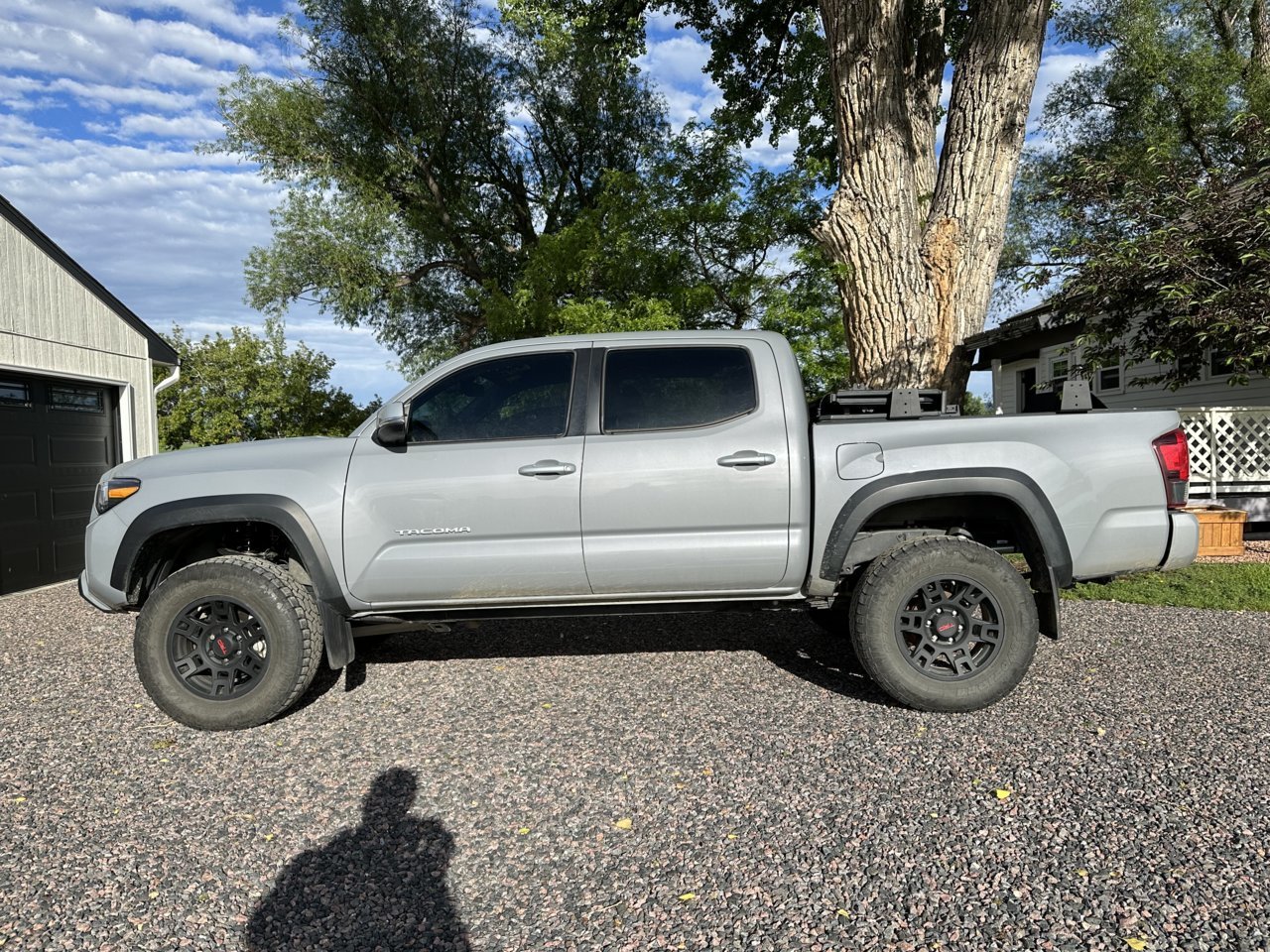

    Installed 255/80r17 Ridge Grappler's last week, really happy I went this route. Rubbed on the OEM front mud flaps on hard turns. I have an alignment scheduled for tomorrow, but am holding my breath to see if that makes a difference considering that I'm running stock UCAs. I'm running Bilstein 6112/5160 on the 9/7 perch, which gave me about 1.5" of lift in the front and 1.75" in the rear. No CMC.
    Have yet to take them off-road, but excited to hit the trails. Truck definitely feels taller.
    I've included a photo of my previous tires (265/70r17 Toyo AT3s) as well, taken from a tripod in the same location. Thanks for the thread!
    After: 255/80r17 Nitto Ridge Grappler
    Before: 265/70r17 Toyo AT3s
