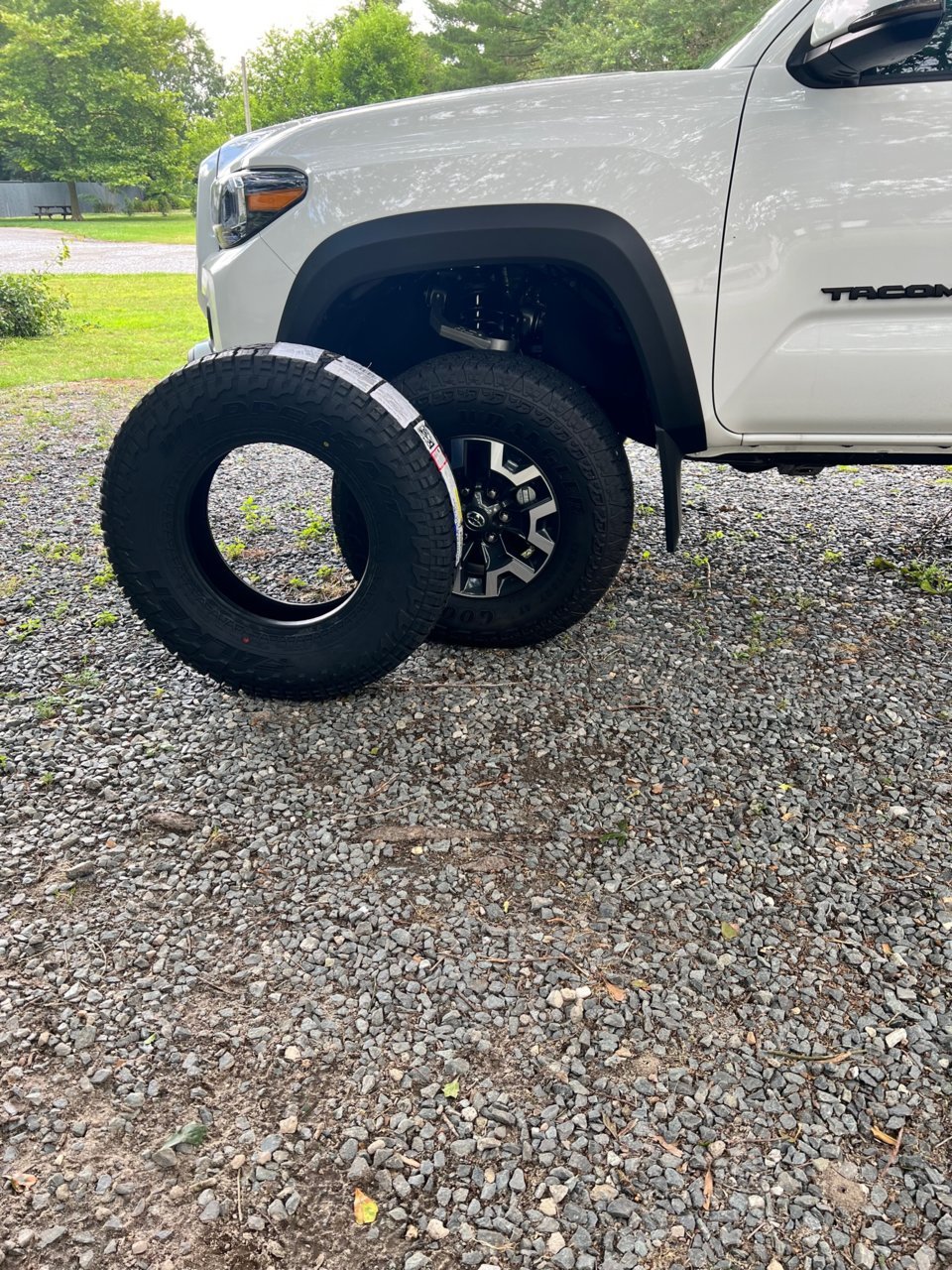

    Just got my RRW 17x8.5 -12 RR6-H's mounted with 255/80r17 Wildpeak AT3w's. @Discount Tire the entire shop crew came out and was telling me how much they liked the combo on my truck after the install which was fun!
    Sig4Taco18, RCrumb, Rezkid and 5 others like this.

    Do you have pictures of this set up yet? Was curious to see as I have the same wheels and wanted to see the "poke". Currently on 285's, but considering running skinnies.

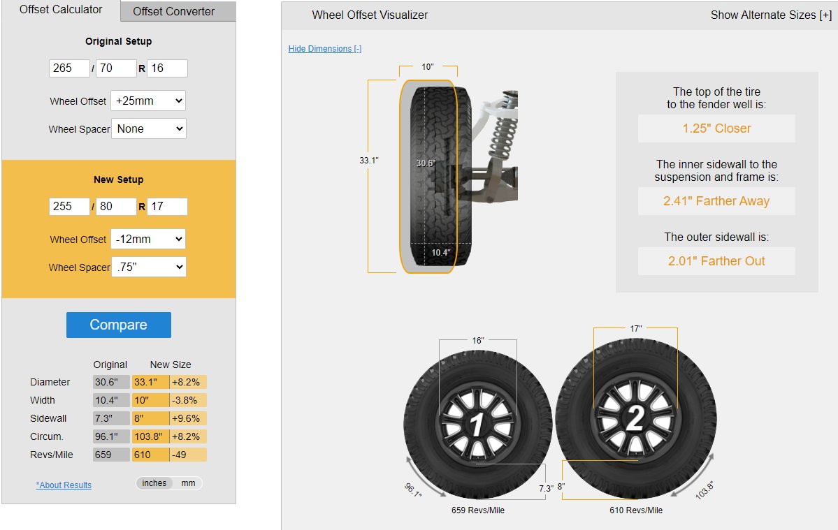

    I just mounted the same tires mentioned by @tacomasnbeers on 17x8.5 -12 wheels, and have just a bit of poke (pictured in post 5965 above). You can use tiresize.com to compare, which I've included a screenshot of below. I believe it assumes the wheel width remains constant, so I used the wheel spacer field at 0.75" to account for the wheel width going from 7" to 8.5".

    Wheel width will not really affect the poke measurement sense the offset is measured from the center of the wheel.
    If backspacing was used then it would matter.

    Sorta correct. The wheel width does have an effect on poke. Assuming the same offset a 1" wider wheel will poke out 0.5" further. But the amount of stretch the tire has between the different wheel widths also has an effect on fitment.
    The one thing I don't like about that calculator is that it uses tire width which can be misleading if your tires are significantly wider/narrower than what would be standard for that size wheel. For example, the calculator won't show you any fitment difference between a 6" wheel and 10" wheel if they are running the same size tire.

    I agree the wheel will poke more, but the tire does not. Maybe some small amount due to the changing profile of the tire as you mount it on a wider wheel.
    Those calculators arent 100% accurate, they are just meant to get in the ballpark +-0.5". Different brands can have tires with the same specs but different diameters. I believe it is the 35" bfg's measure around 33.5"

    Correct. If the tire size and offset are the same then the width shouldn't have a big difference on fit. But, if you're comparing different width wheels and corresponding width tires then the difference can be significant. Like you said, this is all just ballpark since it's theoretical calculations and the actual size of these tires varies greatly from brand to brand and model to model.
