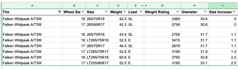

    Good call, looks like A/T3Ws come in that size as well. Not sure how I missed it when I was looking at which sizes tires actually come in. How's the contact patch/squish? Which tire are you running?
    Given the factory 265/70/R16s are ~30.5", it seems like 235/85/17s typically run around 31.7", granting only an inch of actual increase in size (but saving on width).
    Edit: holy shit the AT3Ws in 235/85/R16 are nearly 50lbs? are they full of gold bullion?

    AT3W's are kinda heavy in general. I don't have that size on my list but here's how it compares to other popular sizes of that tires:
    I ran some SL rated AT3W's for a while and really liked 'em. Although it seems the concensus is to run E rated for better puncture resistance. Kai's recent tire comparison actually has me wondering if SL/XL/C rated may actually perform better offroad due to their ability deform more easily. In his test he was getting barely any deflection until he was down in the 10psi range.
