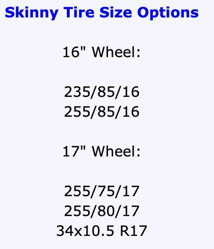

    You made me go back and check - the OP says this thread is for skinnies, mentions his 255/85/16s (33s), then also lists:
    Which are all tall skinnies.
    I think this thread is about pizza cutters, aka tall-and-skinnies. I guess we can also include skinny-but-OEM-diameter as skinnies, like the 245s the SR comes with?

    Yeah I have always understood this thread to be about pizza cutters. I read through hours and hours of it trying to decide whether to get 255/85/16’s or 265/75/16’s and the majority of the discussion seemed to be about pizza cutters.

    You are correct! My bad!

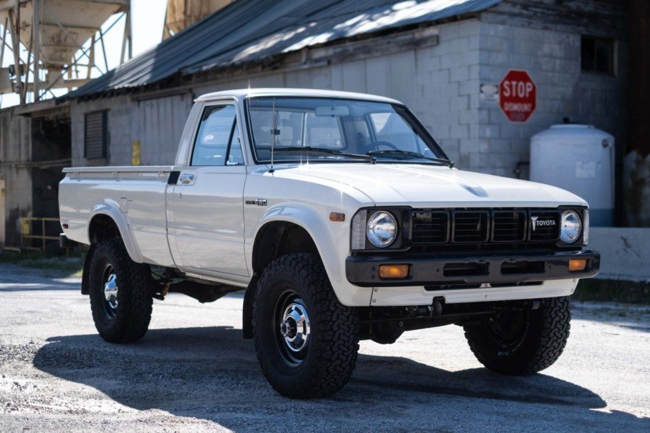

    Odd that 215/85/r16s aren't on the list; they're a real pizza cutter end up being a great skinny replacement for the 245/75/r16s that came stock on a lot of these trucks, and are usually within a 10th of an inch of the same size, and similar weight, but E load rated. .
    One of the more underappreciated sizes I think.
    The look reminds me of the first Toyota 4x4 pickups with skinny 15s and chrome hubcaps.

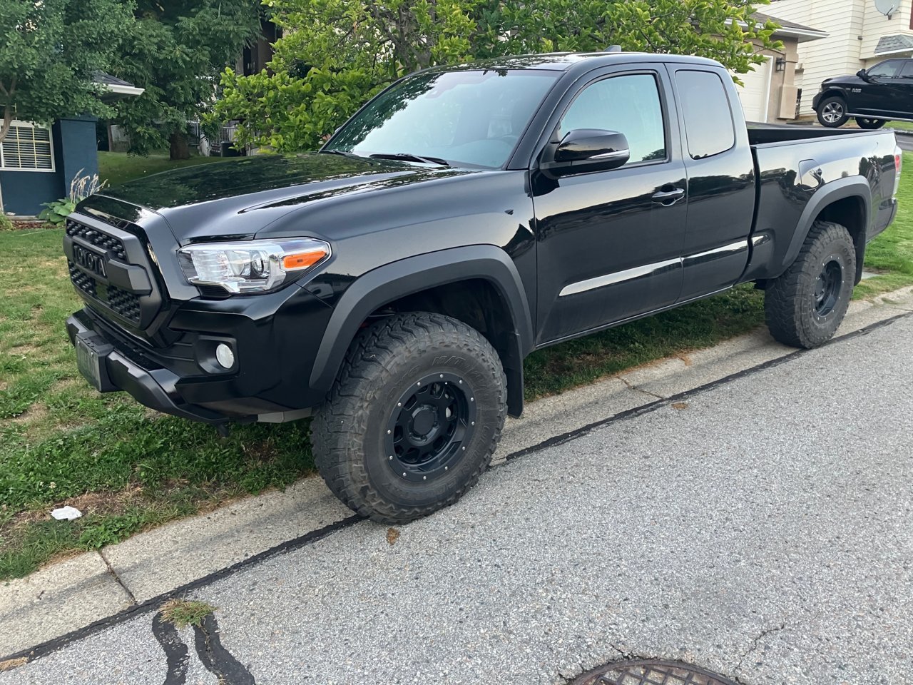

    Dec 31, 2022
    #414388
    687
    Kootenays, British Columbia
    2022 Black AC OR MT w/all TRD goodies
    TRD: Lift, Exhaust, Air Intake, Skid Plate & "Beadlock" wheels. Batman sticker. 255/85R16 Toyo MTs. Debadged. H9s.
    I have a set of the Toyo M/Ts size 255/85/16 on TRD "fake beadlock" rims with a +10 mm offset. Also have the TRD OEM lift kit (aka: "the shocker")
    Lots of off-road adventures in 4LO in BC since they were installed in first week of May.
    No rubbing that I've heard or seen signs of.
    Have the OEM mud flaps still in place. 2022 OR Access Cab.
    Dealer in Nelson, BC, supplied and installed the tires (and the lift kit when purchased new last September for that matter) and I think they did a great job on getting the alignment/caster, etc., "just so."
