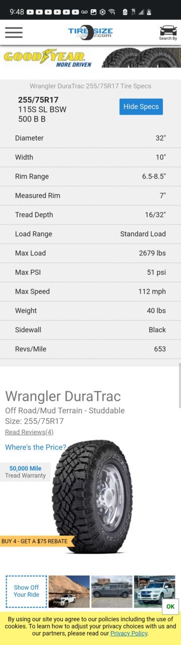

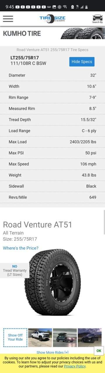

    Which one of these 3 do you guys think is best for a truck that's mostly on normal roads and to avoid getting stuck off road? This post definitely convinced me to get some 255s thanks

    All 3 are great choices. I have experience with all of them. They all perform well on road and off-road, in snow, wet and mud. The wrangler has the most aggressive tread. It’s an all terrain tire. The kumho is an in between for aggressiveness and geolander looks more like an all season tire.
    Looking at your pics, the wrangler and geolander are standard load ratings while the kumho is a C-ply. Depending if you tow, how much off-road you do and if you air down, the C load will offer more sidewall protection and can carry a heavier load. The kumho tire weigh is reasonable and it falls right in between the other two
