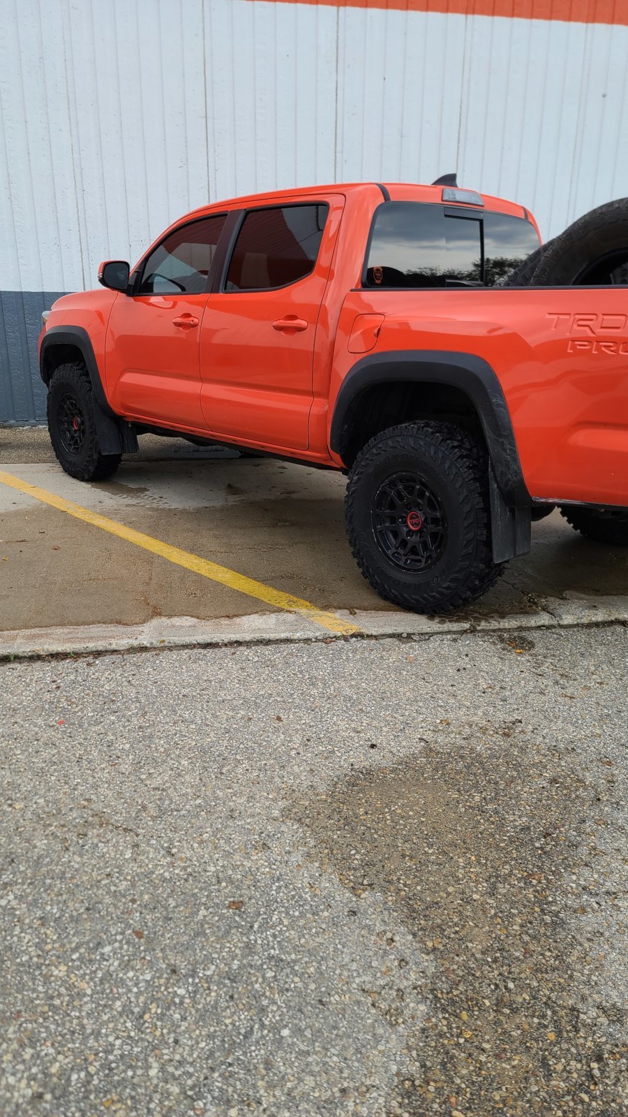

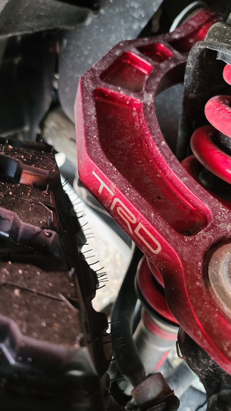

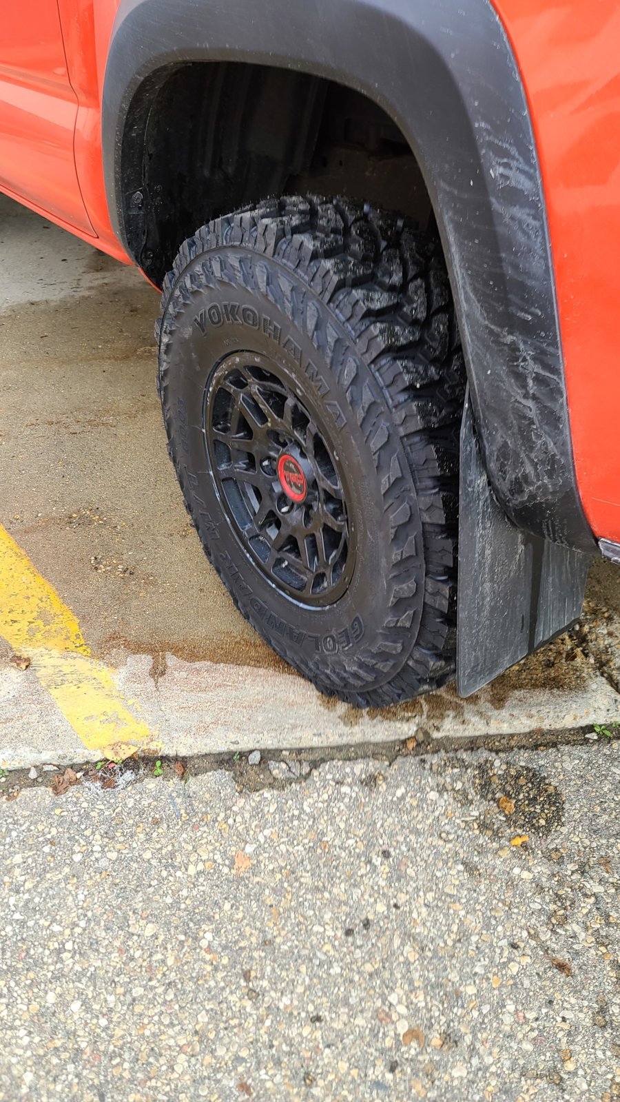

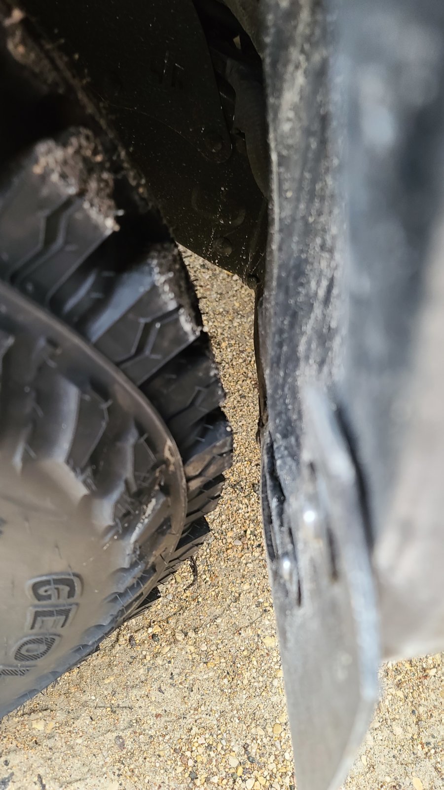

    Well I figured I would update this for anyone wanting to know if a 255/85r16 fits on a stock 22 or 23 pro with the billet uca.
    I got my geolander g003s mounted today on my stock 23 pro 255/85r16 11700km, alignments never been touched. I have rokblokz regular mudflaps with out the spacer on the L bracket so it pulls them out of the way more.
    I had heated the plastic in the rear of the front wheel well and heated the flap to mold everything for a bit more clearance before I had the tires mounted. I didn't like how the flaps were sitting, and I didn't cut the extra marked notch on the flaps out. This is what rokblokz says to do to have more clearance but then there is a gap.
    As you can see tires clear the factory uca at full lock so no issues there, not sure if my extra clearance was needed on the cab side by the flap but I doubt it. No rub when on road no matter what I do. It may kiss the truck off road a tiny bit but nothing I would be concerned about.
    I've seen 255/80r17 and 255/85r16 out perform wider tires many times in the terrain I run and I think they look awesome. I don't really care what instagram thinks about my truck lol. So go nuts if you have a newer pro, it all clears fine. I'm very impressed with how smooth they run compared to every other 10 ply tire I've had in the past. 20231003_130829.jpg 20231003_130833.jpg 20231003_174849.jpg 20231003_131622.jpg
