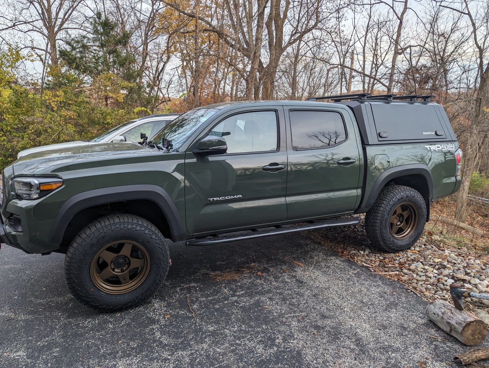

    Just got it back 255/80R17 Falken Wildpeak on SCS Gen 5 with -10 offset. I like it but there is some rubbing which infixed with some cutting and a heat gun. This is only based on ride home and I will still do a CMC and UCA' before Xmas.
    I also measured and they are 32.5 when mounted on the wider wheel.
