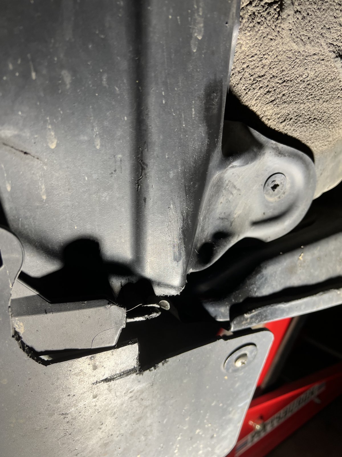

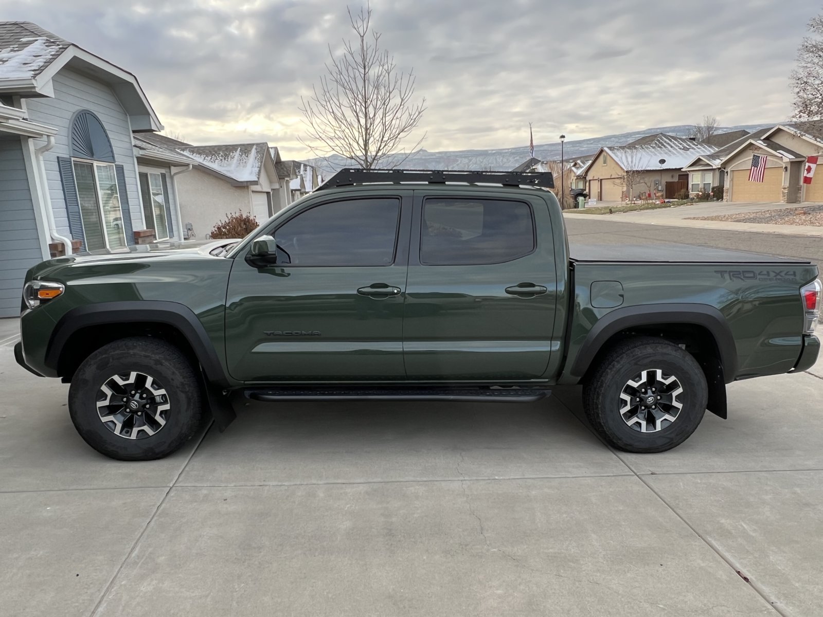

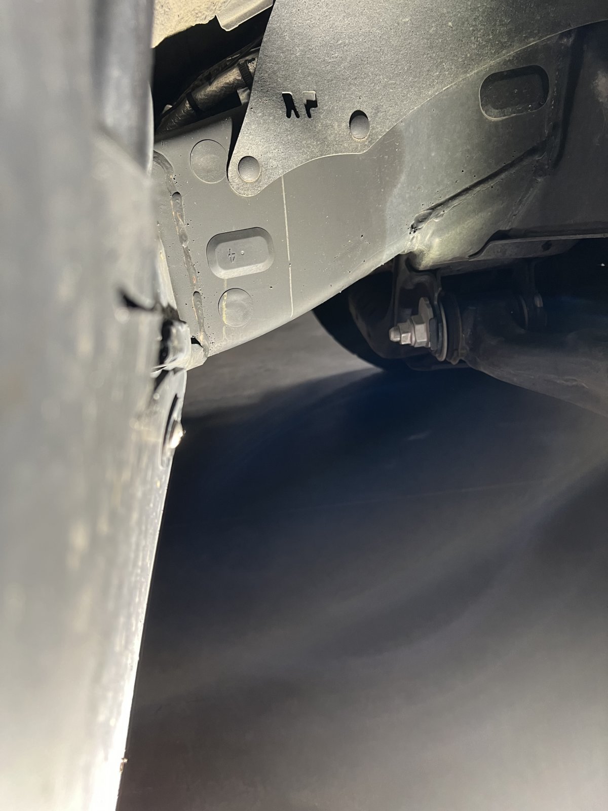

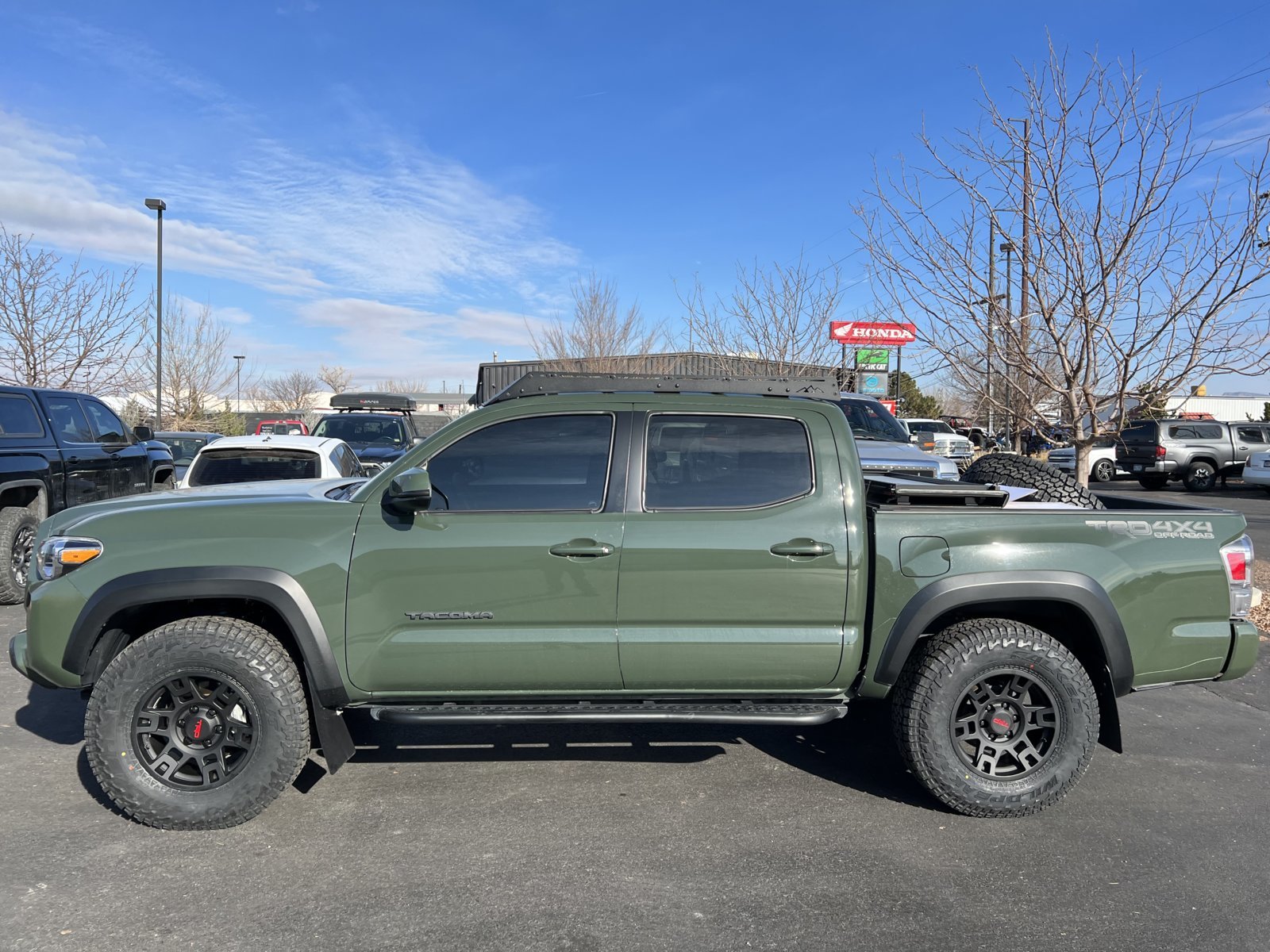

    I made the jump to pizza cutters thanks to this thread! Thanks to Jordan @Discount Tire for hooking me up with 255/80 17 Falken Wildpeaks AT3. I also took advantage of the 25% off & free shipping from Toyota’s Black Friday/ Cyber Monday deal. The rims I got are the older style 4Runner PTR20-35110-BK. I absolutely love this setup but I’m still battling some rubbing issues when turning. I had an alignment done at Firestone & it wasn’t out by much but they said they adjusted the toe & said it was good. The technician told me the only way to fix the rubbing is by lifting the truck. He said an alignment will never solve rubbing issues. I’m thinking BS on that because of this thread. The suspension is the stock off-road & I know others have done it this way & I really hope I can to. The only place it’s rubbing from what I can tell is in the back of the wheel well. I have heated & pushed in as much plastic as I can. It’s definitely not rubbing on the RokBlox mud flaps. Any suggestions would be greatly appreciated as I REALLY love this setup and would like to have it with no rubbing.

  15. Dec 2, 2023 at 8:34 AM

    Take off the mudflaps and see if that solves it. You can put them back on if it doesn’t.

    I tried that & it didn’t make a difference. I was able to get the plastic from the fender liner shoved back a tiny bit more so maybe that will do it . Thanks for the suggestion though!

    Alignment noob is wrong, a lift will not solve the rubbing. Look into doing a pinch weld fold. Pretty easy to do

    Ya that’s what I thought too. Later today I’ll take a picture of what the technician wrote on the alignment paperwork for his recommendation. You guys will have good laugh about what he wrote. I’ll look into the pinch weld fold, thank you! Any chance you have a link for it? Sometimes it takes forever using the search function on here to find what you’re looking for. I appreciate the help!

    Probably just need to push the wheels forward with alignment, no need to do the pinch weld with skinny 33s

    Depends on wheel offset too, cant just generalize a tire size fitting without all the parts of the equation. I 100% had to do the fold the tire did slightly rub the cab mount with my 0 offset wheels.
