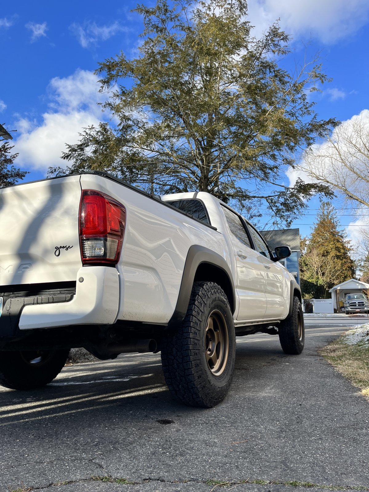

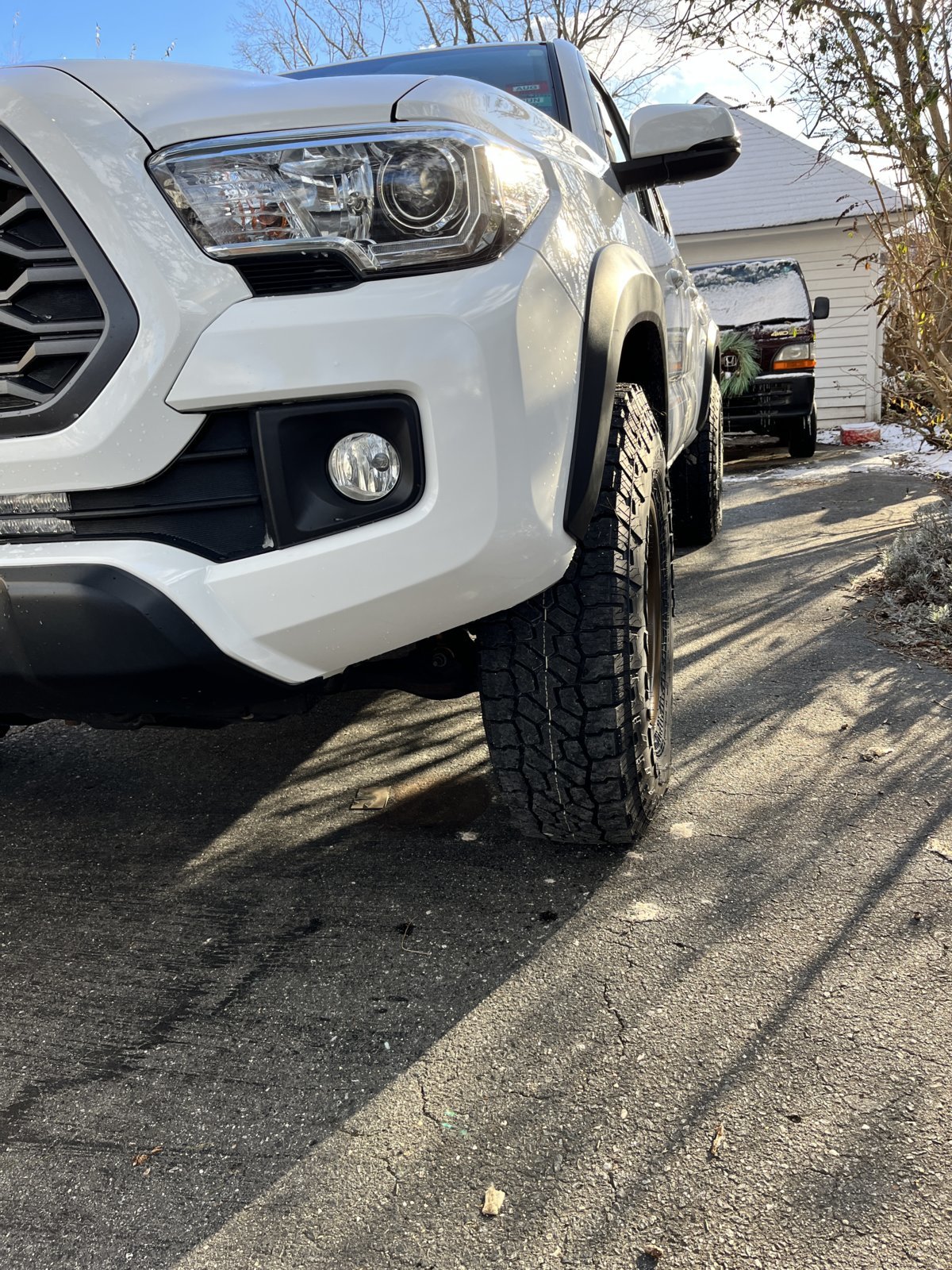

    They feel slightly heavier than the stock wranglers, for sure. I don’t have anything else to compare them to.

    Truck looks great! Out of curiosity what's your mounted tire height?

    Thanks bro, I think it looks nice too. Installing the trail grille as soon as my garnish arrives from taco garage. The bronze in the trail grille matches the scs dark bronze really well. And yes, I’m on stock OR suspension.

    I will measure them and get back to you.

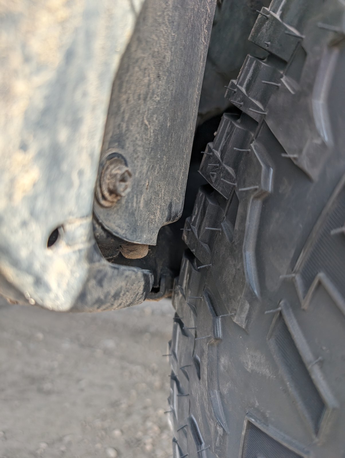

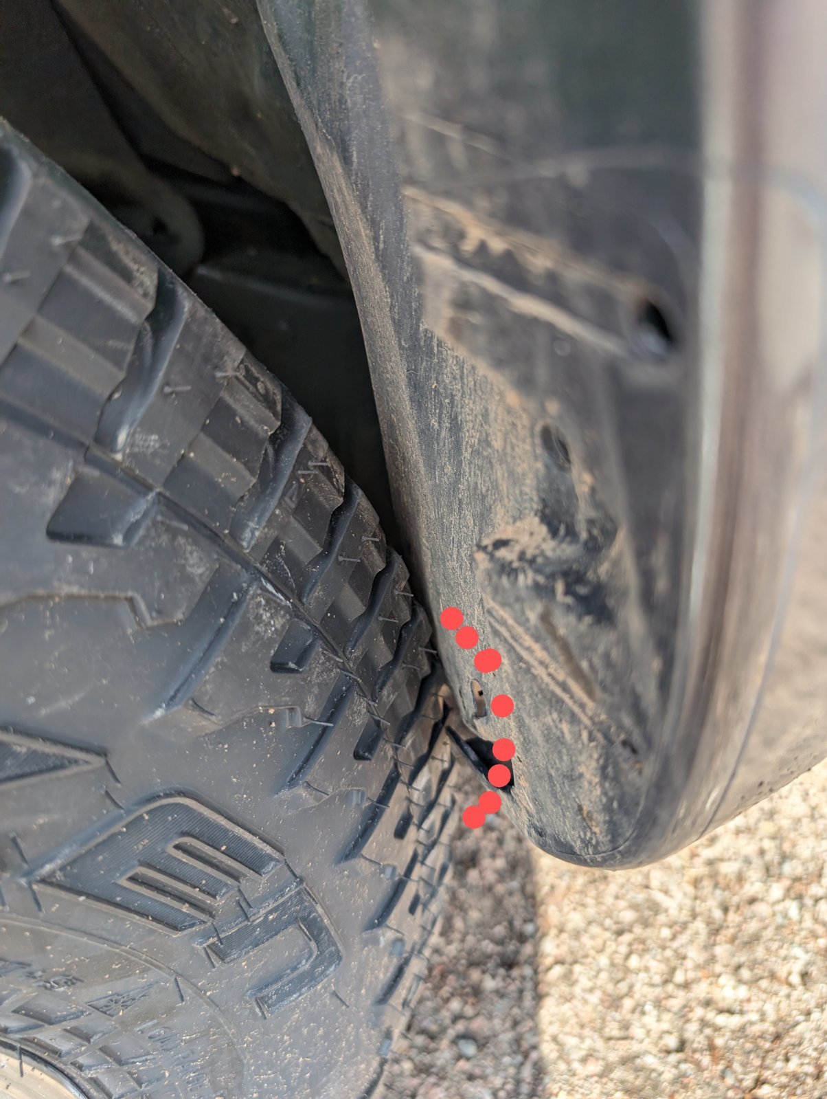

    Hi y'all. Just put on 255/80/17 wildpeaks AT3W load E on my 2014 (stock sport wheels) and they unfortunately rubbed my JBA upper arms. I ended up installing spidertrax as a bandaid until I figure out wheels and they cleared the UCAs but is now running against my frame lol. Throwing this out there to anyone who is researching, it does look like I'm in the minority but FYI. Running a simple 5100s 885 mid dakar lift as well.
    -Rorschach- and M37r1c like this.

    I have the exact same issue as well I got JBAs on my regular cab with the sport wheels you got. Its interesting cause sometimes it rubs and sometimes it doesn't. What size spidertrax did you get? I've been debating getting something like half inch hub centeric spacers. The rubbing isn't bad but its there.
    Dumneezooo[QUOTED] likes this.

    Got the standard 1.25". It was a good experiment to see whether 0mm offset would rub or not. Here's a pic of the wheel nearly fully locked. I want to say that 0.75" bora spacers might work
    Edit: you prob will have to grind down the studs on slimmer spacers based on what I found in my 20 mins of research. I'm assuming this is why spidertrax is only offering their size in 1.25"

    FJ wheels or these 4Runner trail/offroad wheels will help the tires clear the UCA and the body mount. Your stock wheels have 30mm offset, and the 4runner wheels are 15mm. So you gain 15mm of UCA clearance while hopefully keeping the tire off the body mount. Basically these wheels put the tire in the sweet spot for less rubbing. IMG_5150.jpg

    JBA’s are known to rub. The area where the ball joint mounts sticks way out.

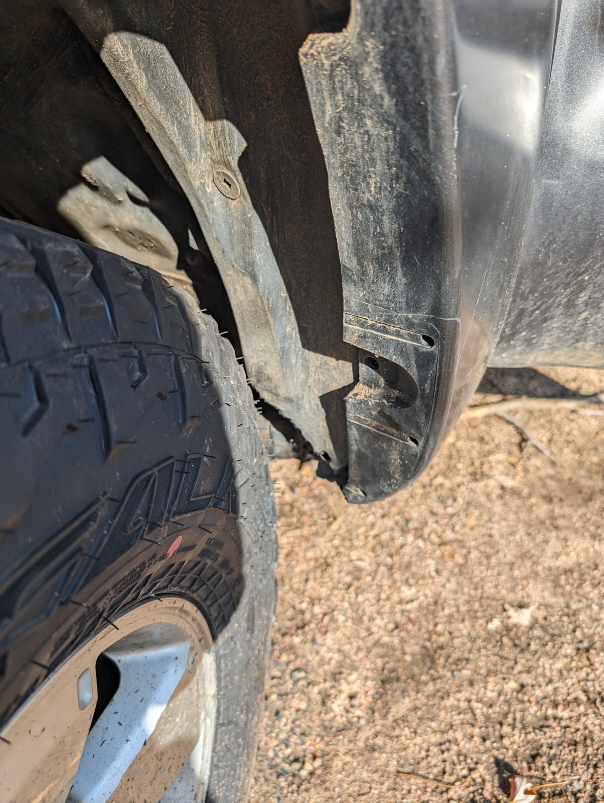

    Update, no rubbing!!! Did some minor plastic trimming and am not rubbing around town. CMC gotta happen sometime before I do heavy wheeling
    BatteredTaco and Road_Warrior like this.

    Trimming the plastic there, doing cab mount chop, and beating back the pinch weld/plastics inside is common for any kind of offset deeper than stock with 32"+ tires which is what you effectively did with the spacers. You may also get some rubbing on the front of the fender now when going in reverse and turning. I had to trim the plastic rear and the front (havent done the CMC yet though)

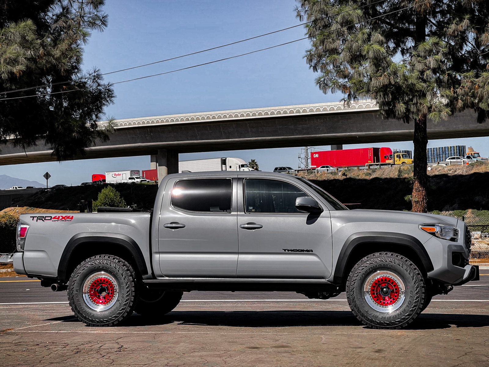

    17" TRD SEMA wheels w/ 265/70R17 Nitto Grappler G2

    That setup is so close to perfect! If only the barrels were setup for like a 0 offset or something. That tire size fits SO well on a 7" wheel. Really is a shame all the modern aftermarket stuff is so damn wide.
    Good luck with the sale!

    I run a 1” spacer and it’s effectively 0 offset! It’s solid

    Yeah, I saw that's what you were running. Gotta do what you gotta do. I've been wanting to build a 16x7 +0 set for a while but just can't justify the $$.
