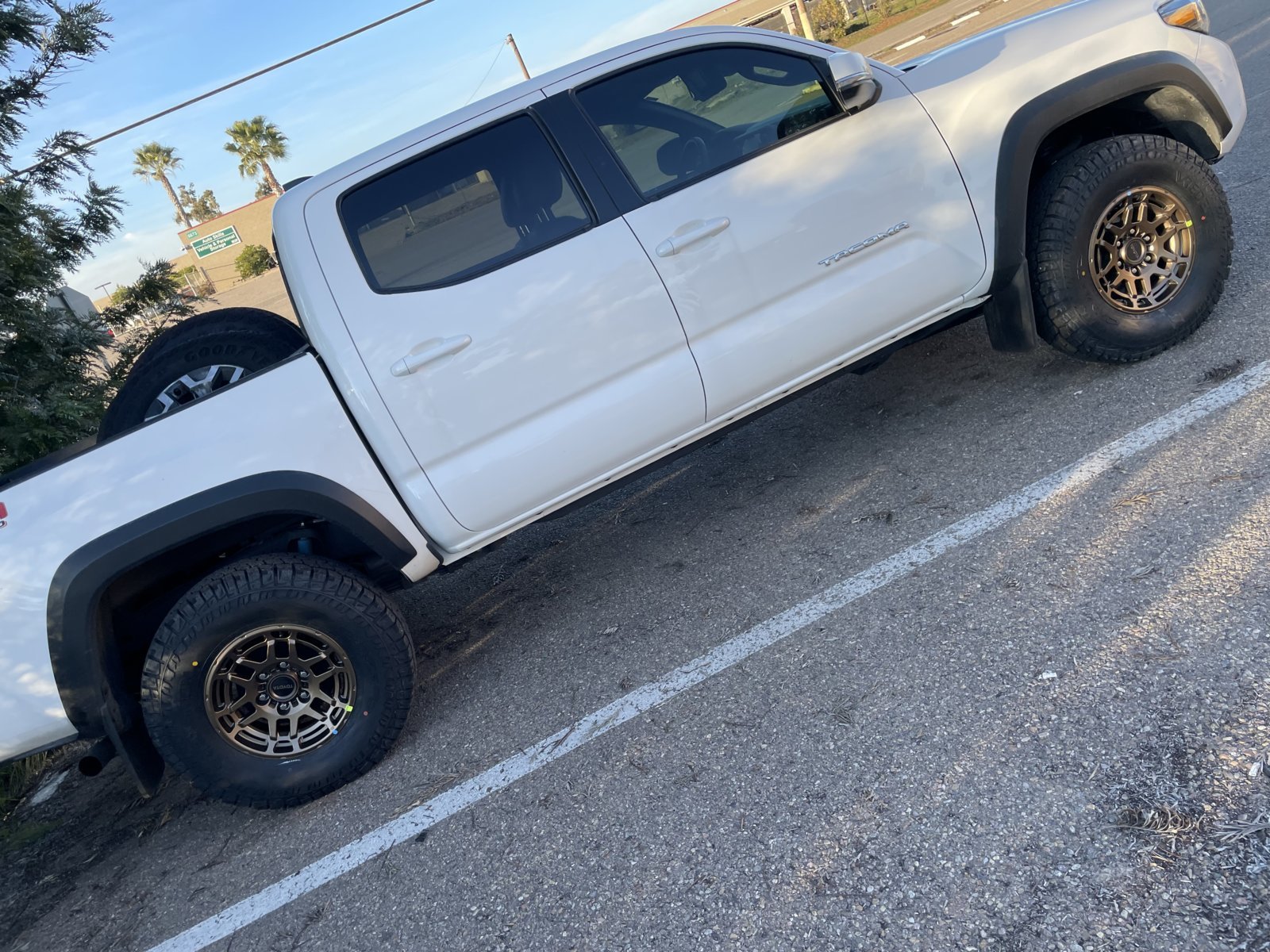

    Old post but how did you like these wheels? Just ordered some 33x10.5 kendas and was looking at these to save some weight. Any negatives with the -10 offset?

    Loved them. No faux beadlock or a rim lip that would hold water. I’m still on SCS wheels, but SR8s in the same specs as those Stealth 6s were, 17x8.5 -10 offset.
    A negative offset will push the wheel/tire outboard from the truck. -10 is kinda the sweet spot for negative offsets in being not too extreme and causing crazy rubbing, but providing UCA clearance and a moderate ‘stance.’ That ‘stance’ will have your tires tossing anything and everything all over the side of your truck. Mudflaps are advised.

    I’m actually hoping it’s not too much stance. I really like the 0 offset but the weight is just spot on and they look great to boot. Ha the mud is the details I’m after I’ve got to get them back on in the front then.

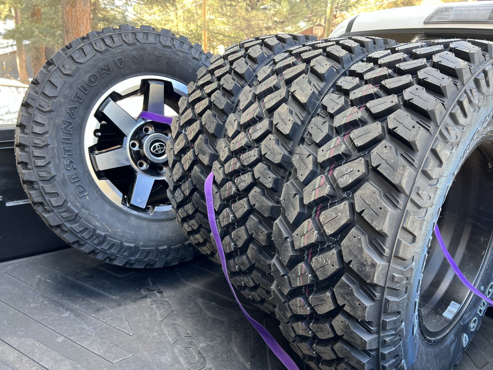

    My original plan was the AT4W in 255/85r16, but found a smoking deal on these 255/75r17 Firestone MTs- $550 shipped! Couldn’t pass up the deal and will have them mounted on 4Runner wheels. Looking forward to the snow melting!

    had those firestones on my 4th gen 4runner. they were loud.....but in 285-70-17, i never got stick. powered thru anything. great mud tire.

    Hopefully they won’t be louder than my studded snow tires

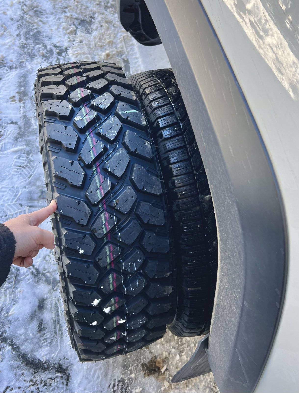

    They are getting mounted up tomorrow, but won’t run them till March when I have a trip planned to Glen Canyon NRA. I live in the foothills west of Denver and it’s too icy for a MT tire for a while. Looking forward to finding out if these C rated tires are any smoother riding than the 255/80r17 Falken AT3W

    Mounted up and ready for spring! They balanced without much weight. Can’t wait to switch to these once ice season is over
