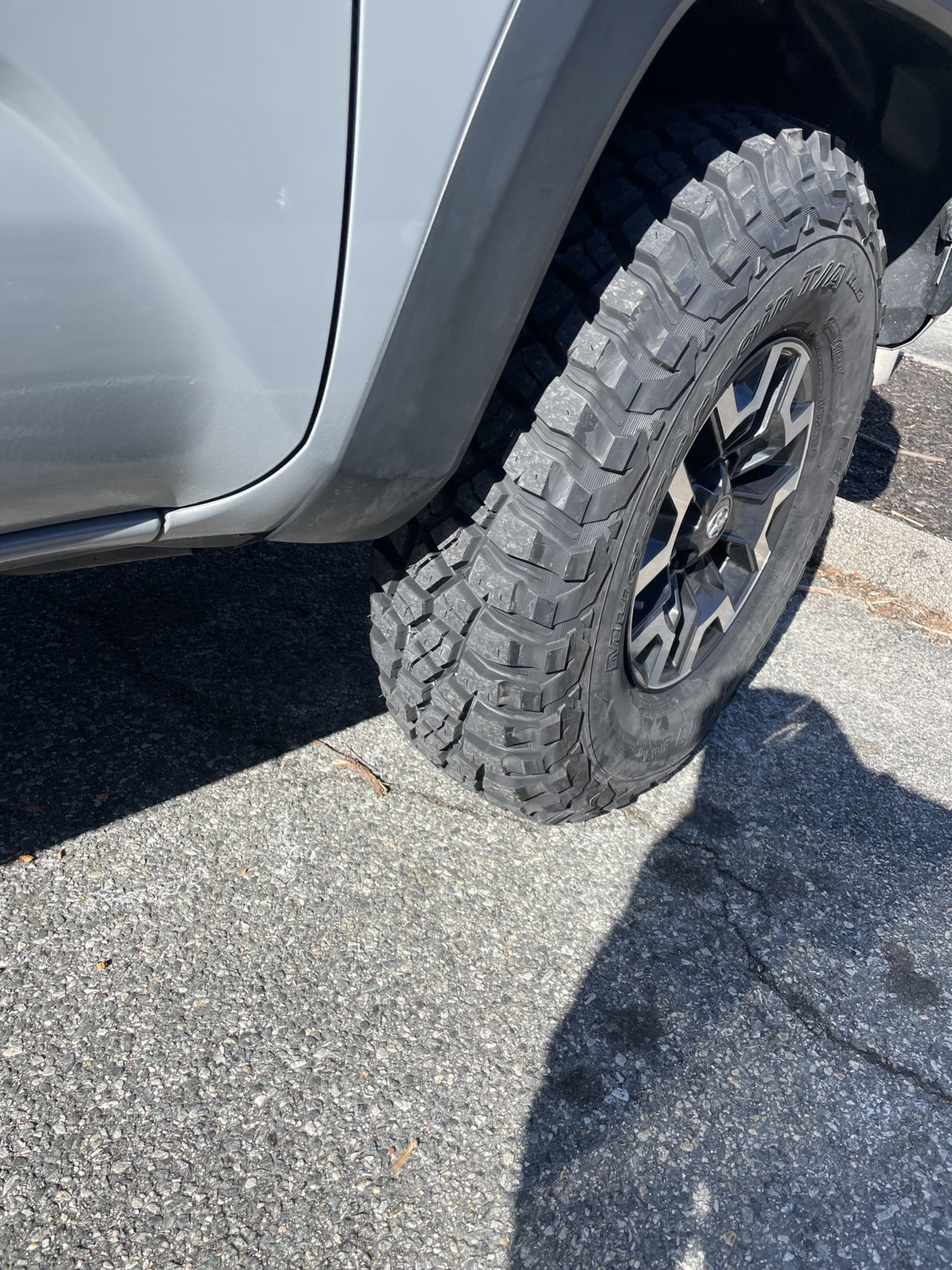

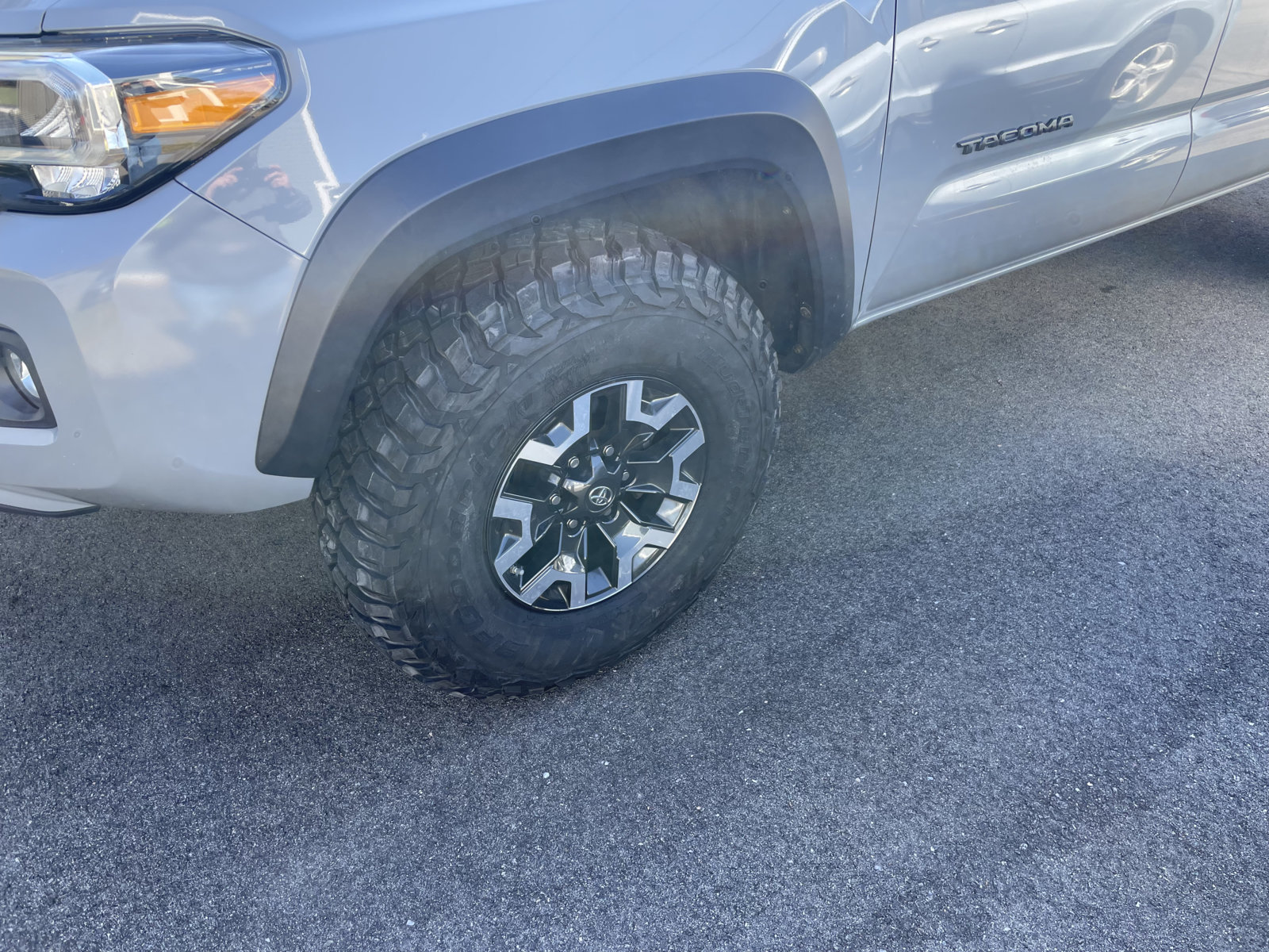

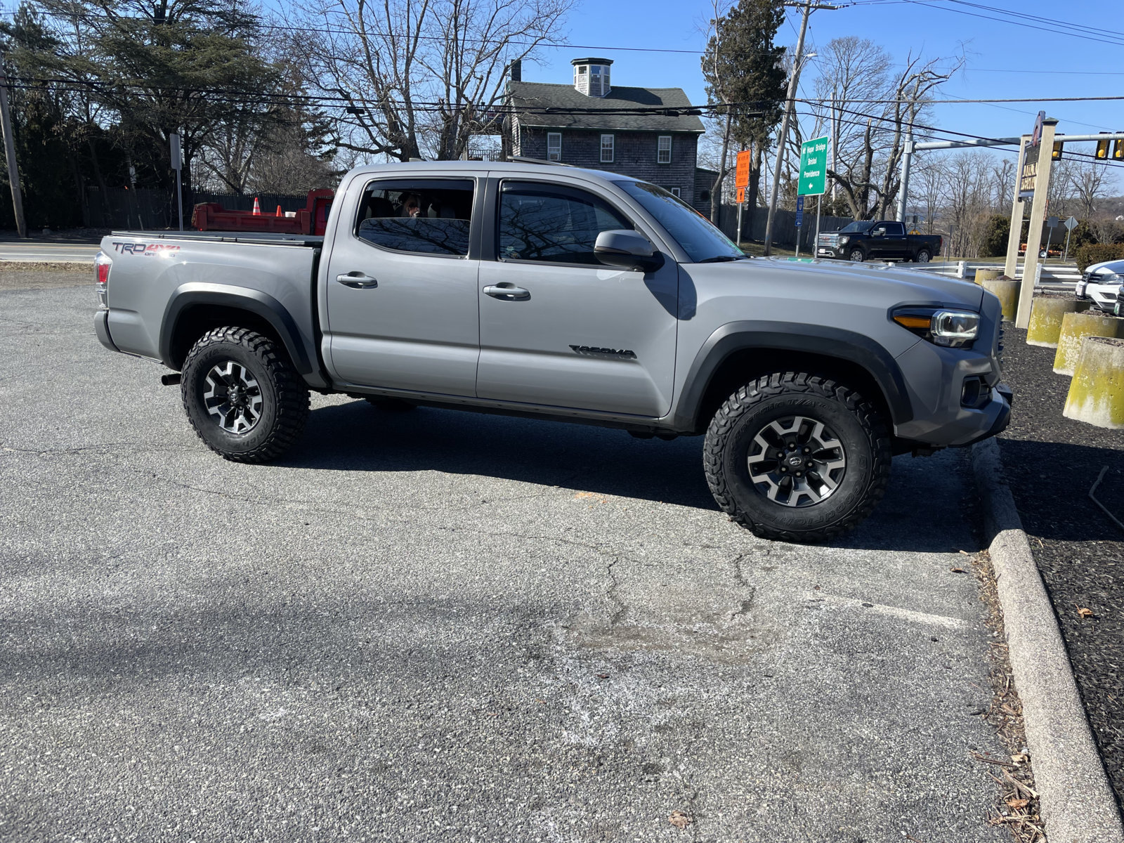

    yes just got bf goodrich 255/85r16 mud terrains put on today, just had to remove the mud guards which I was intending on anyway stock 2021 OR no lift or wheel spacers no cutting no rub! tire shop was skeptical until they did a test fit they really didn't want to try to test fit but I woulda just got them done somewhere else if they didn't.

    I'm considering this size and also have an OR with stock suspension. Did you remove the mud guards as a precaution or do they actually interfere with the tires?

    So I removed them after tire install as they rubbed slightly while turning and braking but just barely. I was gonna take them off either way after a off-roading trip in NH. A few of the guys that I went with were worried about them getting ripped off if I got hung up… luckily these trucks are awesome in stock form and I came home with fenders still intact but after I took them off I drove around 30miles and no more rubbing.

    Any more updates on these? How are they riding? What’s your mpg look like? Do you have any additional side profile shots so I can see how they fill the wheel well? Just trying to make sure they aren’t too stuffed for my liking. I installed the TRD lift kit on my 23 OR and have been looking into this tire size recently trying to decide on my next set. This looks really good.

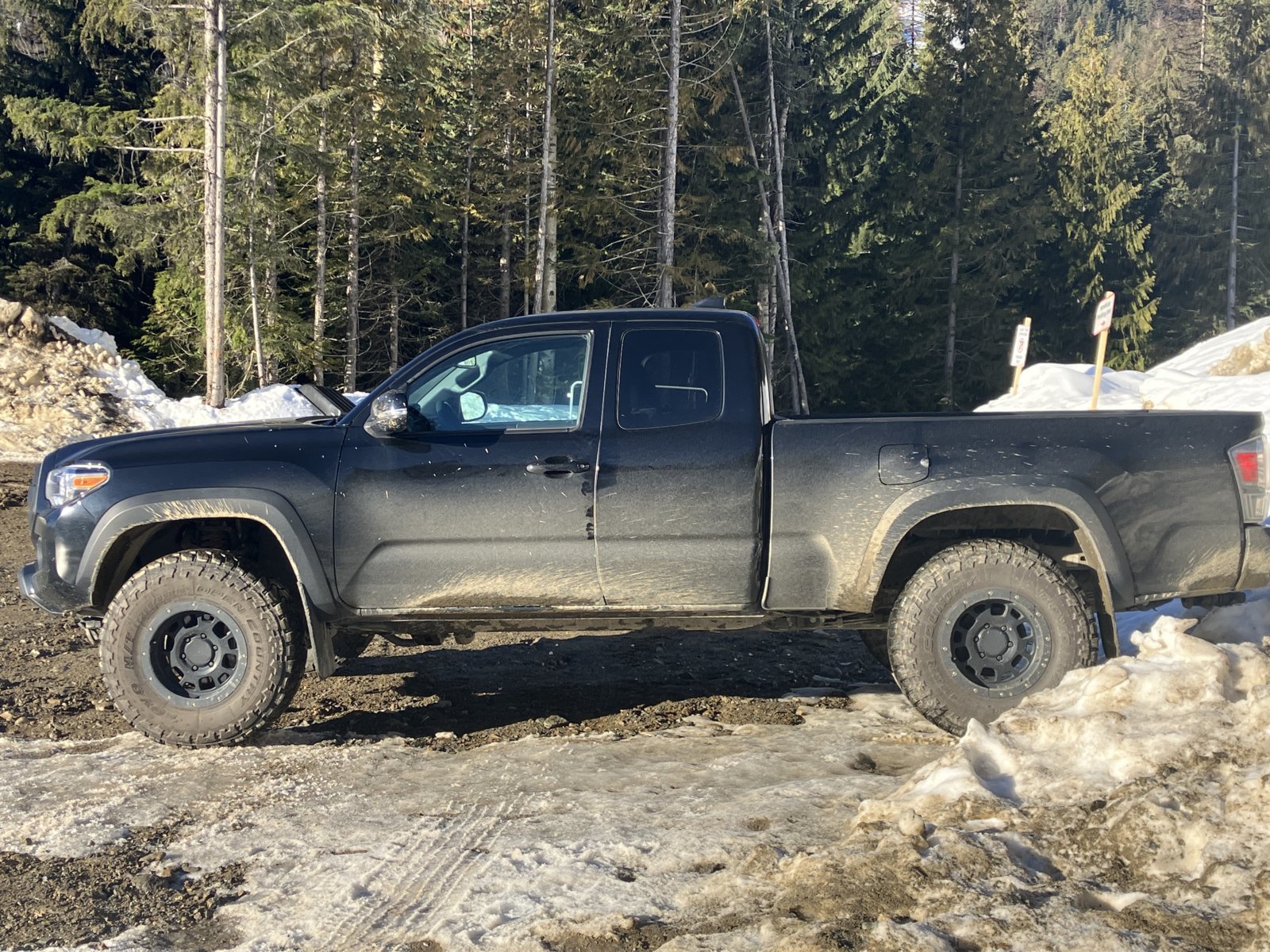

    Noise and performance on ice are pretty much as expected. I drive to and from work and the ski resort, elevation difference is around 1000 m (3300’) so fuel consumption suffers, especially when in 4WD. Most recent fillup gave a bit under 14 L/100 km (17-18 mpg). On long highway drives at the speed limit, can get as low as around 10 L/100.

    10L/100km is like 23.5mpg, right? That's pretty impressive for 33s. I honestly wouldn't expect more than 16-18mpg driving up and down a mountain... Honestly, that's pretty good imo.
    As far as performance on ice, what do you mean expected? Do they do alright? Better or worse than stock?
    Man that thing looks good!

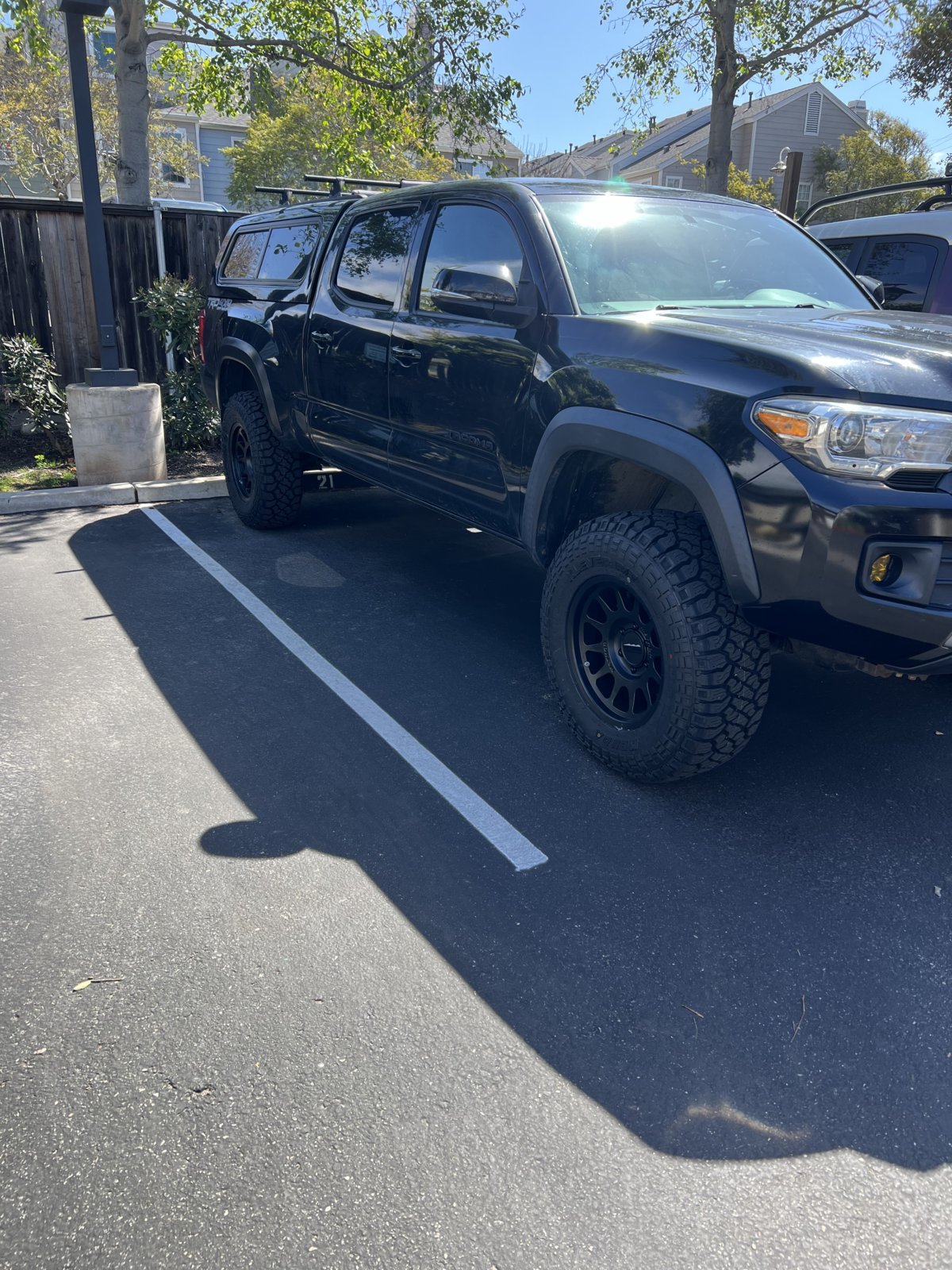

    Not really sure 33x10.5 are really skinny but this thread was super helpful in my tire decision. Epic people on this thread.
    Kenda Klever RT, no trail fun for the next few weeks but road manners have been good. Low noise and pretty comfortable for a heavy E rated tire.
    CMC/pinch weld is done but not required at this size, minor heat molding in the front.
    Sips more fuel and requires a bit more to stop but driving isn't bad. I save my speed for my wifes subie anyways.
    Only bummer is discount scratched the spare. I was upset at the start but it matches the trucks paint now.
