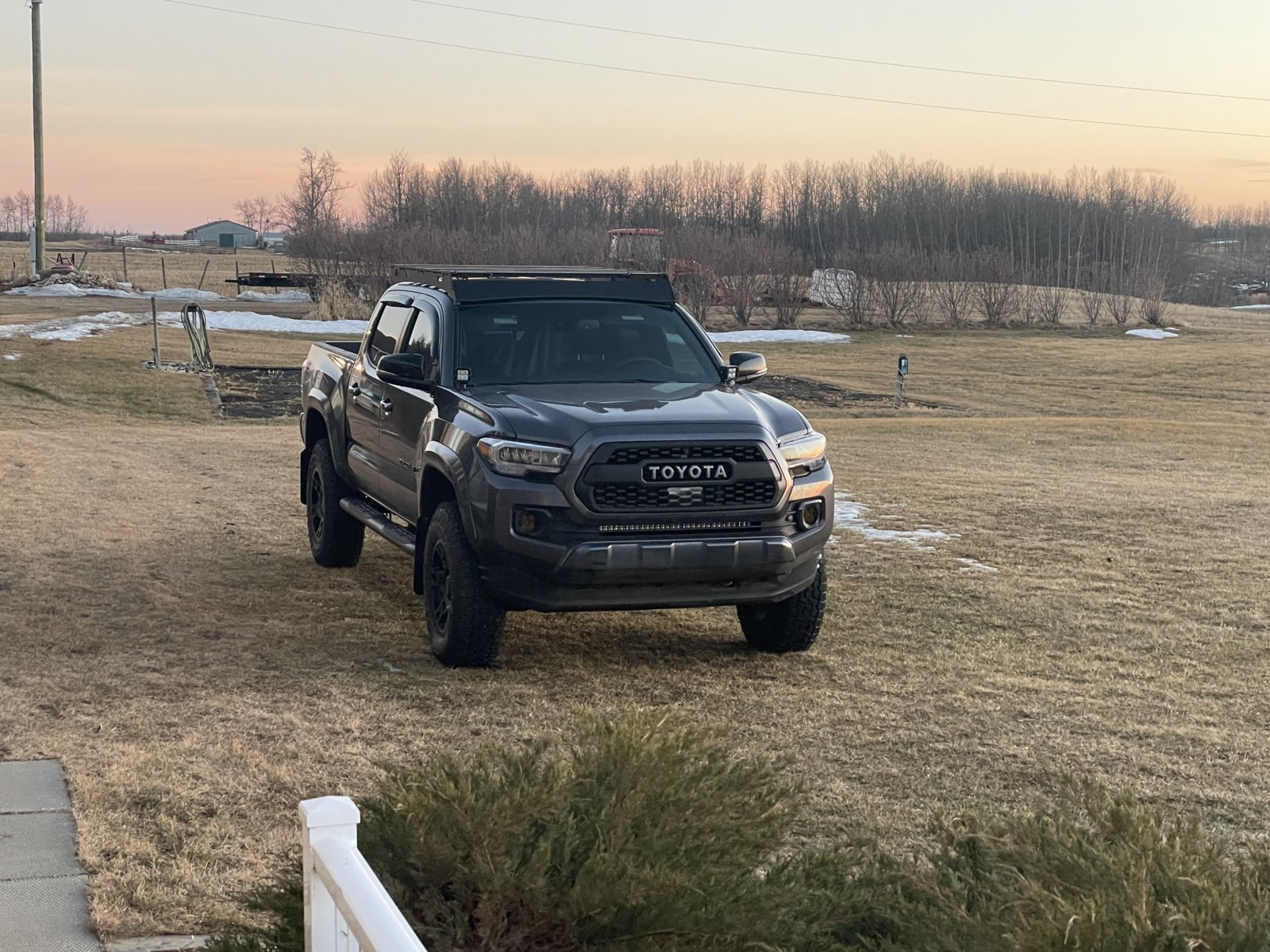

    New Tall n Skinny 255/75/17LT Kumho AT52's. 43lbs! So far I'm a big fan.

    @2013XSPX that is a crazy rugged looking Taco! Love the snorkel and the bronze wheels just pop! Great job on the mods.:thumbsup:

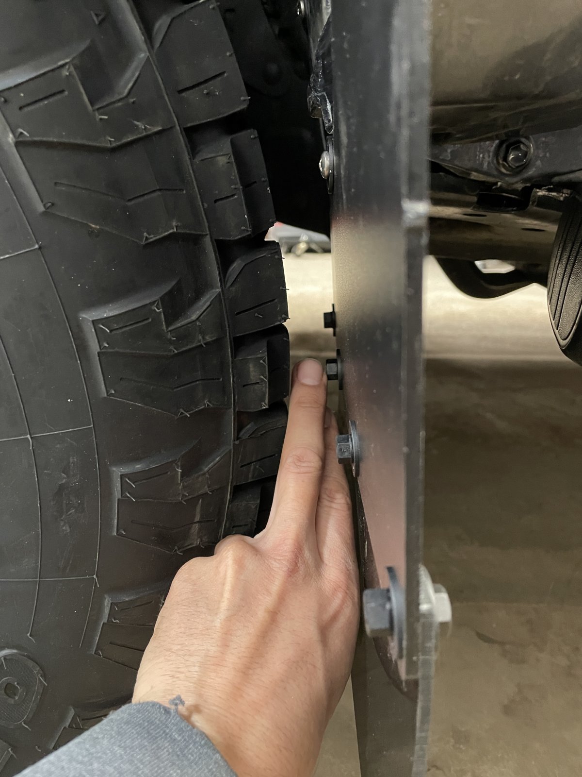

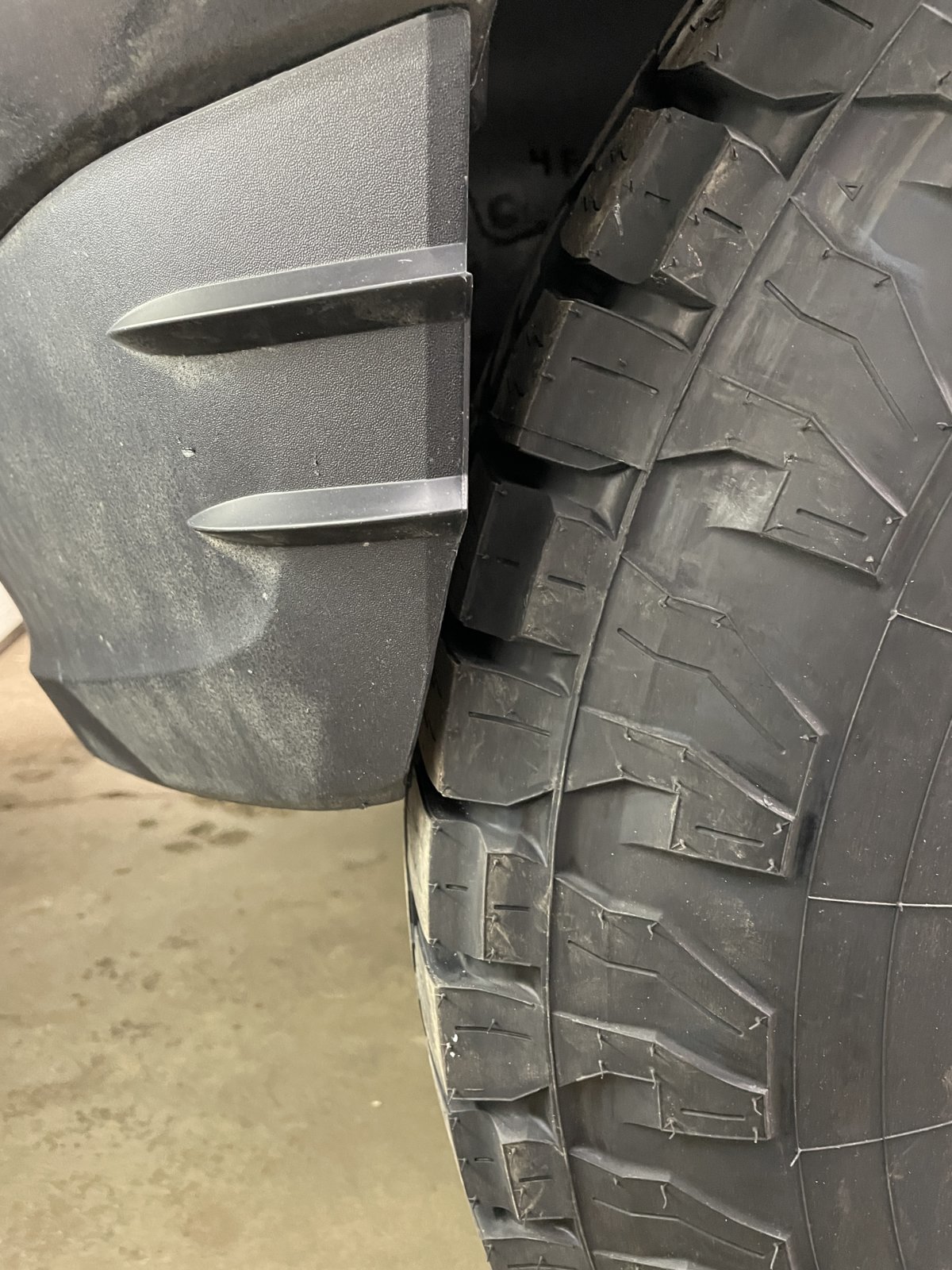

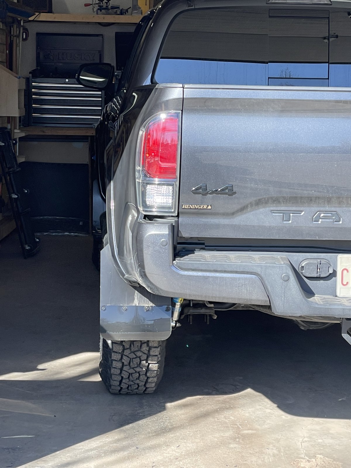

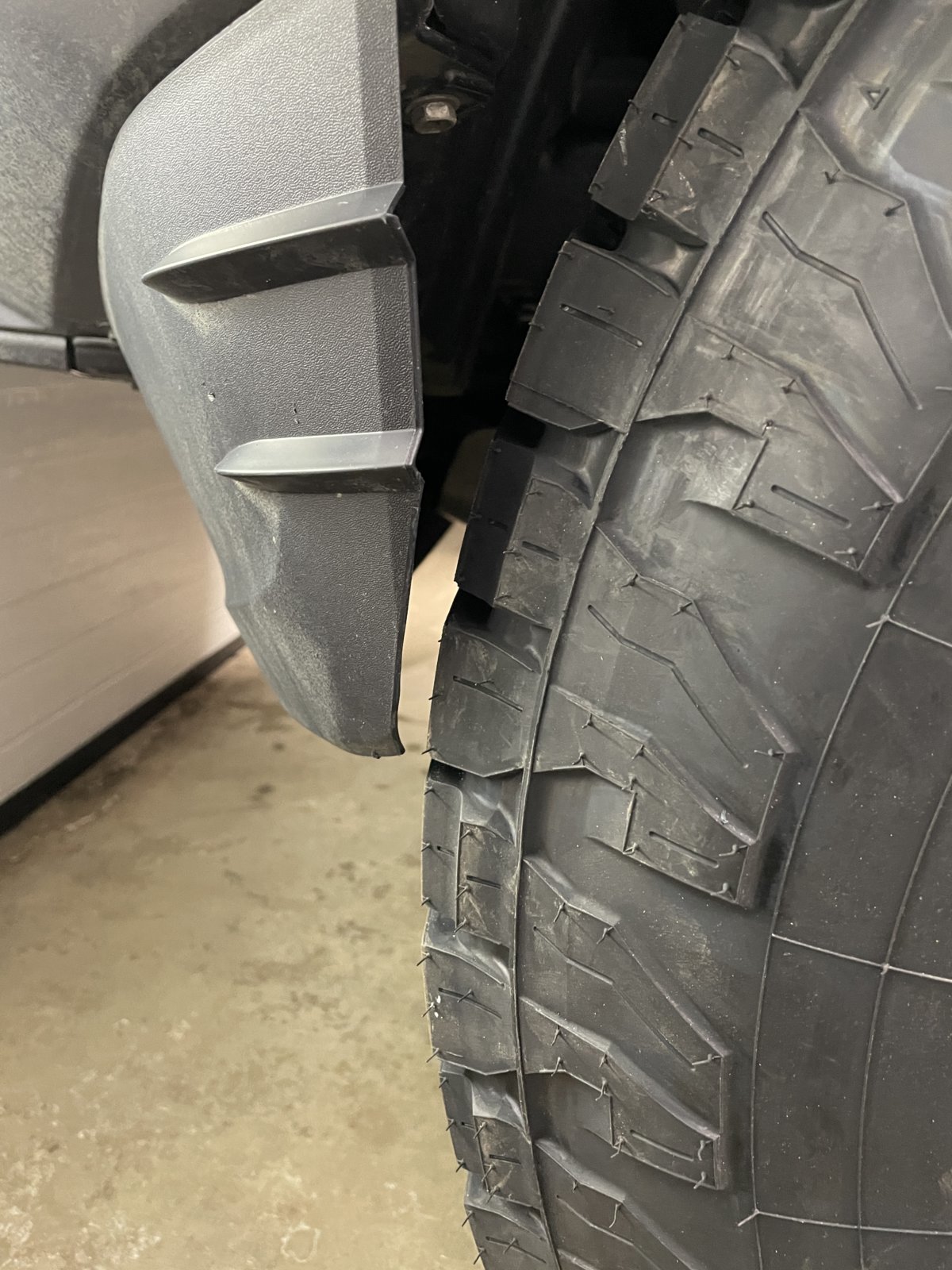

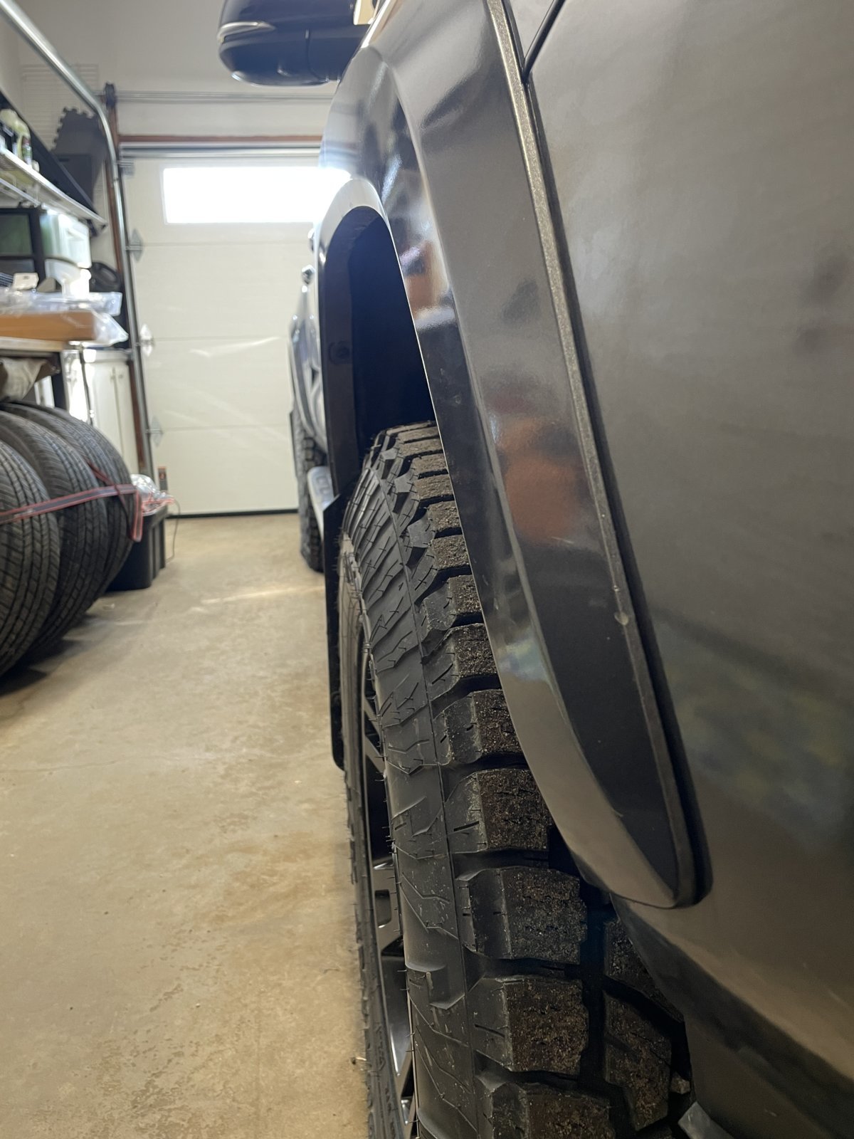

    Haha, the valance will come off at some point (stump bumper and skid plate soon) but for now it’s not limiting me much. It doesn’t really mess anything up unless you really need that high clearance, and in 98% of driving scenarios, I do not.

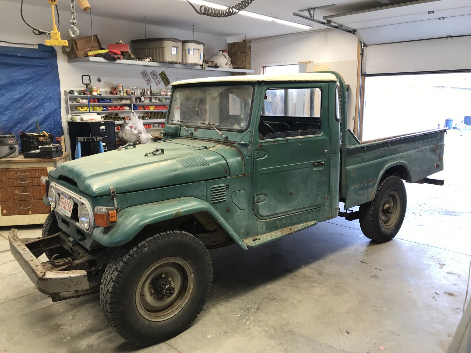

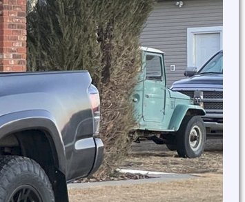

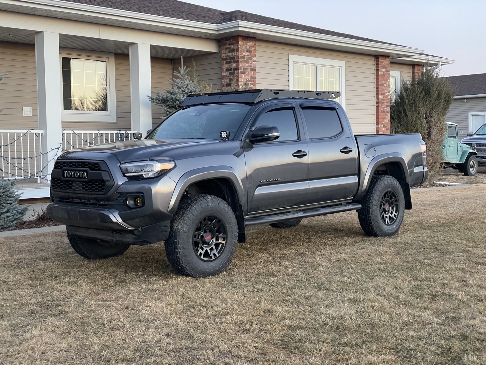

    Good eye! Also on skinnies:
    (1977 FJ45)
