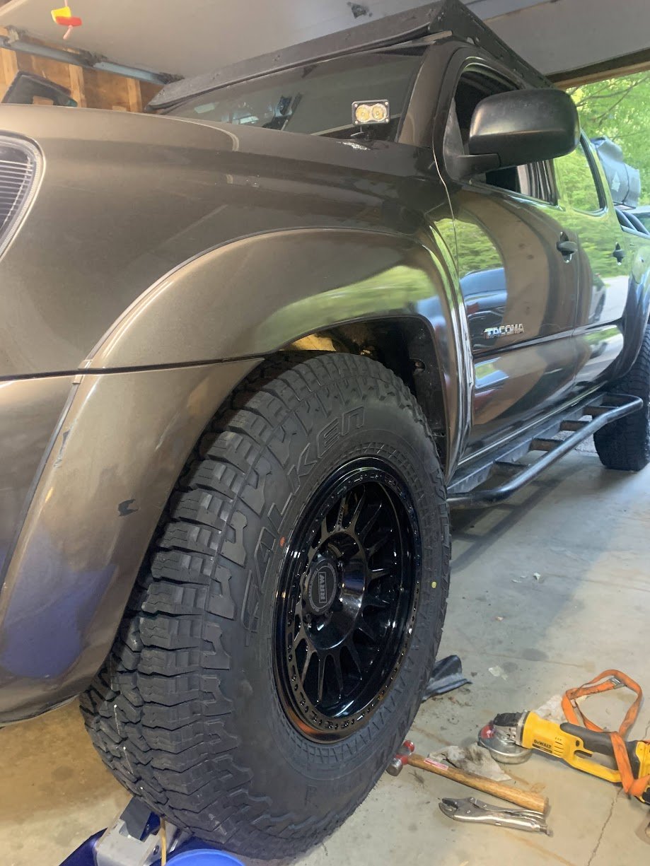

    TacoTuesday603
    TacoTuesday603 I welded it helded
    May 3, 2021
    #364592
    3,401
    Jack
    New Hampshire
    2011 OR DCFB
    Fox and Locked suspension 63's Skinny 33's
    I cant tell you about your truck but I had to do a pinch weld fold and a cmc with my setup. 255 80 17 on 0 offset wheel. Lift is irrelevant when talking about this. Barely rubbed the cab mount but I did it anyways to fully clear the tire from bump to strap lock to lock.
