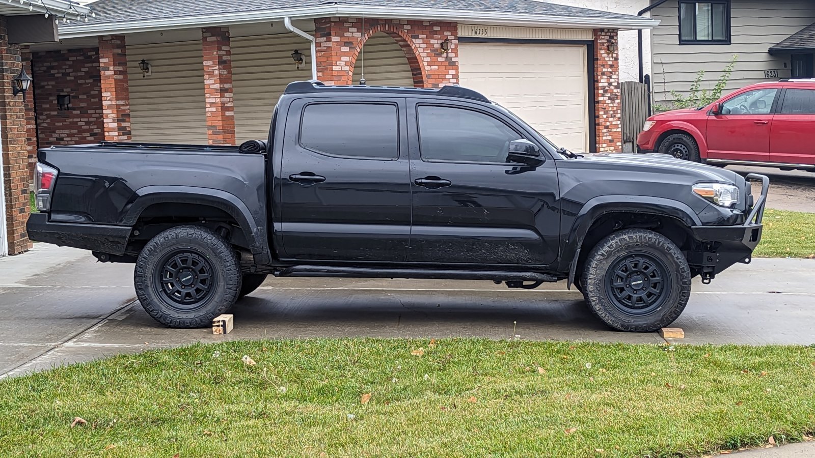

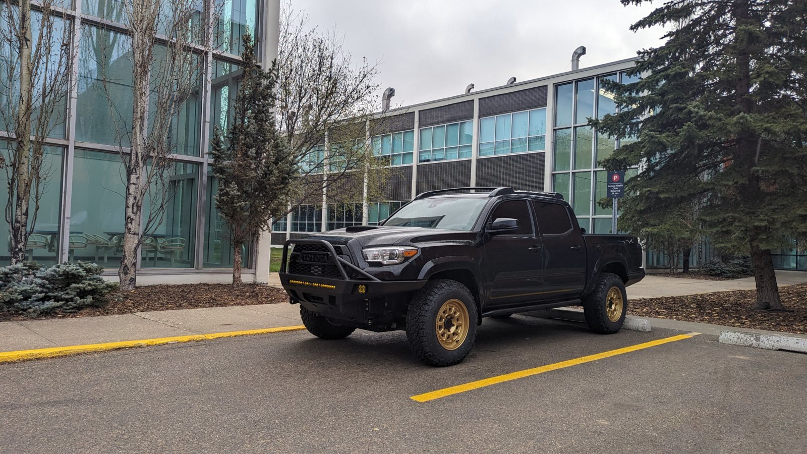

    I don't like black paint with black accents AND black wheels, so I need to powder-coat the wheels I have because they are decent and I want to save where possible.
    When in purchased this truck in 2022, it came with 265/65R17 Nitto Grapplers with Mayhem 8303 Voyager wheels (painted black). The tread had about negative one seasons on them, so I knew I could wait a year or two before replacing them :D. While that was happening, I waited for a good winter tire/wheel combo on marketplace and eventually picked up and installed 2nd gen TRD Off-Road 245/75R16 Studded with about 50% life.
    A couple months back I purchased some 255/75R17 KO2s and today, I dropped off the black Voyager wheels for powder-coating and should return in a month or less. I have 1.25" Spacers that will be installed which will bring my total offset to -30. I'm currently in the market for center caps but am thinking of cheating and buying Method center caps. Someone tell me I'm not a bad boy for doing that?? What if I buy a t-shirt from them too?

    255/75R17 on 8.5" wide wheels with a +9 offset and the use of 1.25" spacer. Lots of rubbing when turning right. Need to remove mudflaps at a minimum but I haven't gotten to it yet and don't drive often.

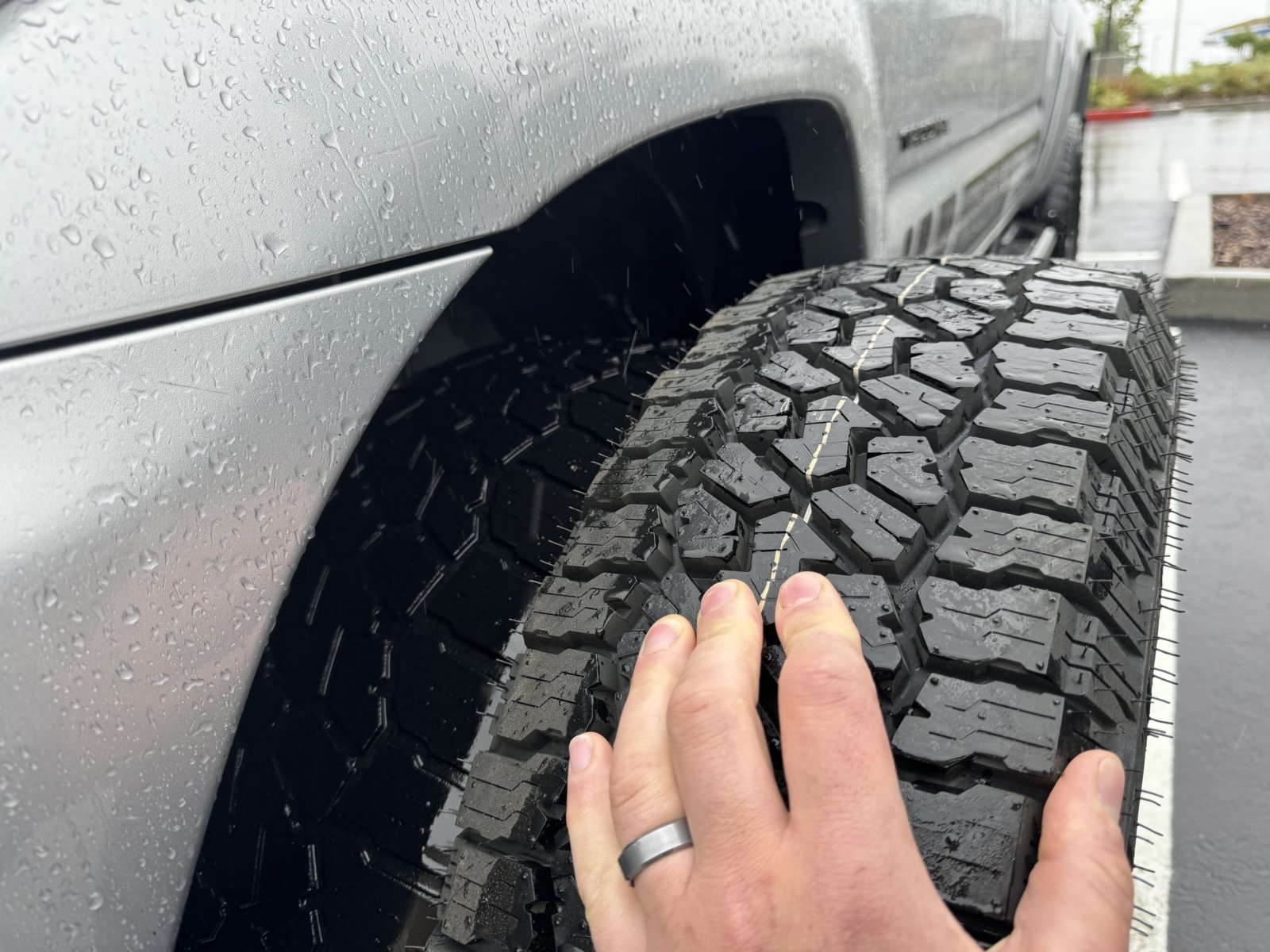

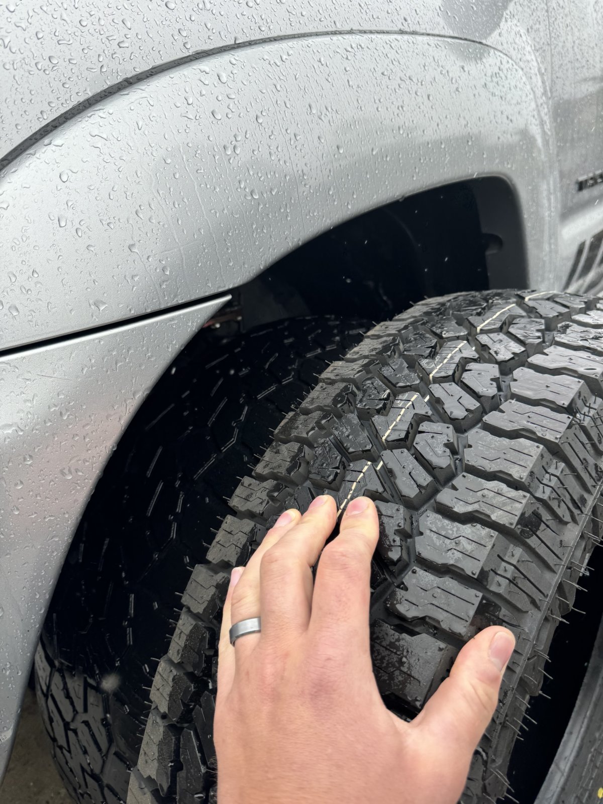

    Bilstein 6112/5160 OME Meduim leaf pack JBA HD UCA 3* retard exhaust gear TRD Pro Sema rims 265/70R17 Falken Wildpeak AT3W
    Going from 265-70-17 to 255-80-17
    1.5 inch lift front
    2 inch lift rear. rubs a little bit on mudflaps.

    oh yea. thanks to @Discount Tire got the tires price matched. And installed without issues. i was afraid they wouldnt want to install non-oem size....but i had no issues.

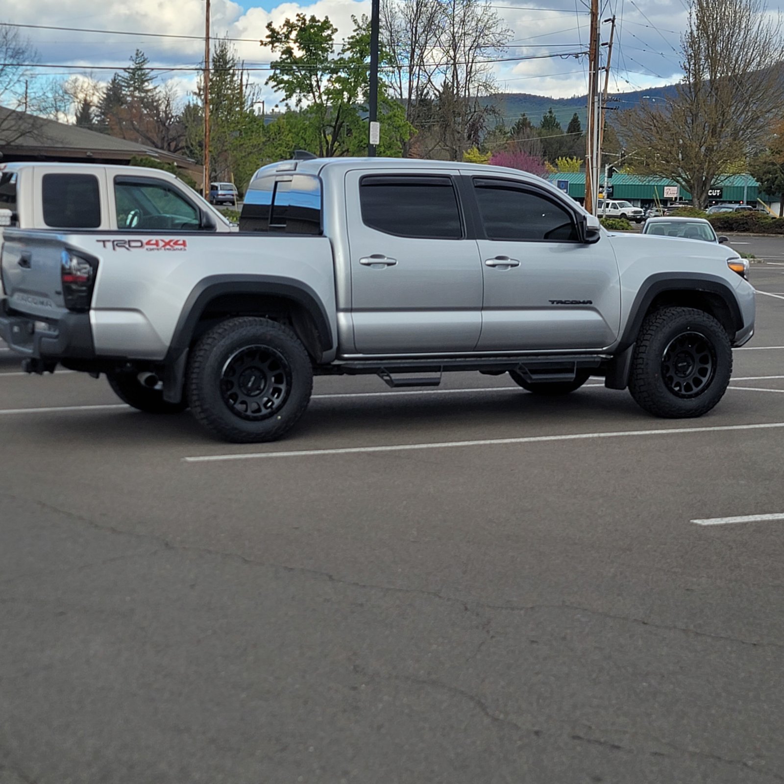

    TRD Pro Grille 5% Window Tint WeatherTech Side Window Deflectors Cali Raised Catalytic Converter Shield Leather Seat Covers JDMCAR Center Console Organizer JDMCAR Glove Box Organizer High Flying smoke Sequential Turn Signal Tactical Sun Visor Molle Panel BumperShellz Armored Coated OEM TRD PRO Skid Plate Alpharex LUXX-Series LED Tail Lights Alpha-Black 255/70/17 Falken AT/4 all stock no lift. 17" Method 305nv Double Black with 0 offset Diamondback Switchback Baja Designs Squadron-R Fog Light
    I run 255/70/17 with NO Lift all stock rims are method 305nv double black 8.5 with 0 offset NO RUBBING AT FULL LOCK NO SPACERS. if you would of stayed at 0 offset you would of been good, no rubbing and no need for spacers

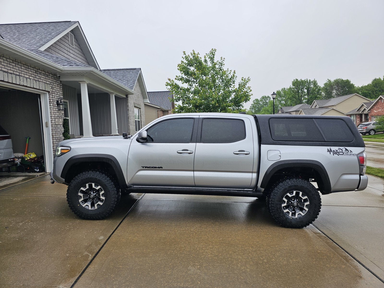

    I went skinny. 255/85/16 falken M/T on a TRD lift up front and iron man leaf spings.
    Eta, need to figure out tire pressure. Im at 36psi right now, but its also not a daily driver.
