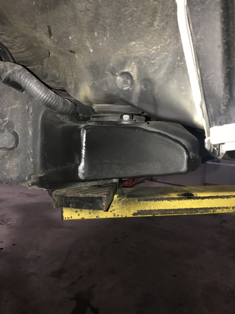

    when i first put on the 265/75/16 i had some rubbing that required removing my front mud flaps. what is CMC?

    i was tempted to try that route as well, but in the end went with the 255/85/16 Dick Cepek Extreme Country. I have always liked the KO2 for my applications though. If you do end up going that route please update us.
    Cormudgen- CMC=cab mount chop. I don't know what exactly it entails, but I wasn't willing to attempt it by myself. Most 255's avoid that though.

    I did it incase I went with a biggger tire. eheels and alignment will determine if you need a cmc

    I haven't chopped yet but will in the future, it definitely depends on the set-up alignment and wheels offset so far I haven't had any rubbing issues:fingerscrossed:
