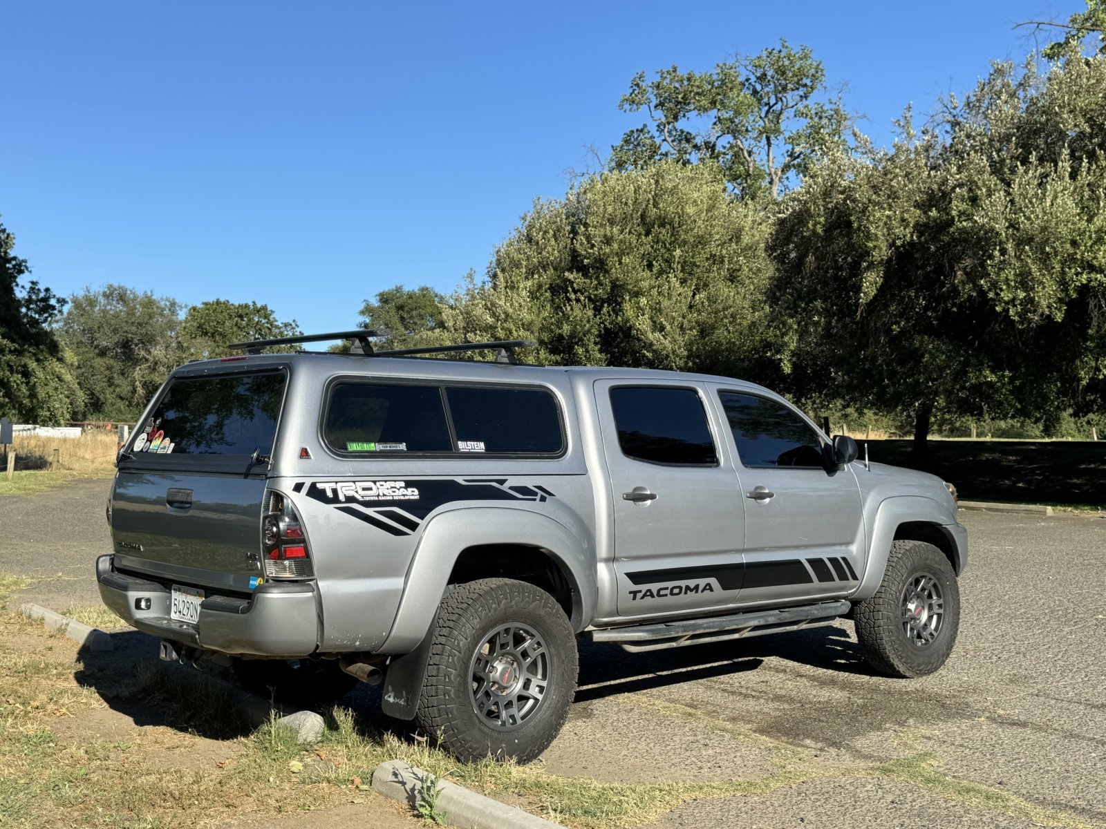

    More pictures of 255-80-17 wildpeak at4…
    I did notice about 1-1.5mpg drop after coming from a 265-70-17…but ehh, whatever.
    but now used to this look. Want to go bigger.

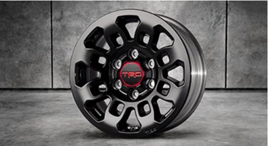

    Has anyone put 255/85 r16 tires on these Trd Pro wheels with stock suspension? Want to put some Falken Wildpeak A/4Ws on them. Anyone had issues with them on stock suspension? May add a ~2" lift at some point. Pics always appreciated

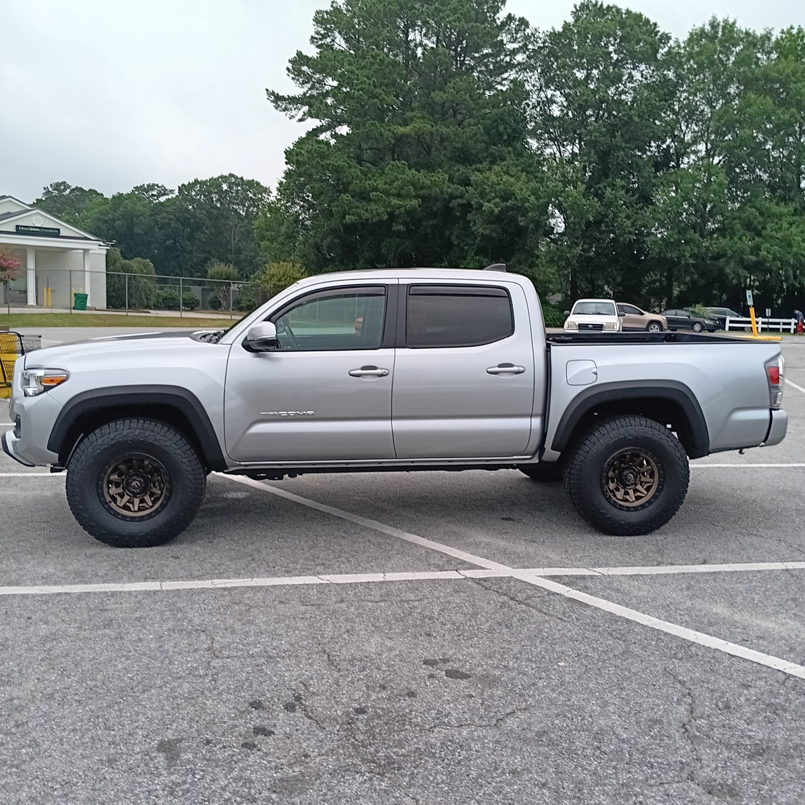

    Not sure the offset...i love my Falken WP AT4's, 255/85/16s...but, with new +1 offset Fuel Coverts, bronze not brassy, which I really love(nothin but chrome in ENC,not that it looks bad, grew up with it, just wanted to be different)... had to trim fender liner, and beat back pinch weld(wth is that???)...anyway, stock rims no rub...+1, rubbing full turn before beating pinch weld,lol, which is now a former rub...

    Stock suspension?

    Stock...yep...kinda looks level with heavier spare wheel/steelie combo,lol...stock leafs no bueno

    Looking at Toyota part site, they are 16 x 7 13mm offset.

    Meant to say the 16” TRD Pro wheels are 13mm

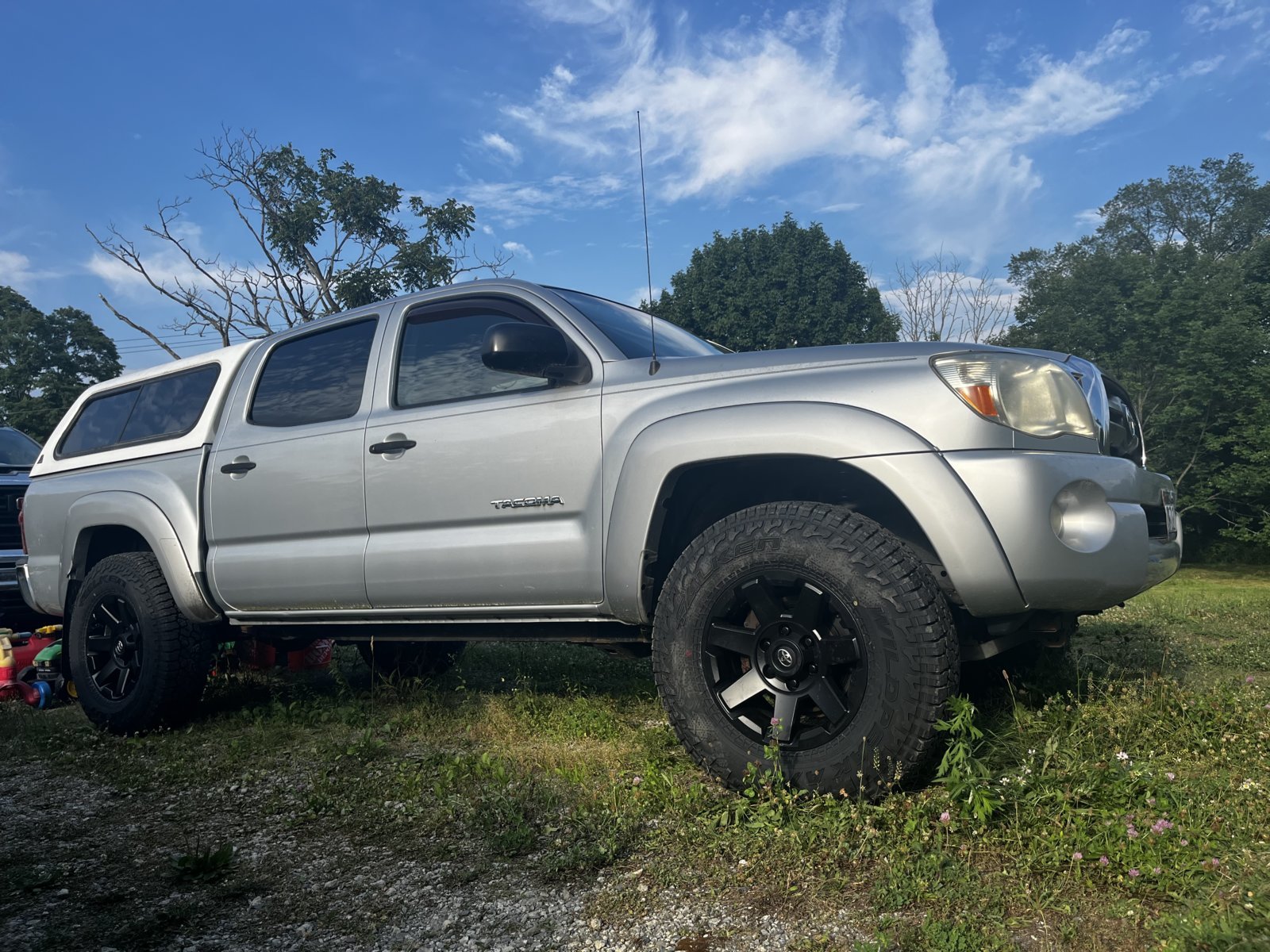

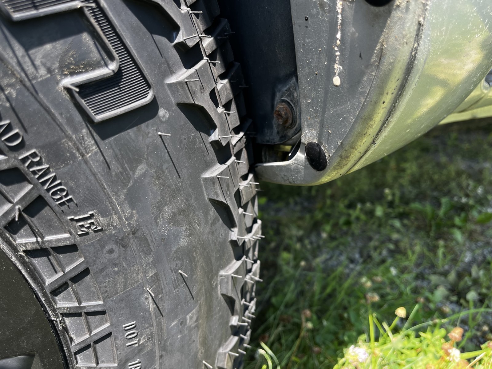

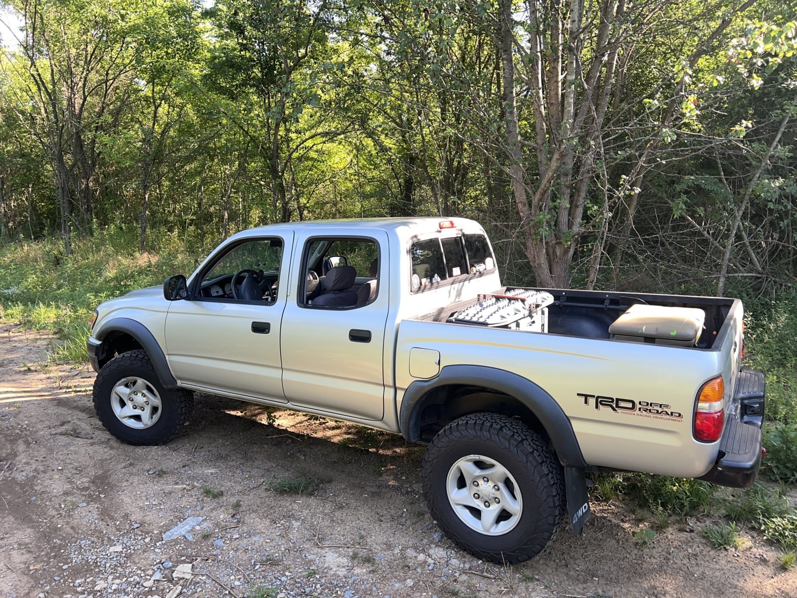

    255/80/17 Wildpeak AT3 on some 4Runner wheels, 3rd Gen suspension take-offs with super low mileage. Found that I need to replace front pass side wheel bearing, had a bit of play.
    Had to pull front mud flaps, and I’ll have to trim a tiny bit of the plastic over fender, rubs occasionally.

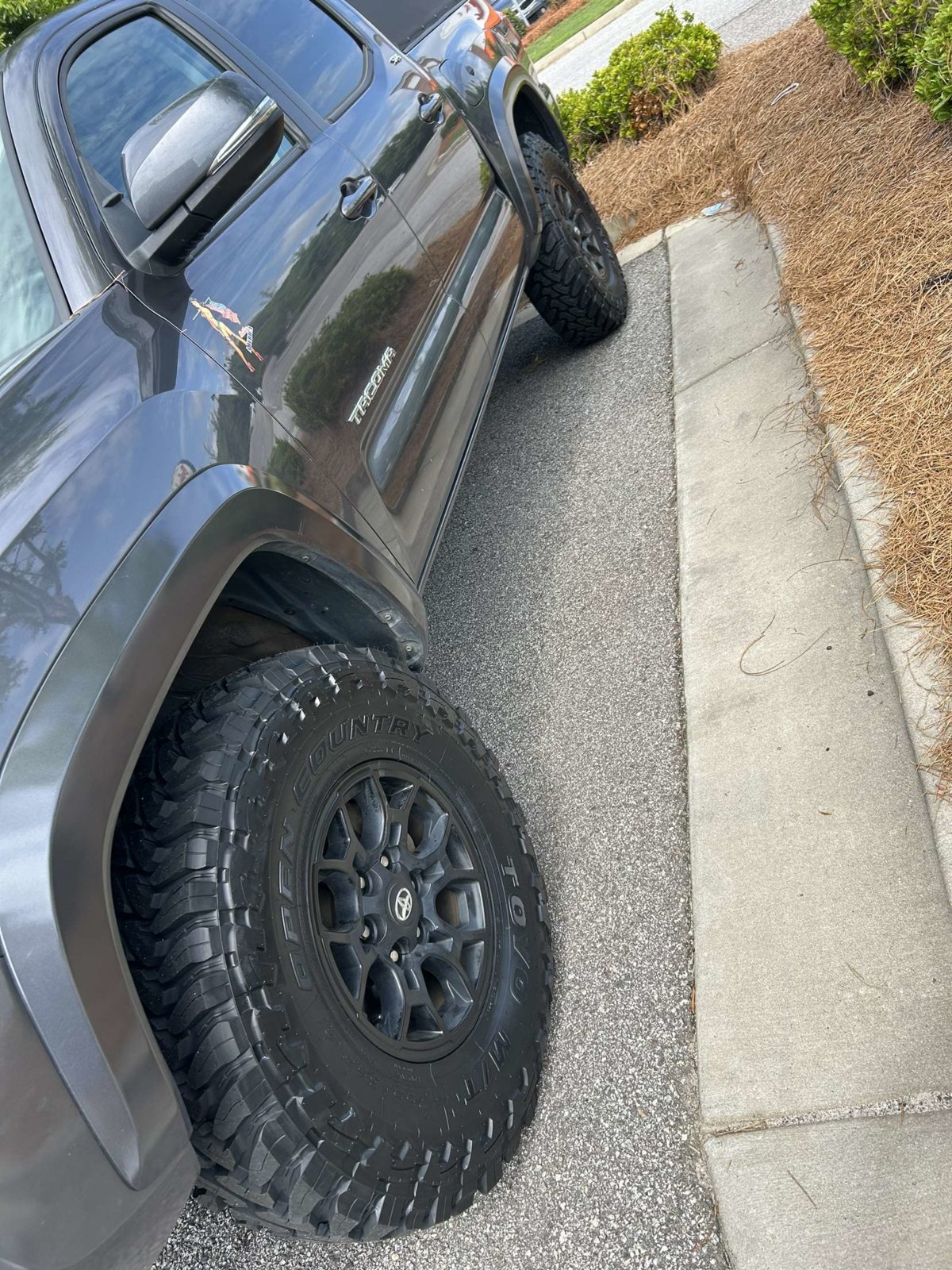

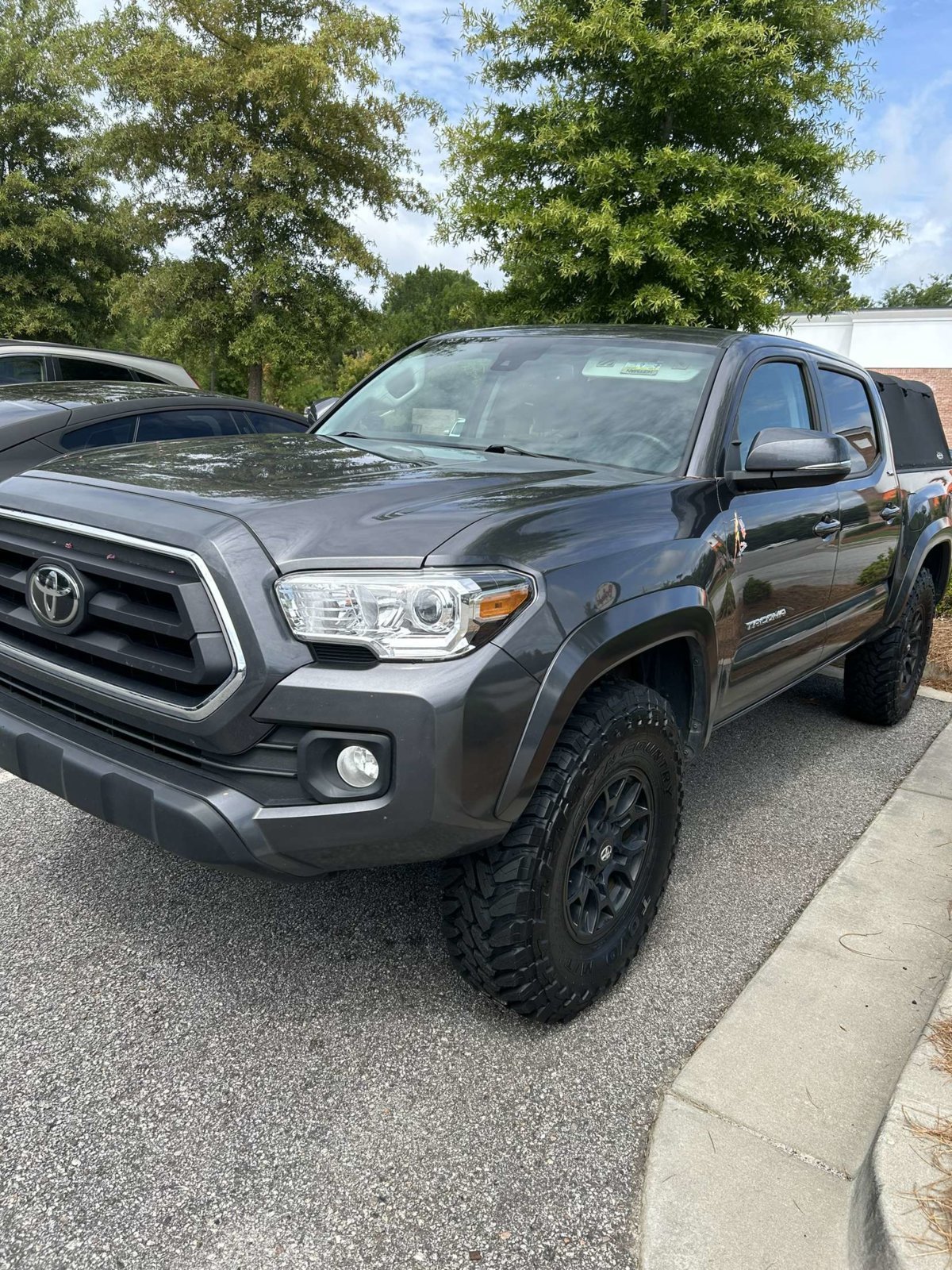

    Joined the skinny club. With some 255/85r16 Toyo Open Country MTs getting put on yesterday all stock suspension and wheels currently seeing how that goes. But for now, I can drive down to the crick and not spin tires quite as much.
