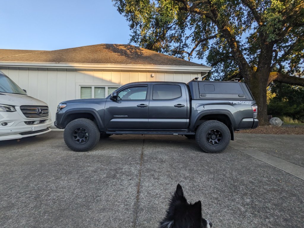

    Yeh, rock it Monroe...DIY..., I rent, so nowhere to DIY, i had the Big D, so controlled by $$$,lol...looks tight

    I have some family in New Bern so I know where you are. 5.29’s I got a few prebuilt diffs from ecgs they are in NC was an easy swap highly highly recommend. The 3.5 obviously has more power over the 2.7 but I thought my stock gearing with 4.30s were bad can’t imagine 3.90s especially with bigger tires/weight. I added a lift, bigger tires, and about 500lbs of added weight and it drives better than off the dealer lot. I still get 22-24 mpg and that’s with the 70+ speed limits over here and it’s not flat. OTT with a regear is a night and day difference. If I had the 3.5 I would probably go 4.88s unless you were planning some 35s or a really heavy rig. It cost me about 1700-1800 all in with me doing the work, if I was starting over re gear and a tune would be the first mods.

    Nice hell yeah I would definitely go need to get a trip going. I don’t have a ton of experience would be nice not going myself. At the moment i live in Matthews but closing on a house in Mooresville the 23rd of this month. Nice looking truck I have a similar lift bilsteins all around 1.1 in the front and icon stage 2 in the rear got tired of the saggy diaper look with the weight of the topper and gear.

    I NEED A TRIP... just sayin...no expert here...blocks in rear:annoyed:
