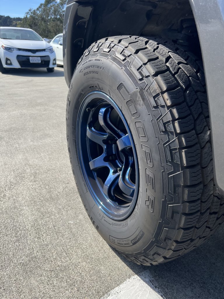

    I currently have 265/70/17 and am looking to go skinny to save some weight on the tire and recover some maneuverability.
    Instead of 255/75/17 (32.1”) I am thinking of 245/75/17 (31.5”)
    What are the pros of 255 over 245 and what are the negs for 245?
    I want to stick to a 6 ply tire. 10 ply is too much tire for what I use the truck for. The wife and I mainly do fire roads and light trails when we road trip somewhere. I mainly want better mpgs and better maneuverability so I’m thinking 245/75/17.
    It does limit me on tire choices but in 245/75/17 the Cooper Discoverer Road + Trail AT weighs 34 lbs vs the Hancook Dynapro AT2 Xtreme is 38 lbs which are my top two choices.

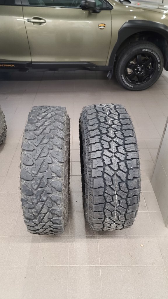

    Stock 21 TRD Pro and looks like my 255/85 16 top pics are the Falkin Wildpeak A/T4W, Yoko Geolandar M/T G003 & Toyo Open Country.
    Since I run on pavement 98% of the time, I'm hoping one of these improves MPG from my current 15.9 or so average. Think they all are good for traction in any weather.
    I do have a bumper, roof rack, bed cover, bed rack... so worried I'm going to get rubbing if I go w/ any of these. Anyone have same vehicle and tires?

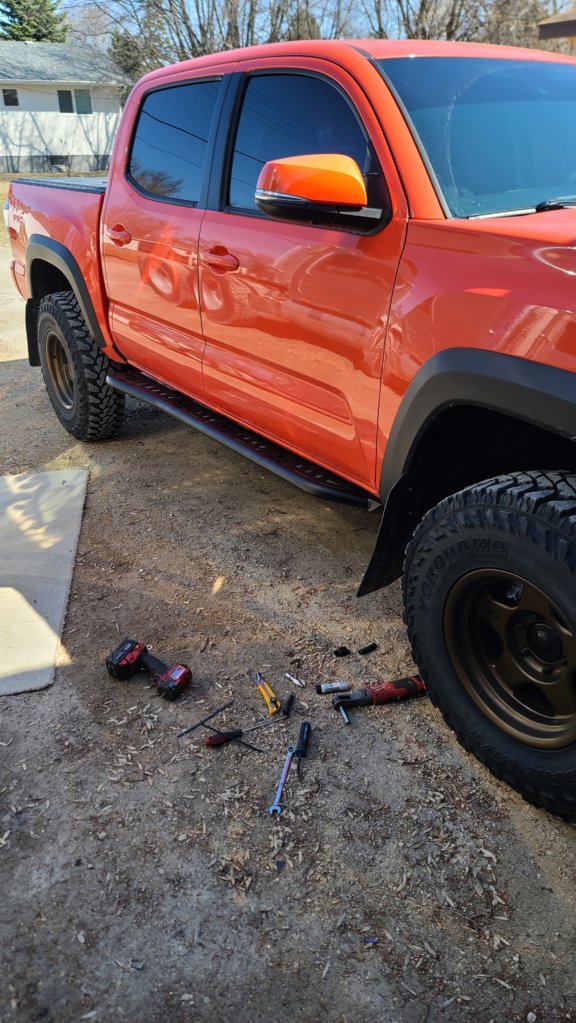

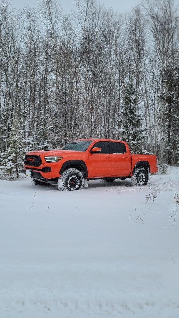

    Don't get yoykos unless you need mts. I had them and they wore like shit even with a good alignment and rotating every 5k km. Loud as fuck, manageable in winter but still sucked. I had tonnes of room on my stock 23 pro, even when I went to 16x8 - 25mm rubbing was minimal. I ditched the skinnies and went back to 285 at4ws. I get 1.5L/100 better on my atw4 even though they are 7lbs heavier. I'm in Canada but I paid 2200 for the yokos and 1567 for the falkens. Go with falkens.

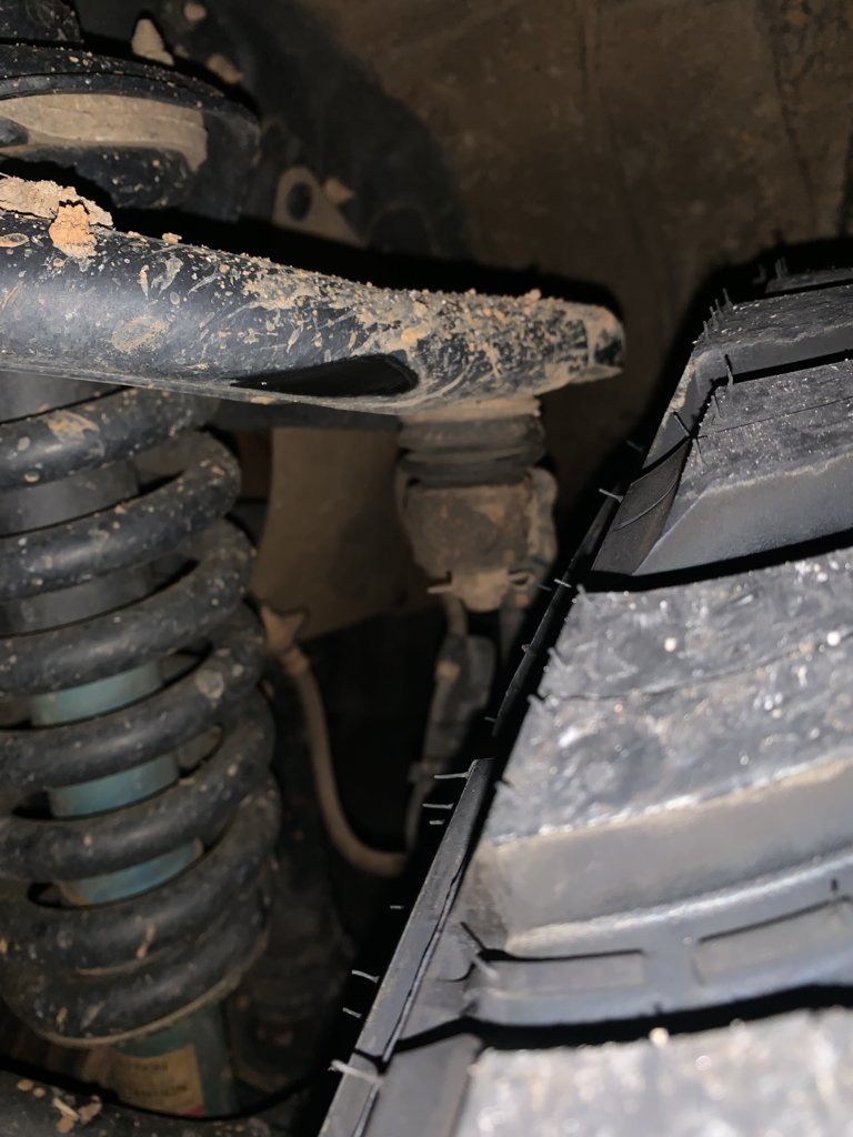

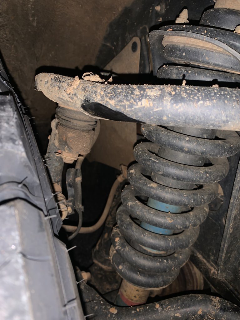

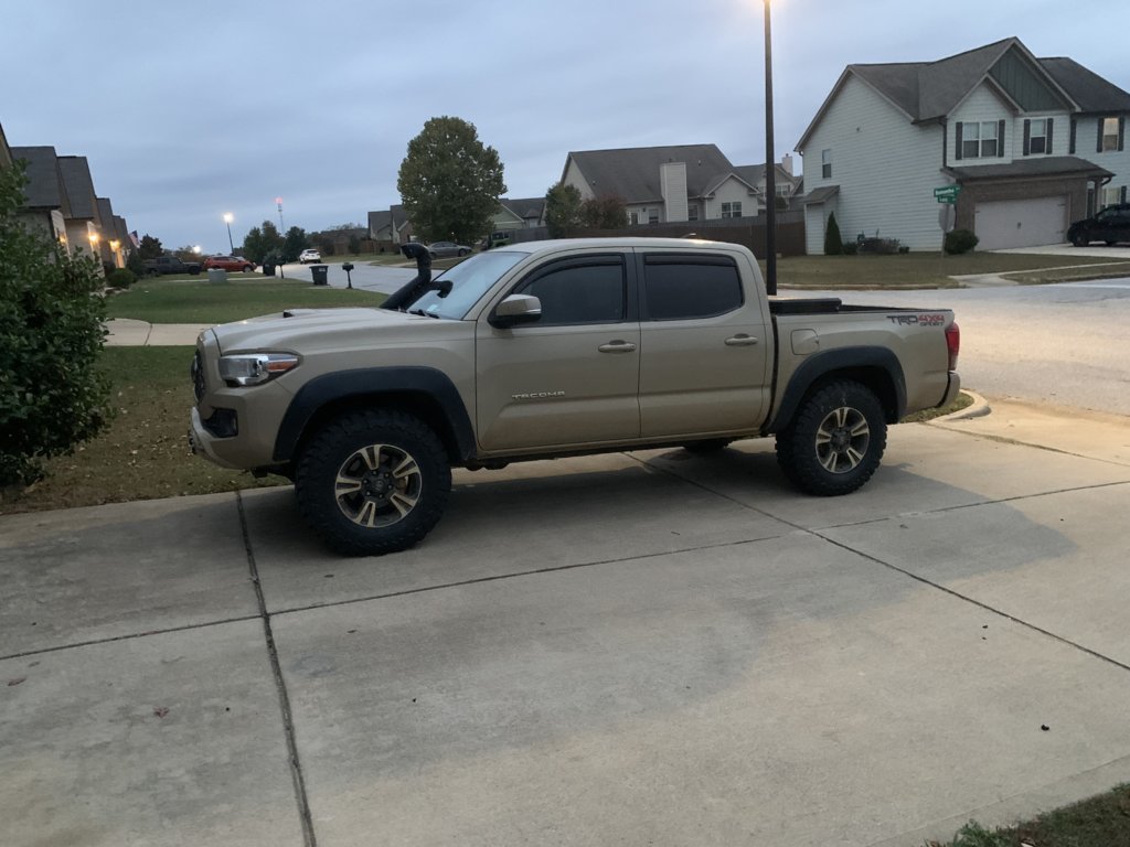

    Just got some 255/80r17 Toyo M/Ts put on today and the only rubbing I can find in on the front of the UCAs. I’m not sure if this is an issue with how the shop aligned them or if there’s another solution. I did notice while looking from the front they seem to be slightly canted inward. I do plan to get a full Dobinsons suspension in the next few weeks which will lift me 2” but was not planning on getting new UCAs. Not sure if this is an issue that can be fixed with a good alignment or something else. Other than the rubbing I love the look. They are loud as hell though

    I agree completely. I went from AT3W's to G003's then back to AT4W's. The Yokohamas were fun for a little while, and not that loud at all in the beginning, but then they started getting strange wear (despite good alignment and regular rotation) and got louder. Learned my lesson - for my use, AT's are best and MT's just don't make sense.
    Stock wheels without any spacers? I think adding a wheel spacer will solve this UCA rubbing.

    yes stock wheels. Is there any other solution that would solve this? I am getting a suspension lift soon but was not going to get new UCAs.

    Wheel spacers would already the "best case" scenario here (cheapest and easiest). The next option would be a wheel with better backspacing. The lift won't change the relationship between the tire and UCA because they're solidly affixed with the spindle and therefore lift doesn't give any extra space.
    Worth confirming your alignment, I suppose - what's your spec sheet look like? But I suspect if your alignment was off by this much you'd be experiencing poor drivability.
    Also, I don't think new UCA's would solve this problem anyway so don't be concerned that UCA's weren't part of your plan.

    the shop I took it to does not give me a spec sheet and I was concerned that the alignment is off it seems the front tires are canted inward slightly. I may have to find another shop to take it to and see if that fixes it.
