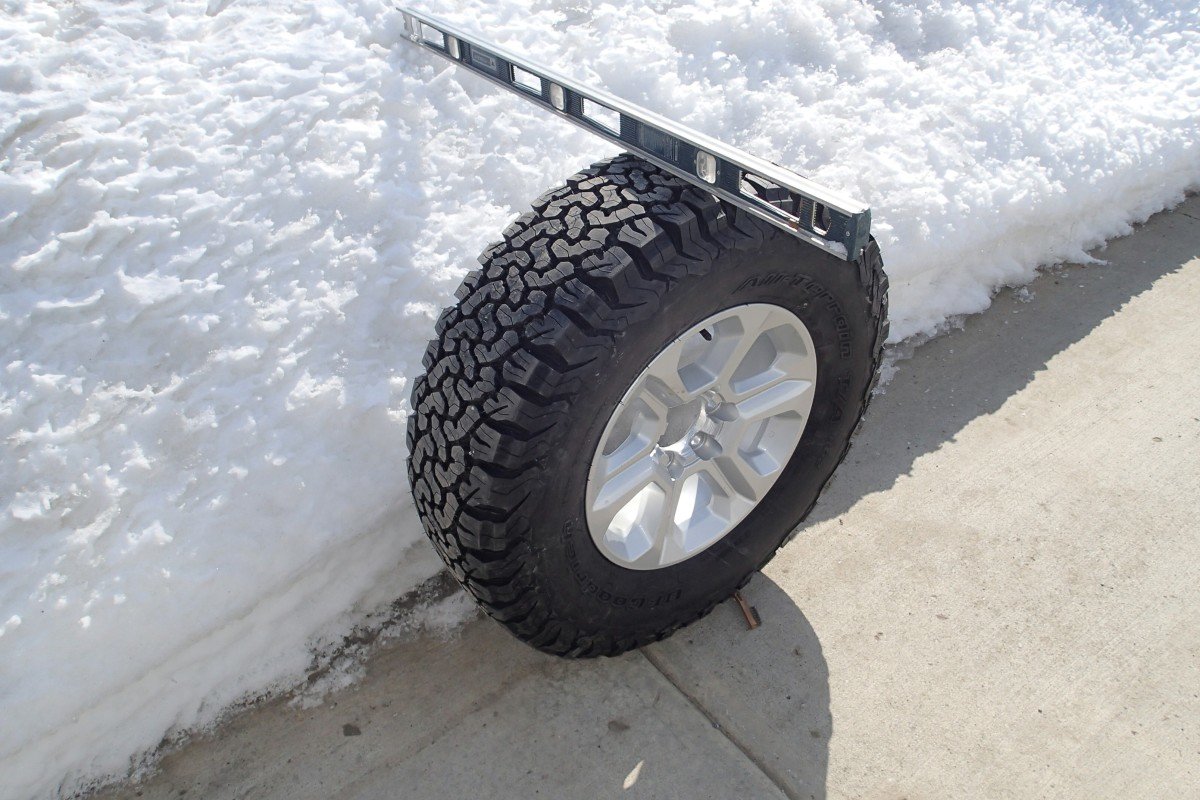

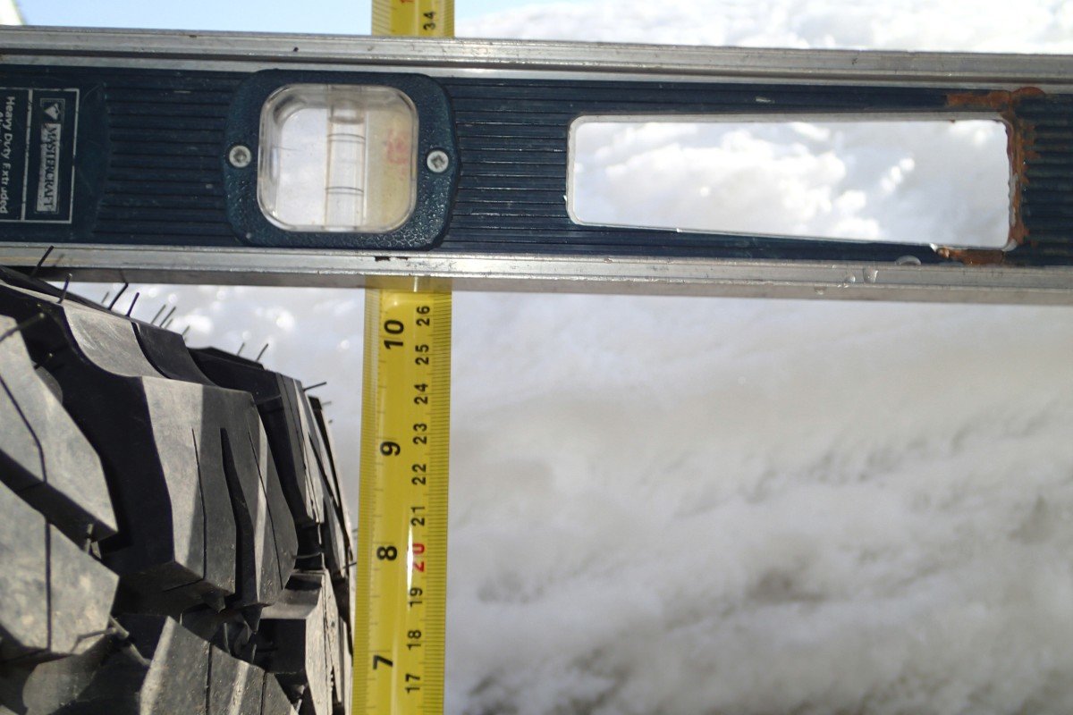

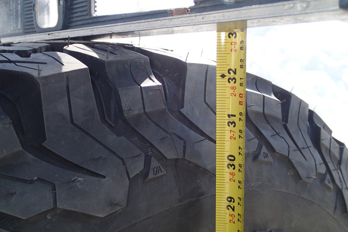

    This a great reference thread, thanks LadyRed. Here is some info to help others in their search.
    BFG KO2 34x10.5R17 on a 4runner 17x7 rim freestanding at 32lbs. Brand new exactly 33" tall and 10 7/16" wide. Mounted measurements to come in May.

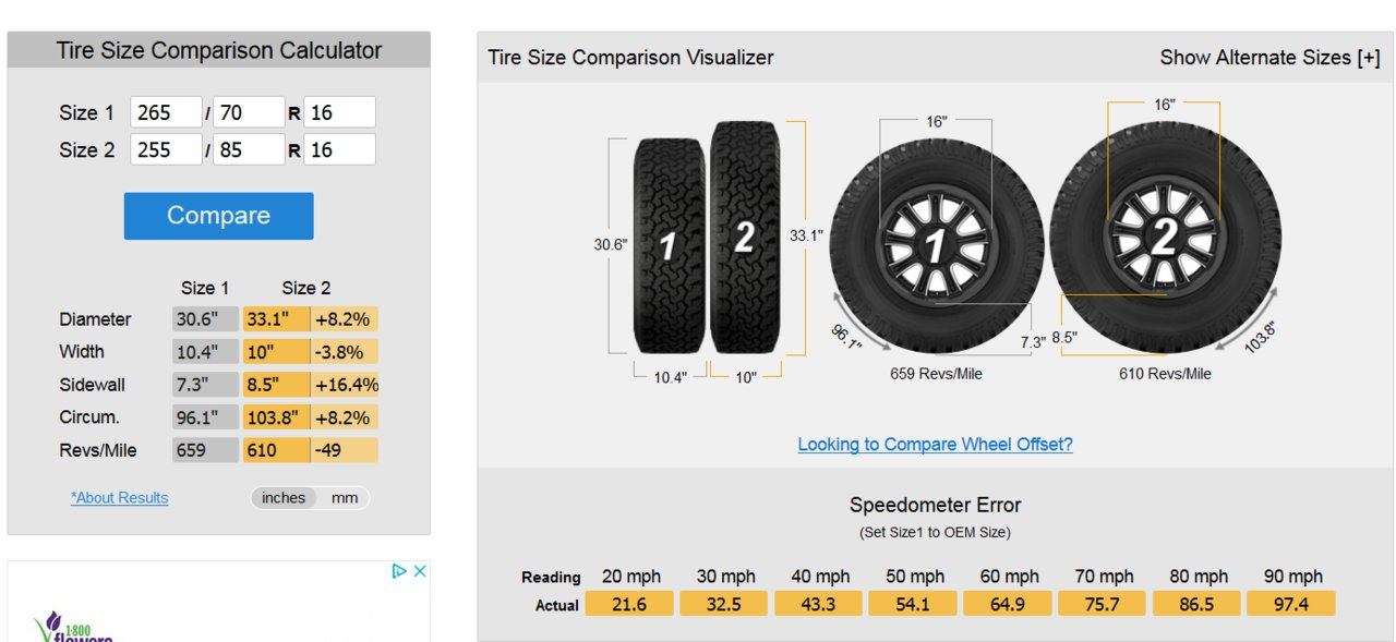

    I don't run that size, but from lots of reading it is borderline as far as re-gearing. Some folks don't, some folks do. Some folks who do wish they had done it sooner, some folks who do don't think it was worth it. I think by the time you get to 35" the re-gear becomes an easier decision in favor.
    If by recalibrate you mean the speedometer/odometer then for reference my 235/85/R16 (31.7") actually makes the speedometer perfectly accurate (they typically read a bit high with the stock size). So with a 33 you'd be about 5% off which is hardly the end of the world.

    If you have the stock 265/70/16's you will be looking at the below in regards to your speed.

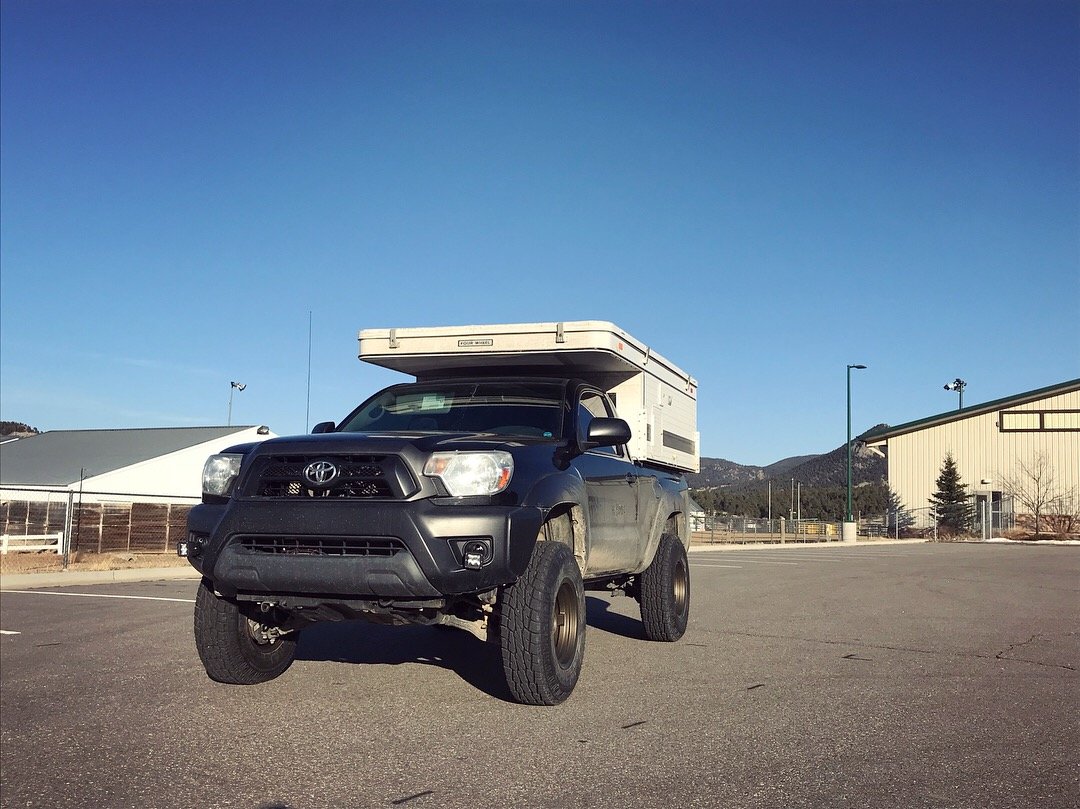

    What’s going on with those fog lights ? And sweet looking setup..
