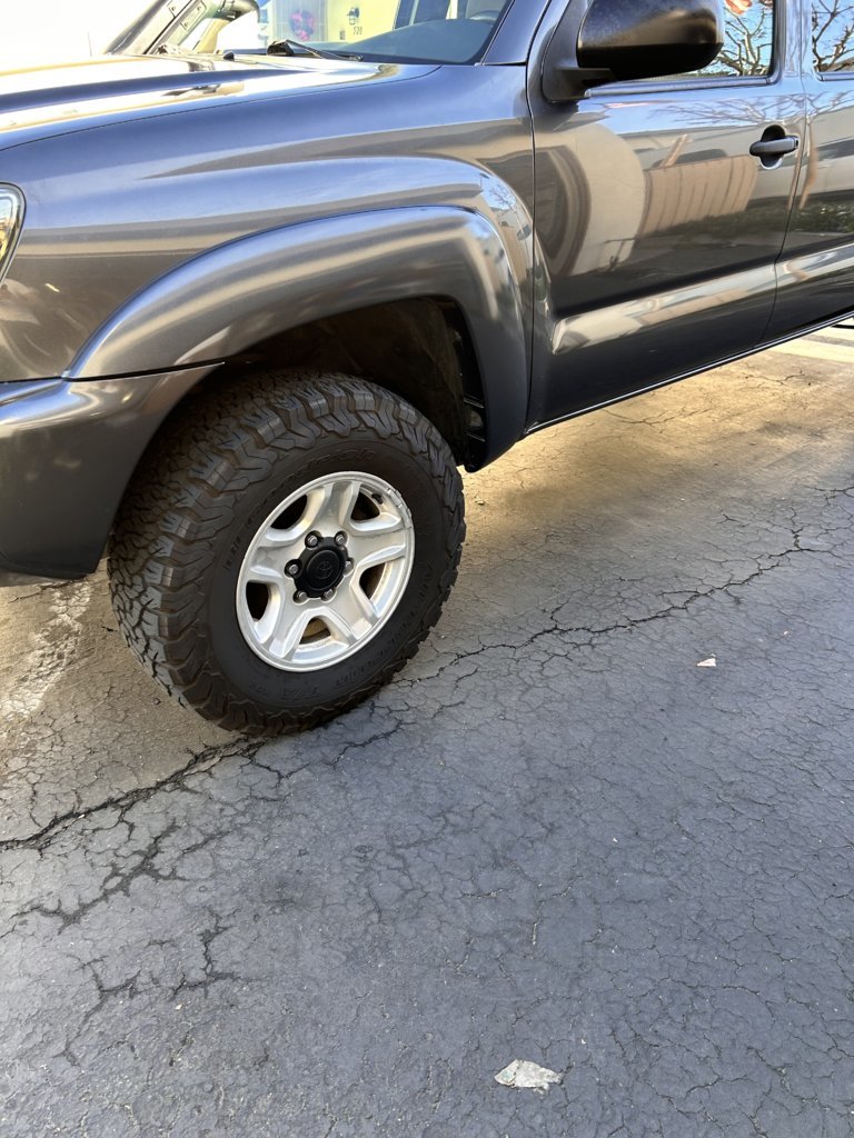

    Installed a set of 255/75r17 Goodyear Duratrac RT’s on my Tacoma today. I really like the TRD sport wheels. No lift and no rubbing. 2B7EED37-8920-4FF7-AF44-0356B5243683.jpg

    That is a great size option if you already have 17" wheels. Because that's been a "standard" size on Jeep Wranglers for years, there is a nice selection of both "P" and "C" load range choices.
    If you aren't driving on pointy rocks far from cell service, "E" range tires aren't worth the loss in performance and mileage.

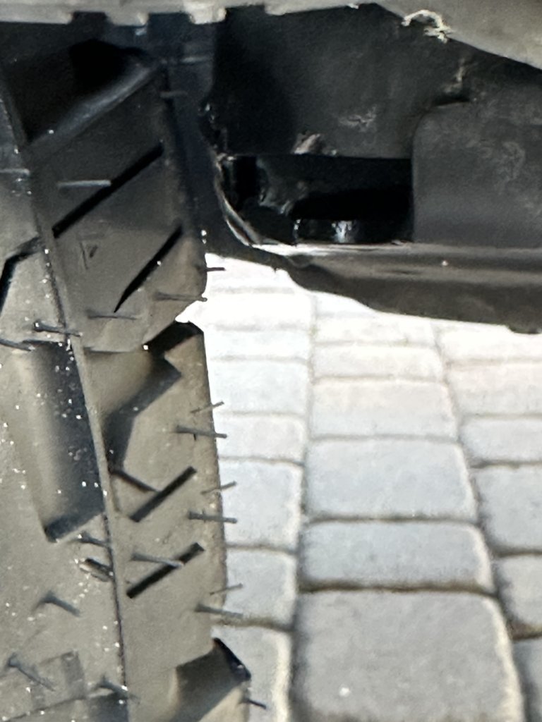

    275/70/17 w 2.5” lift…. Front drivers side is rubbing the frame. What’s the fix for that one?

    SCS 17” wheels
    17x8.5 -10
    Hitting cab mount

    The wheel offset is probably a big factor. You may be able to make adjustments to your caster to push the wheel further forward, do you have stock UCAs? Or you could do a cab mount chop...

    I just put on JBA UCAs over the weekend along with my Dobinsons struts I had rebuilt. Yestrday I had an alignment done. Maybe they moved the caster back.

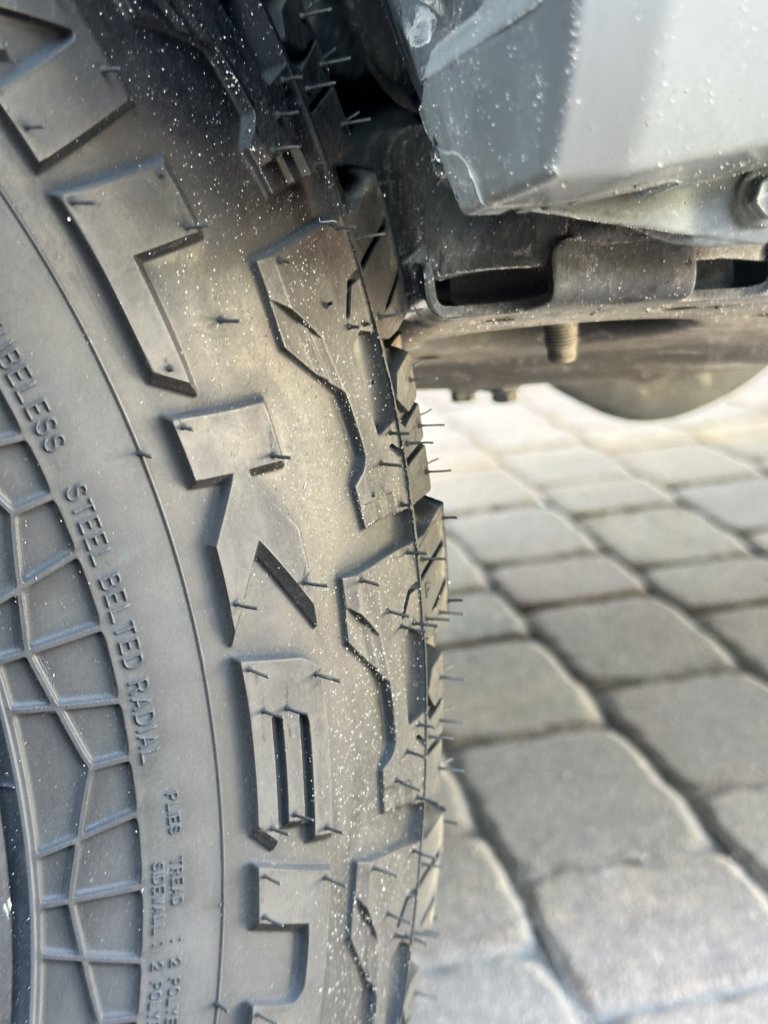

    Just now I took a metal hand grinder to the corner of the cab mount. It’s only rubbing on the wheel well side of the cab mount to about an inch in. I grinded that off which gives maybe 1/4 of clearance. It’s not enough metal gone to compromise anything. I’ll see if it’s clear now when I’m actually driving. Appreciate the input and maybe I’ll call the alignment shop and see if they can move the caster forward a little bit.

    Updated pic

    Post up your alignment setting and other will chime in. Most times, if you do not request max positive caster, the alignment tech will just try to match it side to side once it's in the green.
