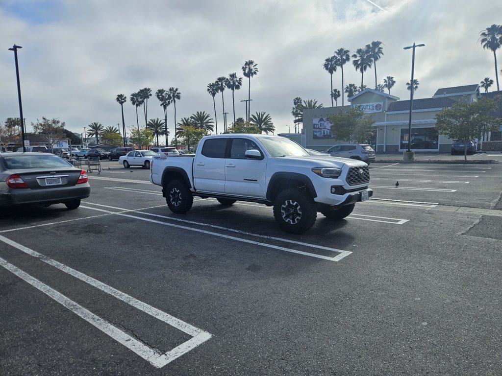

    Already had the pizza cutters. But here it is with 6112's (2" lift) and ome el1112 leaf pack.
    For all wondering, they fit fine before. Only rubbed 1 time(uca) in 4x4 full stuff, full turn driver, making a u turn.

    Looks awesome. Did you get an alignment done after getting the new tires?

    @Bravesfan1995 not after just the new tires, they fit/worked stock (for about 1.5 years now); however, I did have to get an alignment after wheeling them for a while...mainly after an unfortunate boulder incident.
    I also needed one after lift and new UCA's. But that's more for camber correction than fitment. There's lots of space in the wheel wells now....setting up for 35's in the future.

    Most don't rub. Some do, if you do it'll be minor (mud flaps, plastic in wheel well, or UCA at full stuff).
    Rim offset is largest contributor.
    Bravesfan1995 likes this.

    Then you'll look a lot like this

    White TRD OR too! Looks great.

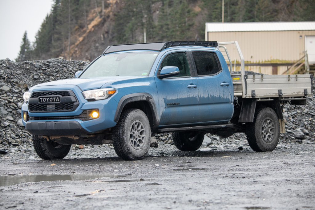

    TRDPro grill Southern Off Road roof rack Copper Rugged Trek tires Tyger side steps Ute Tray

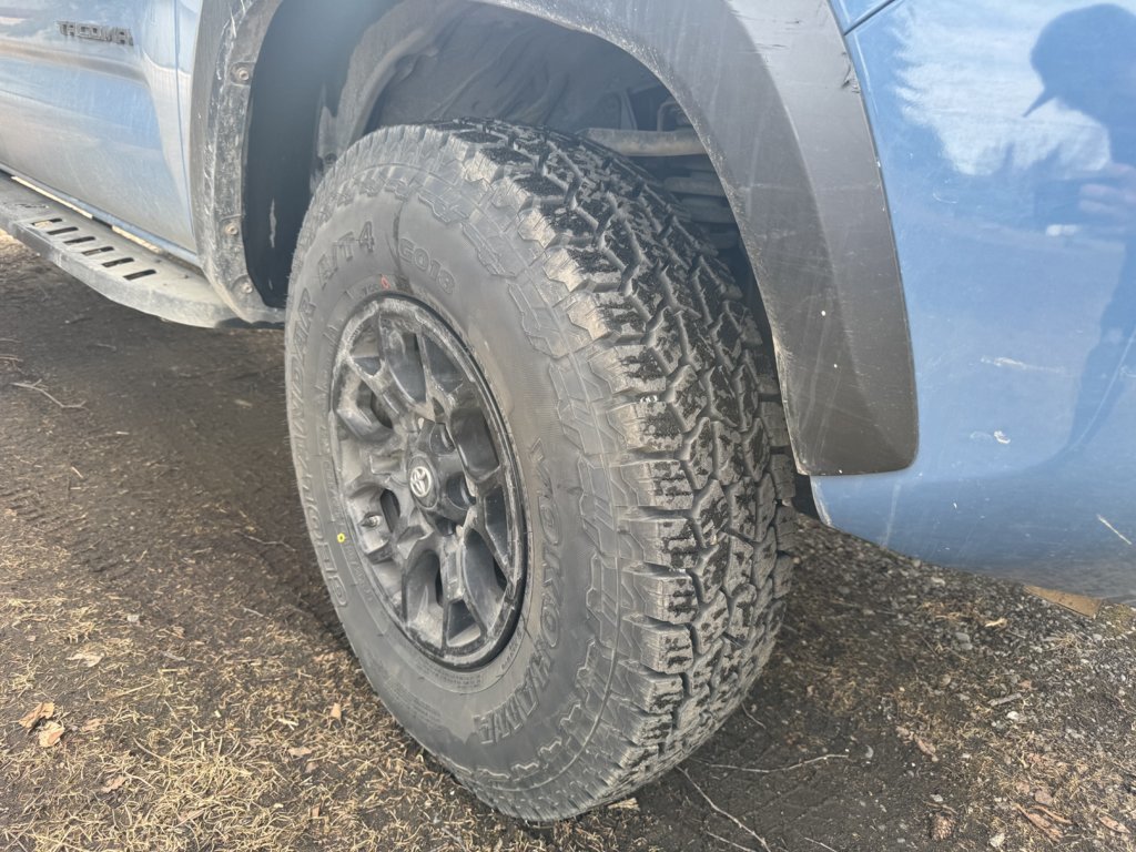

    Put some 235/85/R16 Yokohama Geolandar A/T4s on. Less aggressive than my previous tires but so far have done well on pavement and in heavy rain_DSC9504.jpg IMG_2669.jpg IMG_2668.jpg
