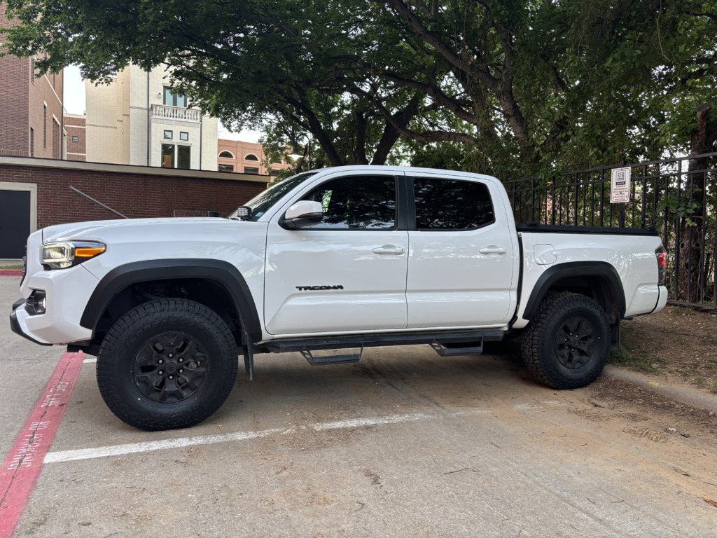

    No chopping required here. I have stock OR wheels though, so my offset is like +25mm.

    Did a thing yesterday. 255/85r16 Falken Wildpeak AT4Ws. Can definitely tell these are heavier and can really feel it under 10mph. After reading a lot of the posts on here, I came to the conclusion that a re-gear or tune wasn’t necessary. But now that I have them, I am having second thoughts. I’m curious- for those that have run these for a while, do you just get used to it? Is there any concern for long term damage/wear to the transmission struggling a little in lower gear? Overall, I love the look and the smooth ride. The tires absorb all the little bumps that I used to feel. I’m happy with it, but I’m just curious what other’s thoughts and experiences are.

    I've had my 255/85r16 Yokohama mud tires (55lbs each) for a little over 3 years. 4 months after tire install I got the OTT tune, which helped with acceleration and daily driving.
    Despite carrying 1,200 pounds of additional weight (armor, bumpers, recovery gear) I still do not feel the need to regear. Truck drives great on the highway and in 4lo. I would recommend starting with a tune if the tire weight still bugs you in a few months.

    Did a thing yesterday. 255/85r16 Falken Wildpeak AT4Ws. Can definitely tell these are heavier and can really feel it under 10mph. After reading a lot of the posts on here, I came to the conclusion that a regear wasn’t needed. But I’m curious- for those that have run these for a while, do you just get used to it? Is there any concern for long term damage/wear to the transmission struggle in lower gear? Overall, I love the look and the smooth ride. The tires absorb all the little bumps that I used to feel. Happy with it, but I’m just curious what
    I worry about tuning and voiding warranty… I know everyone says “oh they would never know” but I have reason to believe otherwise.

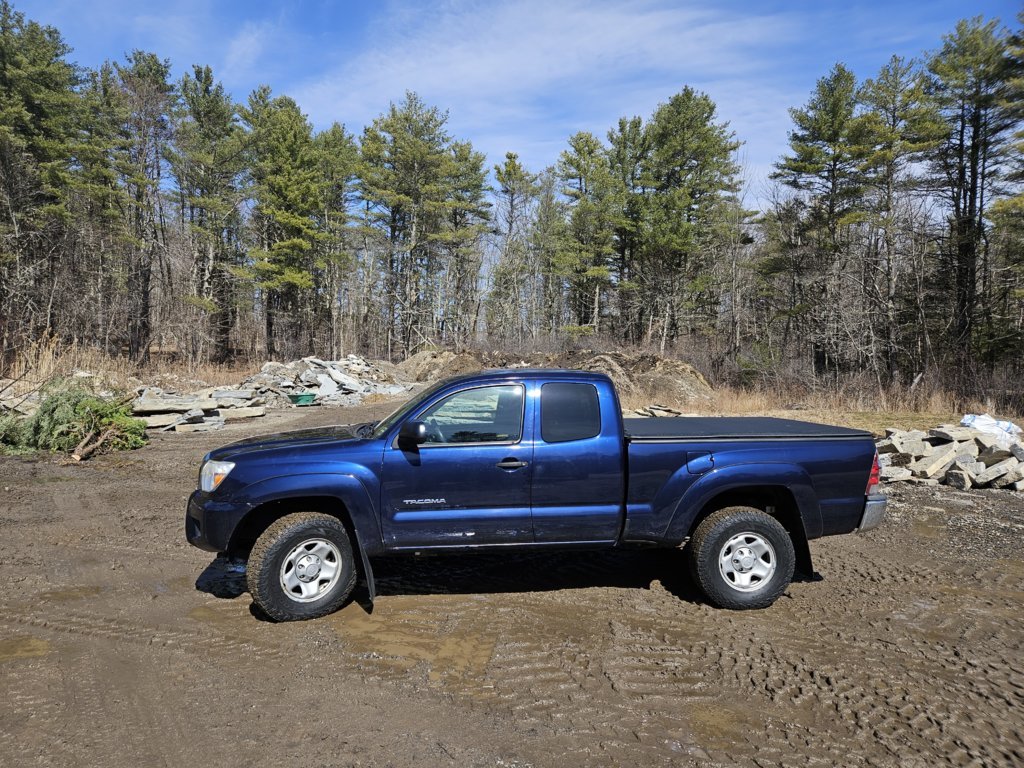

    I'm running them in stock 245/75/r16 and I'm pretty happy. They handled bad snow and slush really well and I feel totally in control in heavy rain. I don't go off road but they're great on rural gravel and bad pavement. I just had them on some real back roads at speed and they never broke loose, but I have basically new tread after 5 weeks or so so that might change over time. They look great to me, more aggressive than you might think with a lot going on in the sidewall and a nice deep tread.
    My only concern is that there's a bit of pulling or sticky feeling with these tires. The truck tends to want to follow the grade or tire grooves in pavement, which can feel like I'm holding the wheel over very slightly but firmly to prevent wandering. It's not a straightforward alignment problem IMO (happens on either side depending on road conditions) , and I'm not experienced enough to know if it's a caster/camber issue that could be fixed with alignment adjustments, but it feels directly related to the tires. Maybe something in the steering system needs to be tightened up? Unclear.
    I'm still going to look at getting into a skinny tire this fall to prepare for winter, but I'm happy with the Coopers so far. This picture was the day I got them put on.
    I don't think they come in 235 but they might have a 255 available?

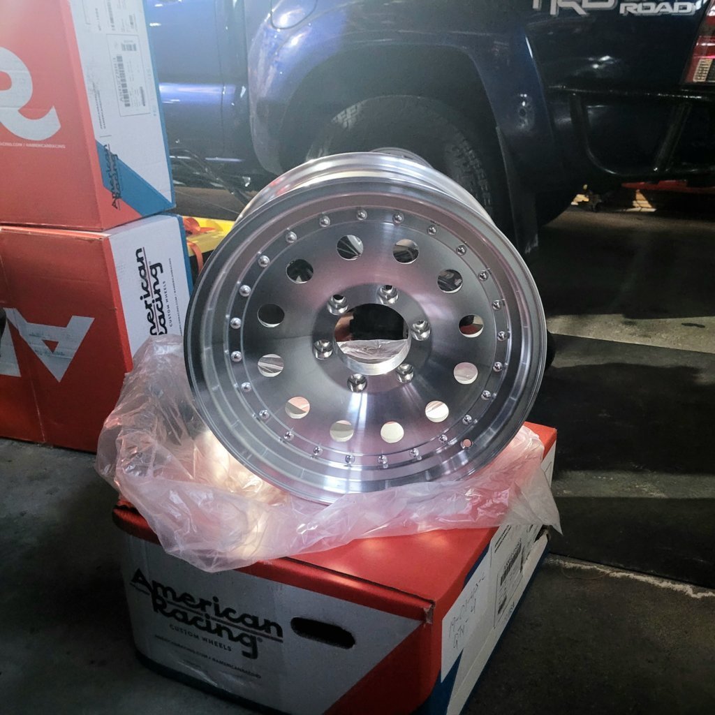

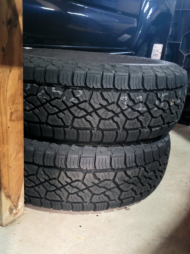

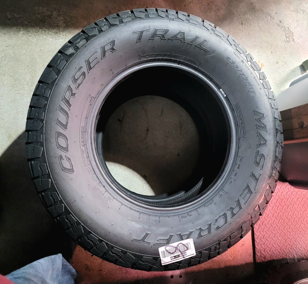

    so...i ran kumho at 255 75 17 on fj cruiser alloy on my 2004 t4r, and hankook at 255 75 17, for 8ish years lifted on 5100/ome, loved it, barely any rub too, 15mm offset
    now for my new to me truck, i am going to run mastercraft 255 75 17 at, courser 115t, loved the tire and brand going back 20 years, had the old ones on my jeep tj
    these are going on american racing outlaw 17x8 et0, after i do my lift
    great tire size!! i like them more than my current wildpeaks 265 70 16 (feel too wide, heavy, and worse in snow and rain)

    probably the load range E on them - they are heavier than lower ply
    you should prob run them at like 30-32 psi max
    i wouldnt worry about trans or gear issues with them
    havent heard anyone do that particulary for these sizes before
    i have run 255 75 17 for about 10 years and theyre low friction and lighter than most other tire upgrades for these trucks, in load range 'not e'
    tehcnically right now i have beefy wildpeaks, 265 70 16 and they seem a lot heavier and more drag than the 255 75 17 im used to

    They are C, but still heavier than typical passenger load. Good advice on the PSI...didn't think about that. I can probably play with that until I find the comfortable spot for cruising. Also, good to know that this size is comparable to the 265s. The wildpeaks in 255/85r16 are 58lbs ea, and the 265/75r16s are 53 lbs ea, so not much lighter. Would make sense that the weight feels about the same. I think I'm just not used to the weight difference from stock is all. Now that I've had them a couple of days, I'm getting used to them. It's not like I hear my tans whining, just more sluggish to get going. Comparing this to a buddy who has 33s on his 4banger 2001 ranger, he had whining from his trans until he re-geared.

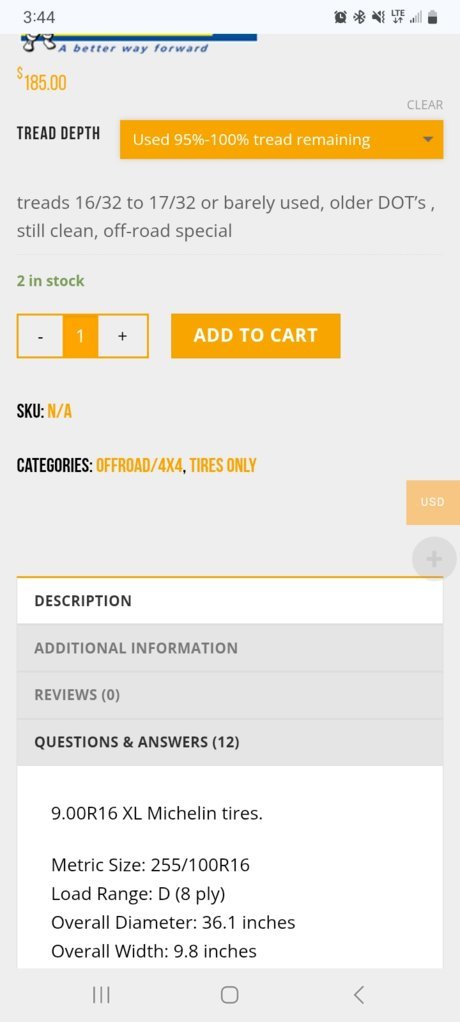

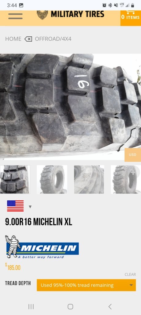

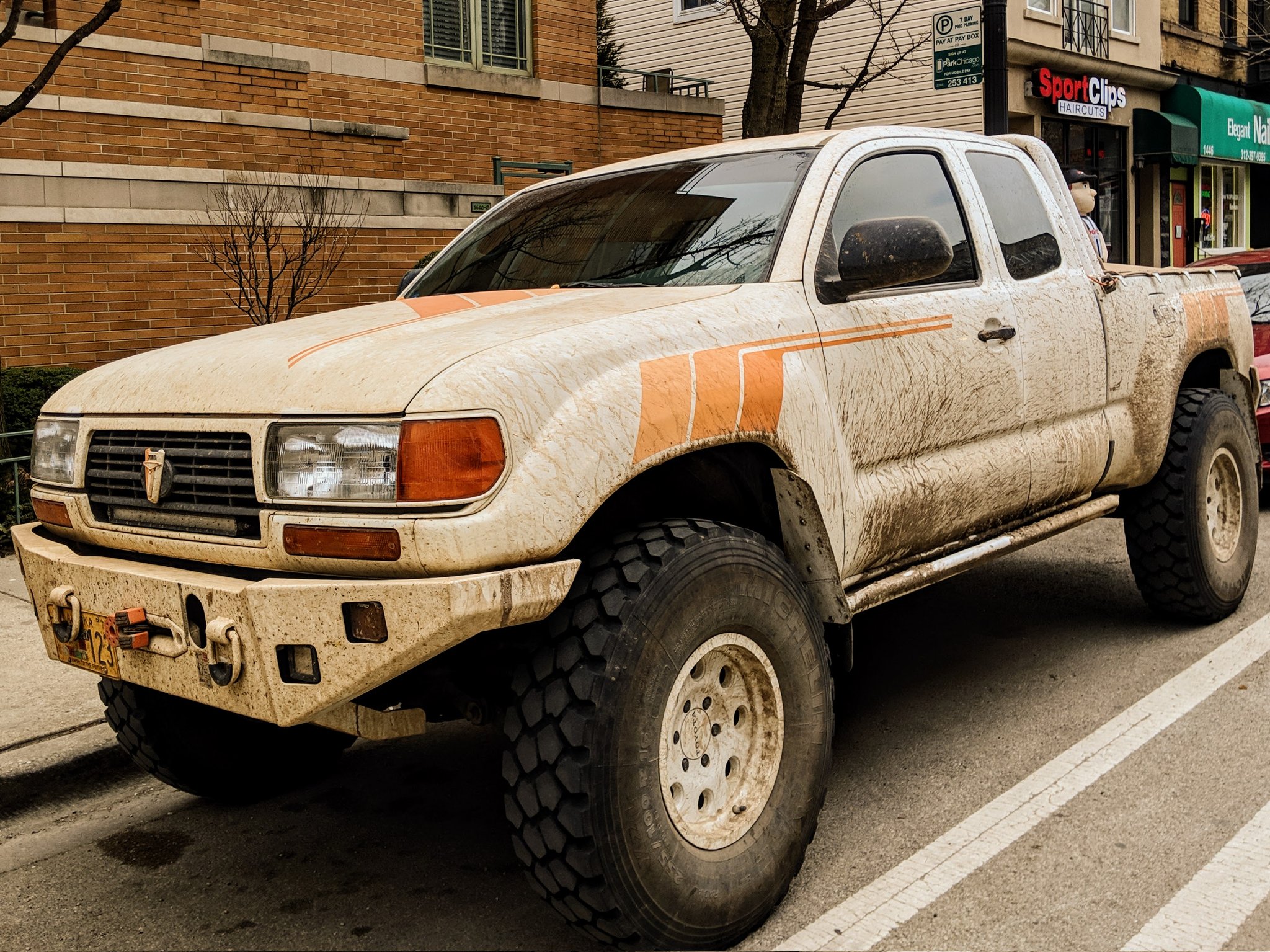

    guys.. hear me out. 255/100r16 36.3" Michelin XZL All-Terrain Radial Tires

    Only almost 90 pounds each

    Almost as much as the price. If you can find a set, they go for around $1k each.

    They can be had. It's on safari trucks and military vehicles. I'm sure they would be great for a dedicated Off road truck. Haha

    Never heard of that brand, but that is the size I'm looking at for my next set. And go from 16 to 17 to fit bigger brakes. How much do those weigh?
