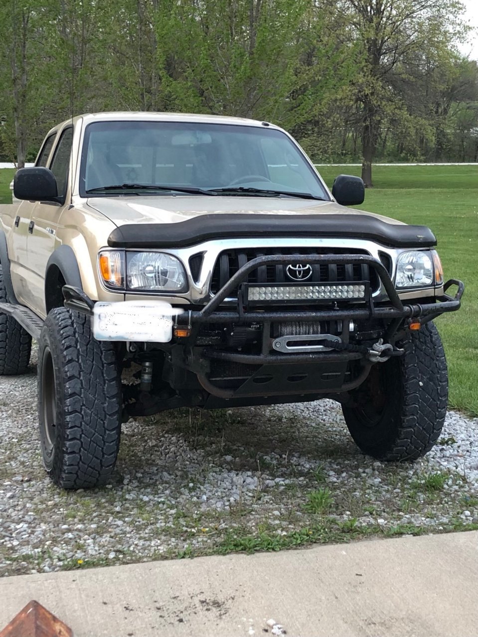

    ome 882 billy's dakars 255-80-17 STMAXX SCS F5 some other random doodads
    255-80-17 stmaxx (17x9 scs f5 for backspace reference)

    Looking Good. So a 9 inch wheel is not too wide for a 255/80/17 tire?

    I don't think most are recommended to be over 8.

    I think I would prefer it on a 8.5 or even 8. But these wheels were local and cheap and I wanted to give it a shot.
    Cooper recommends 6.5-8.5

    What are the cons? The tire is more likely to slip off the rim?
  16. May 10, 2018 at 11:28 AM
    #836
    Humboldt_Homie
    Humboldt_Homie If you're not first, you're last.
    Jul 27, 2016
    #193081
    437
    16 TRD OR DCLB
    Bilstein 6112 front, 5100's rear with blocks, camburg UCA, 17" XD's with 285/70/17 AT 3's and a blackout front grille.
    Do you know the cons or reason why they would say don't mount them on 9 wide?

    You don't usually go wider than recommended rims because:
    1 it affects the footprint of the tire
    2 you can blow a bead, especially when aired down
    3 you expose your rims to damage from rocks and curbs
    I'm sure there are other reasons but these are enough for me

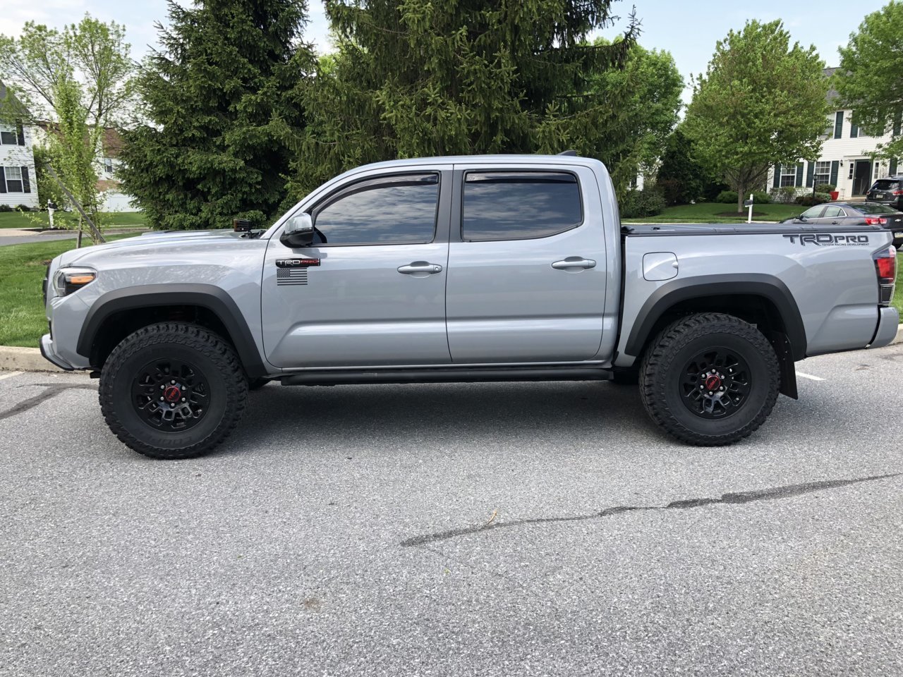

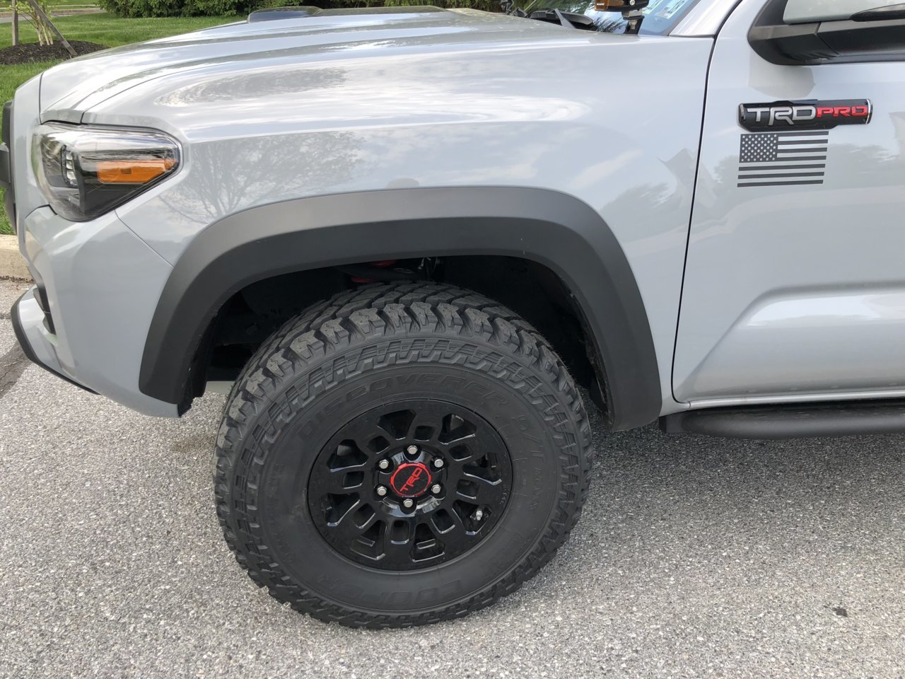

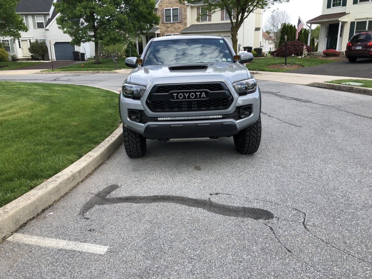

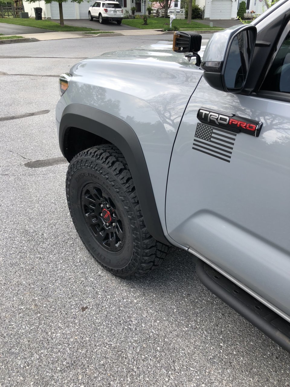

    Got my skinnies today! Was supposed to get MC Courser CXT’s but due to a shop error I got ST Maxx’s for the same price. Win! Close to doing the Toyo’s but couldn’t pull the trigger. E709C144-009E-4D30-B039-53EF1C310080.jpgC4D65D09-70D5-4501-AED1-E2847B428BA4.jpg BD52E4E3-3B38-4F91-8BE6-E612A1EC3C40.jpg4788D6F0-243D-4CCF-9264-18196ED153BD.jpg
