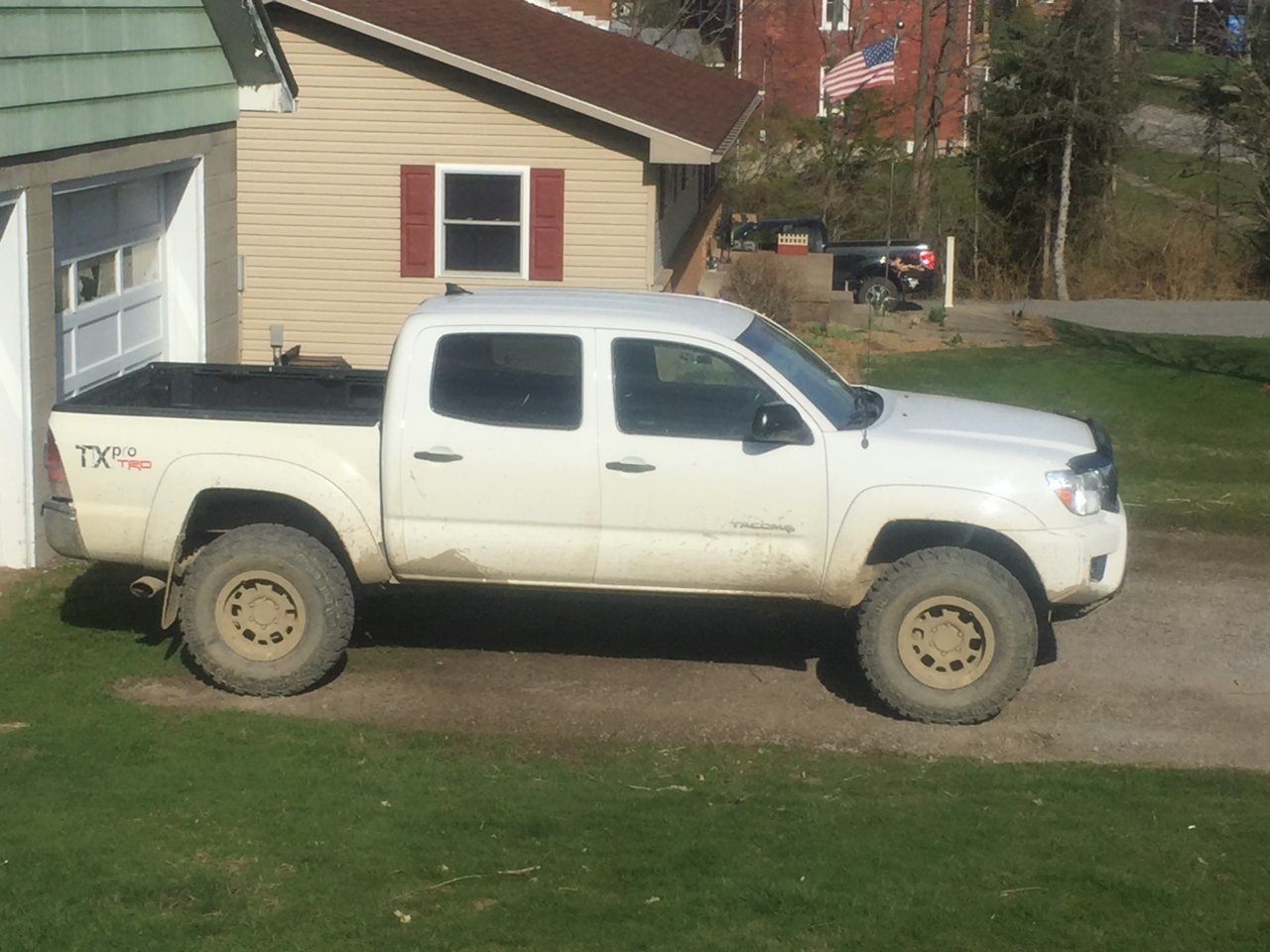

    I need a little help. I have DC EC 255/85/16. I have some minor rubbing even after removing the mud flaps up front. It appears I am catching a little bit of the fender flare when I am turning and stuffing at the same time (turning into driveway). I am trying to figure out whether alignment or trimming is the best option moving forward. I like my alignment and handling.
    Set up- OME 887, Nitrochargers, OME Dakar Rear, SPC LR UCA, DC EC 255/85/16, TRD 7.5x16 w/ 4.4-4.5 bs from what i have figured out anyhow.
    Any help is appreciated!

    It looks like you need more caster, I have a similar setup and no rubbing but my caster is about 3.5. Make sure your alignment tabs are maxed out to push the tire as far forward as possible.

    I hate to pay for a re-alignment, but if that avoids additional trimming and allows me to run a mud flap i would prefer that route. Is there any chance or rubbing on the bumper by adjusting cam tab to max? I don't really understand alignment at all.

    I understand that some people have issues with rubbing on the front bumper at max, I've got a ARB so it isn't an issue for me. If you do rub you can always back them off or its a good excuse to get a new aftermarket bumper :D
    https://www.tacomaworld.com/threads/how-to-do-an-alignment-at-home.252256/
    This is at home alignment stickey in the suspension thread.
    I'm no expert by any means, I learned a lot from reading posts on different problems with rubbing and lifts it seems that every truck is different.

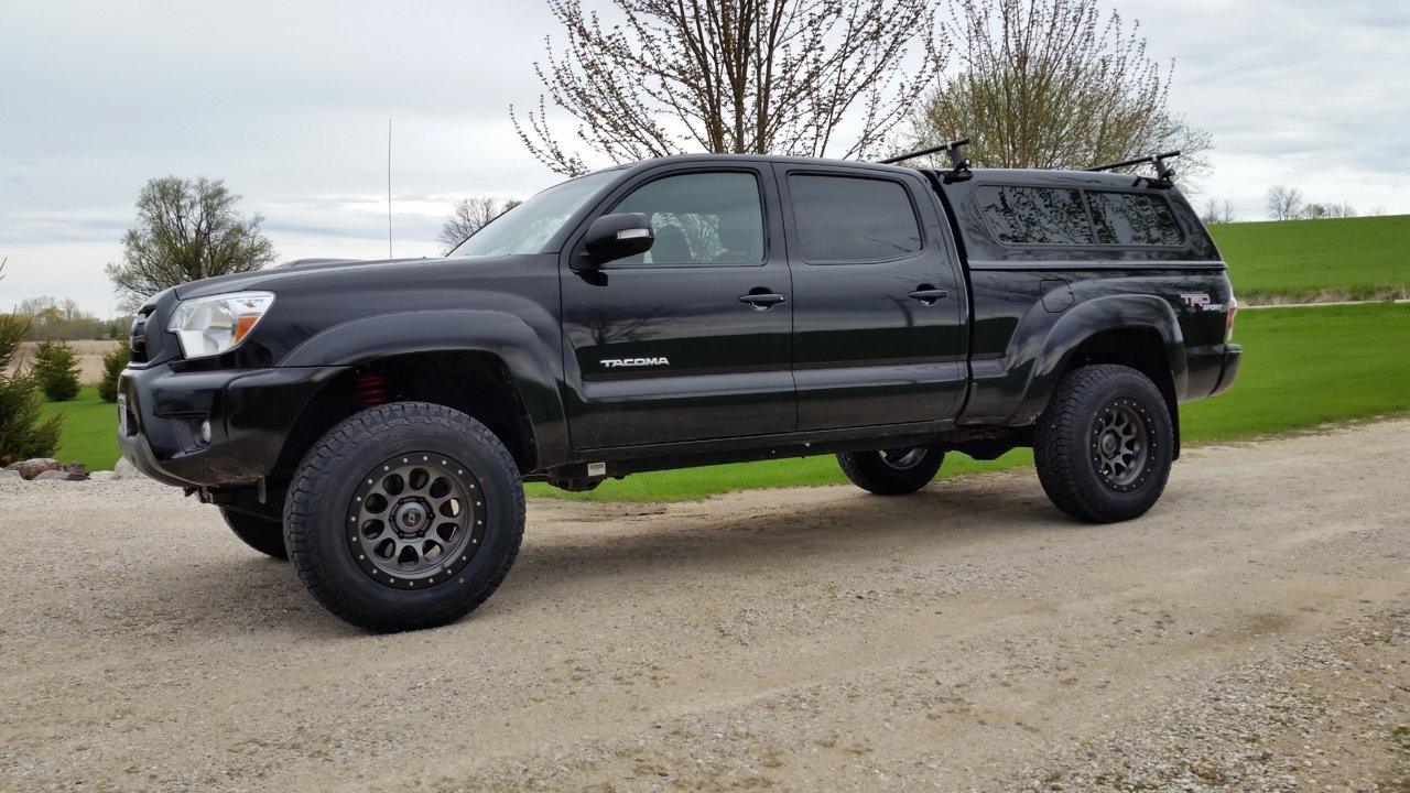

    255/75/17 with Ray10s, TRD Pro suspension, with 1/4 inch spacer up front. Rear is 3 leaf progressive with over load left in. 20180512_171558.jpg
