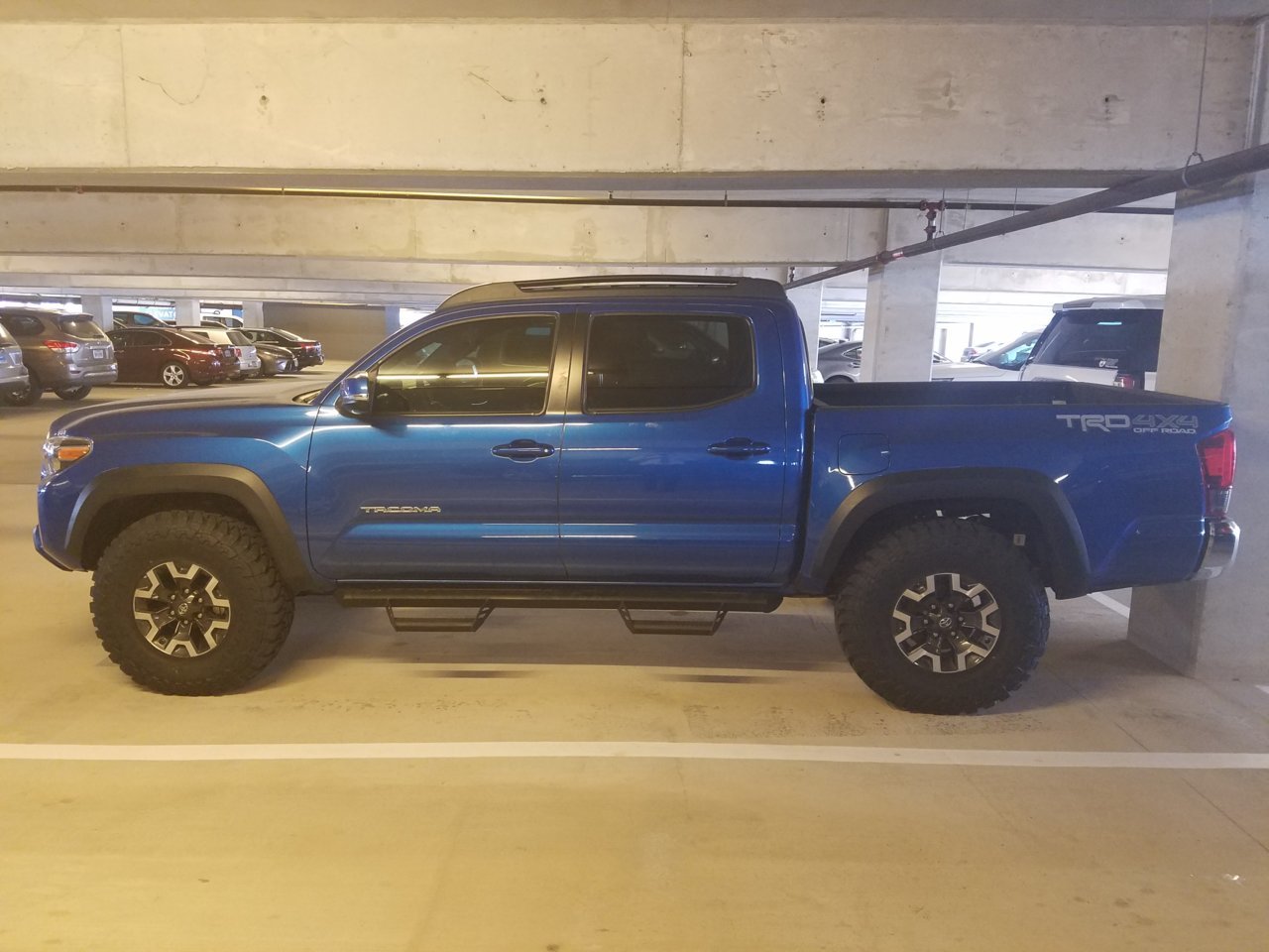

    255/85R16 Toyo Open Country MT, Customish bed rack, CB radio
    Just ordered 255/85R16 Toyo Open Country M/T's from Discount Tire. Should be in Today or Tomorrow. Will upload photos once installed.

    It is done. 255/85R16 Toyo Open Country MTs. Zero rubbing or clearance issues for town driving. Ill test full suspension cycle next weekend and then take it offroad that week.

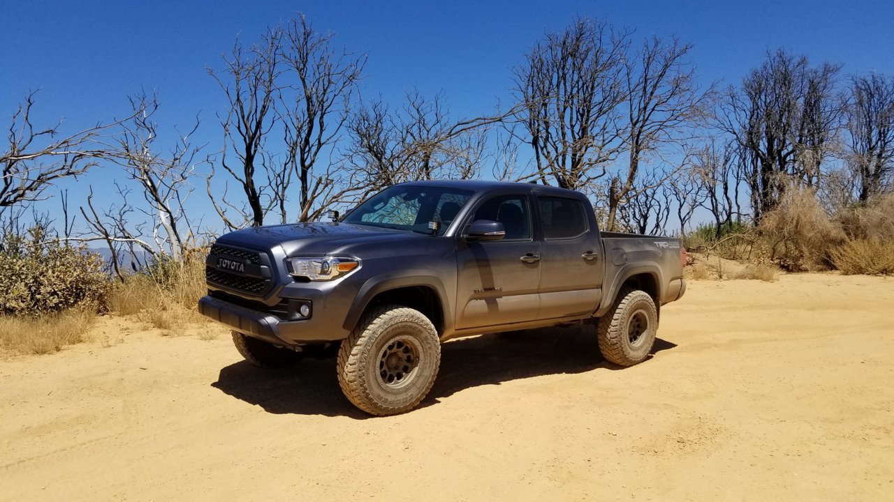

    255/85/16 ST MAXX on Ray 10.
    OME 888
    5100 all around (at zero setting in front)
    Medium Dakars
    No rubbing yet but I haven't taken it through anything technical requiring 4x4.20180805_141757.jpg
