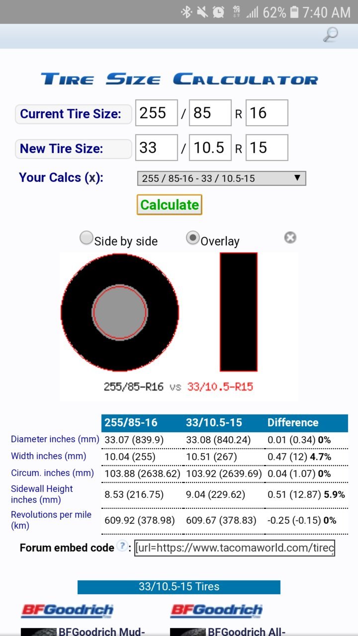

    pretty damn close to actual skinny dims

    33x10.5x15 is definitely in the skinny class. For 15s, it's either that or a 31x10.5. That's why I mentioned maybe bumping up to a 16" rim if you wanted something close to a 32, which seems to be the odd man out for off road tires.
