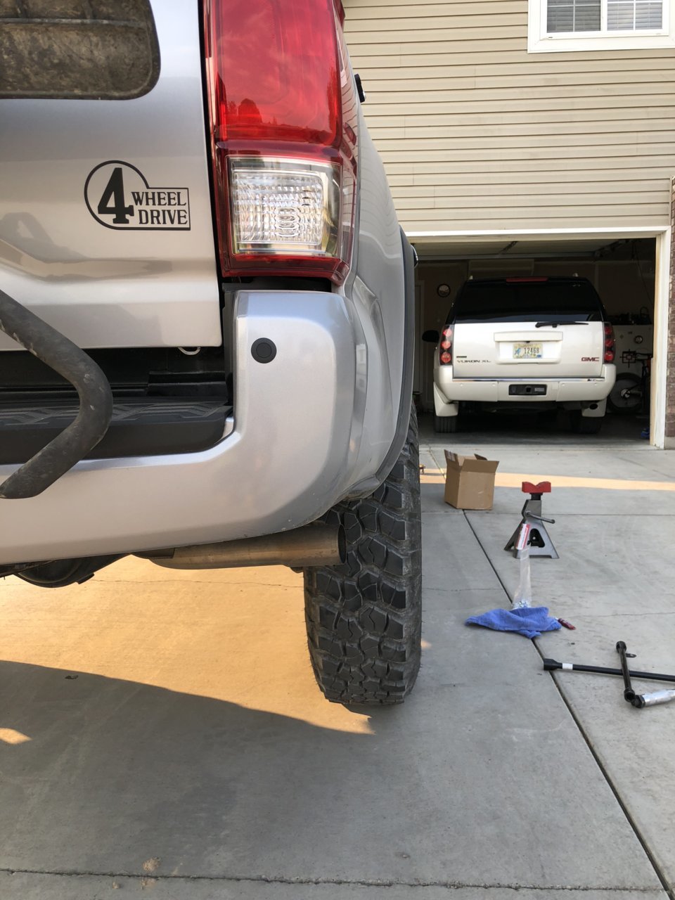

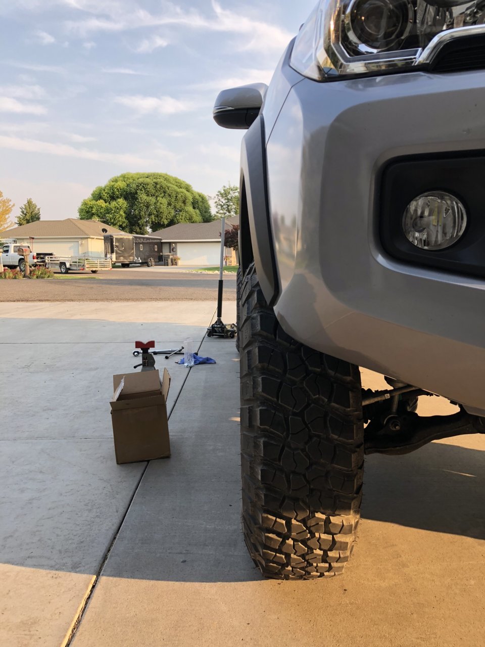

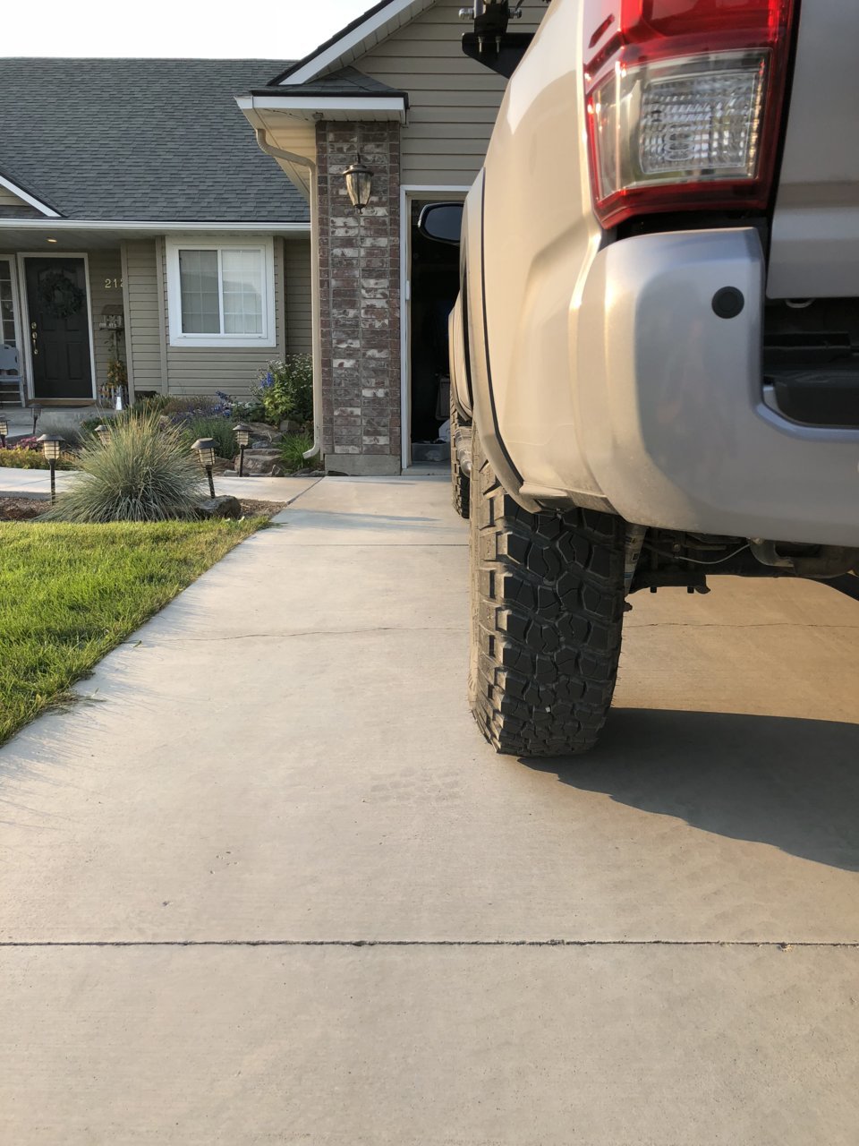

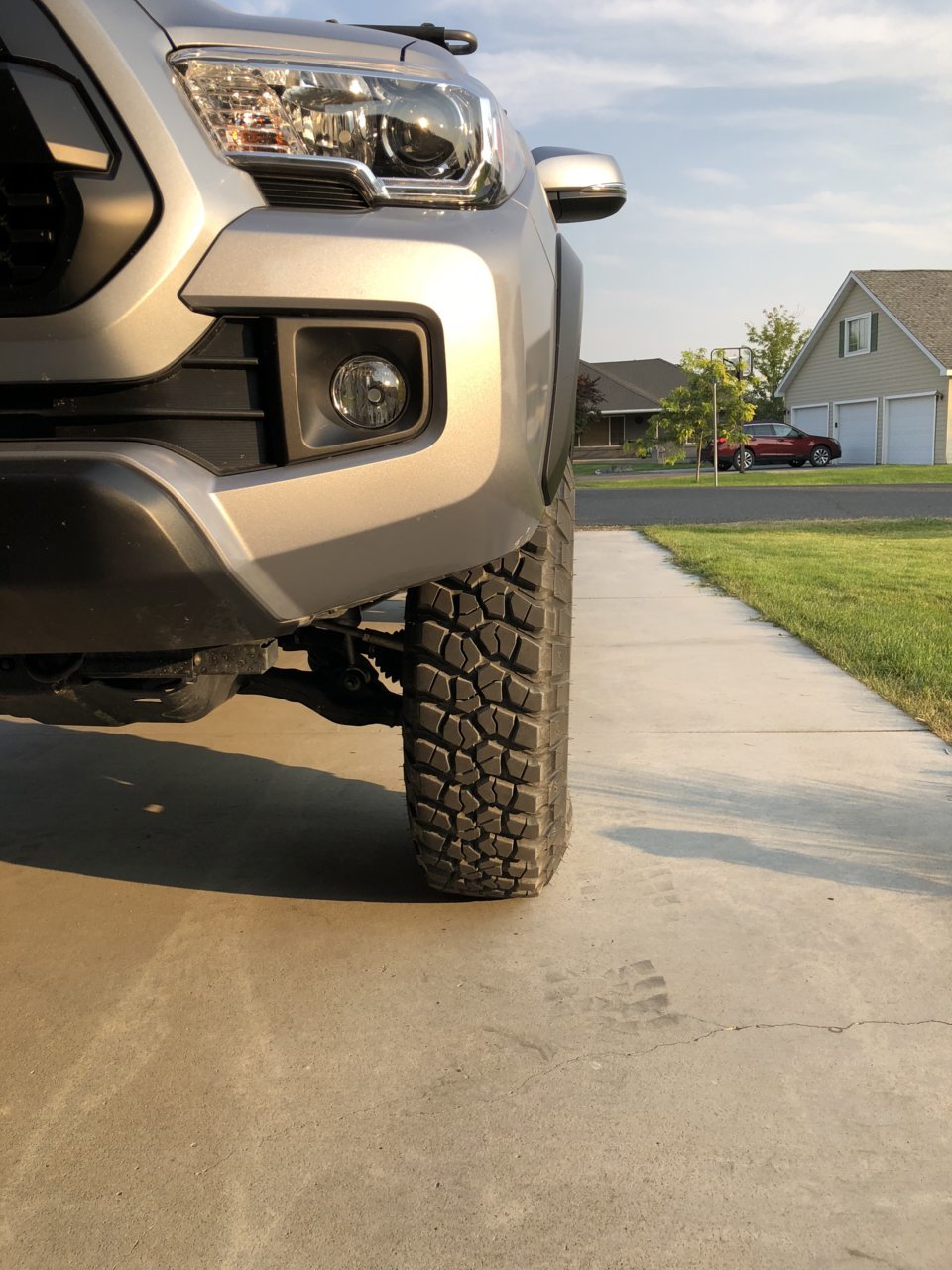

    For people that wonder about spacers???
    1st pic Bora 1” spacer front
    2nd pic Bora 0.75” spacer
    3rd pic Bora 1” spacer rear
    4th pic No spacer rear.
    They where not done scientifically or perfectly but you can see the difference
    MY50cal, Dan H and 2BeersPlease like this.
