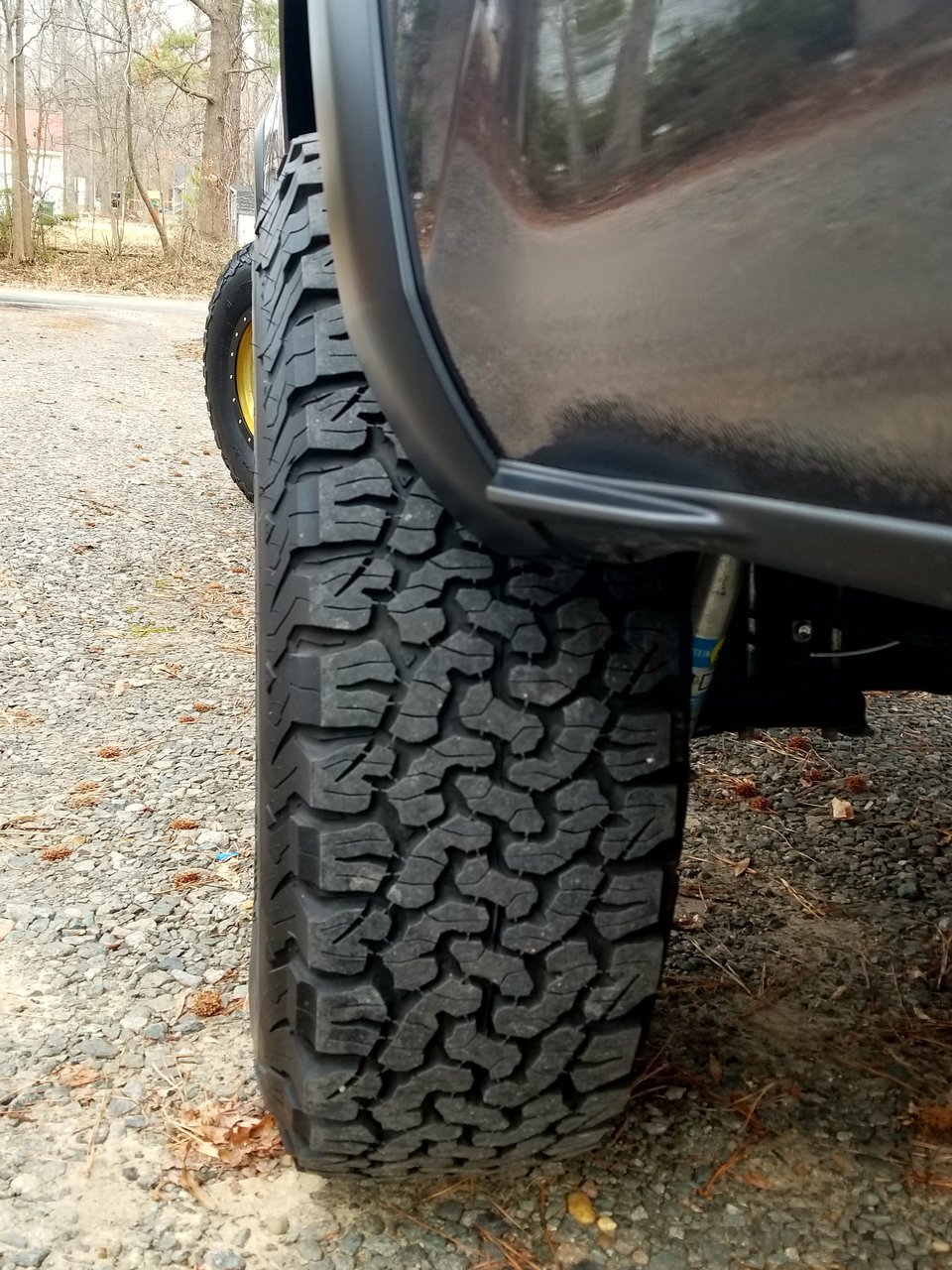

    upload_2018-1-22_7-24-16.jpgupload_2018-1-22_7-24-51.jpgupload_2018-1-22_10-49-23.jpgI went from a 285/70/17's to 255/75/17's Duratrac's last week, I'm pleased so far.

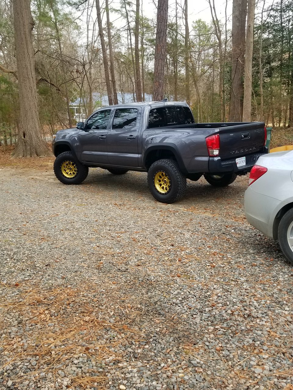

    17TRDOR
    17TRDOR Well-Known Member
    Dec 3, 2016
    #203929
    274
    Ron
    Richmond Va.
    2017 MGM TRD off road

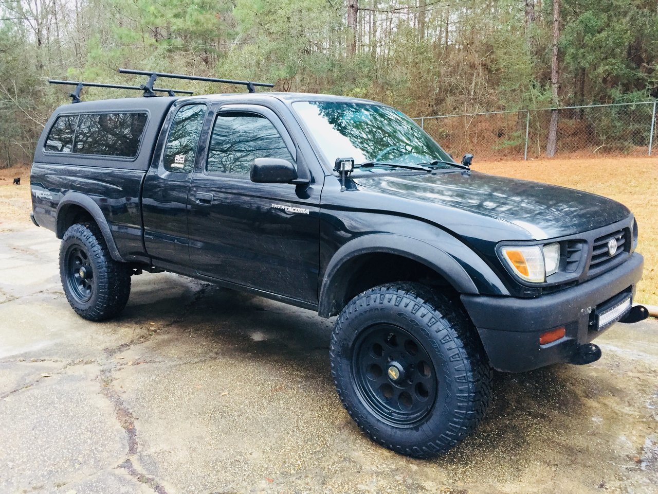

    3 inches, Ray10s, 34s, OVTuning, and driver mod for now.

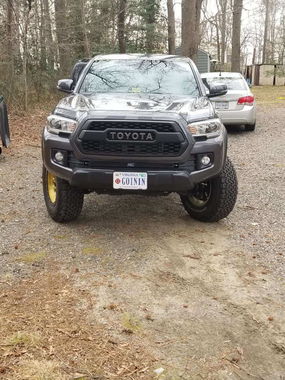

    A few more angles of the 34x10.50s

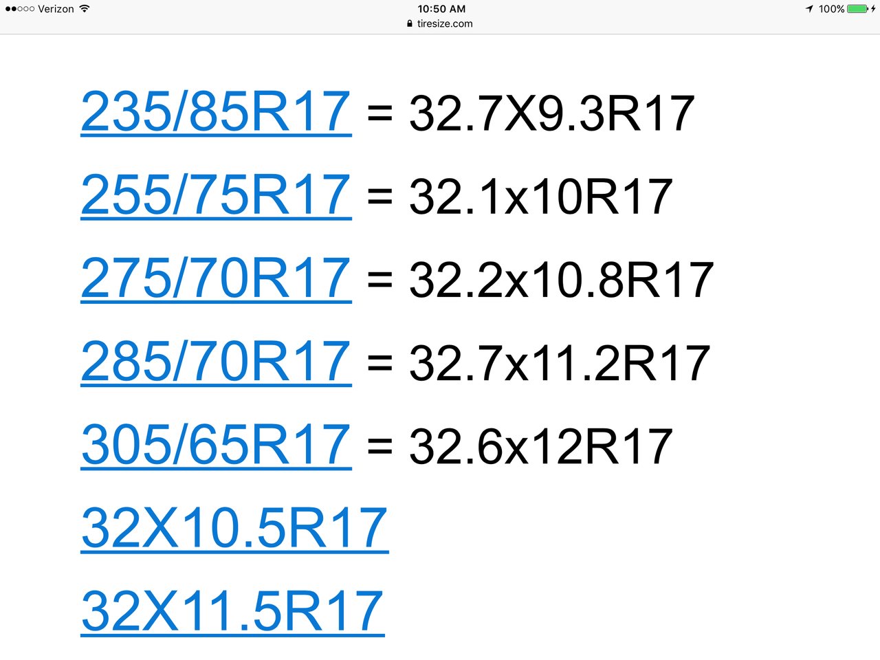

    658

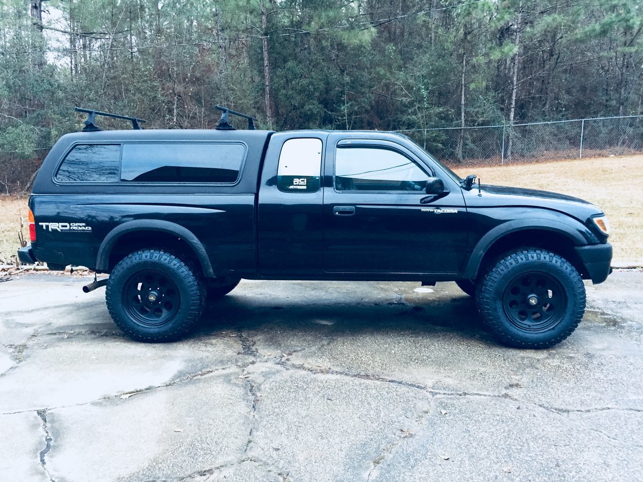

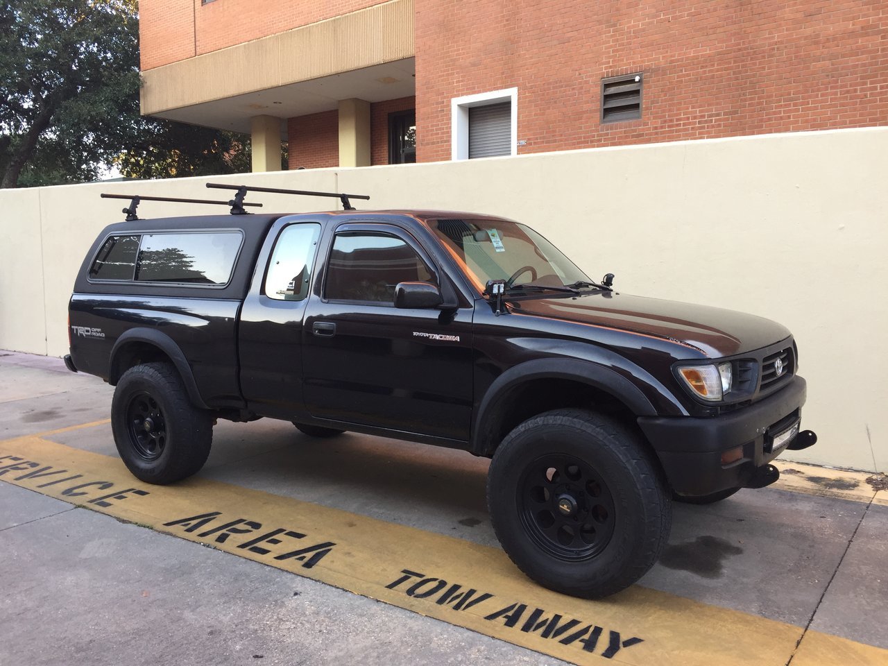

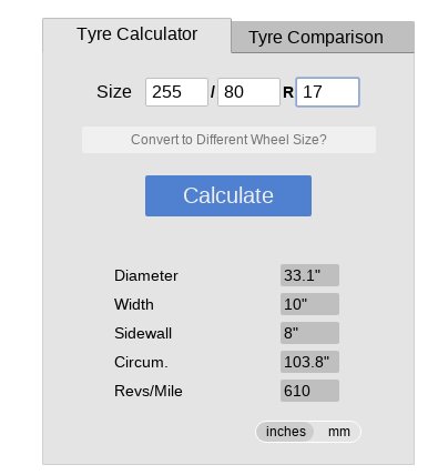

    Oregon
    2014 DCLB Sport 4wd
    My prior tire setup was 255/85r16. If you look and compare the specs on my screen shots you will note they are very close. I ran 0 offset with 4.5 backspace and 8 wide. Also, I was running ST Maxx, which are on the small side and were right at the 32+ size. If you look back there is a comparison pic with 3 tires, and 1 is the ST Maxx.
    It is Very alignment dependent on How much, not if you will rub. With that said, you would still have to remove the front mudflap and trim the bottom of the fender flare in the lower rear well.
    Hopefully someone will chime in that has the experience with exactly what you want. It is strictly a guess, but I'm thinking a 30" will be max to keep the front mud flaps. IMG_0257.jpgIMG_0256.jpg

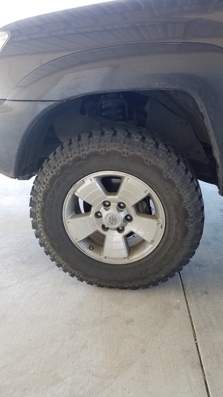

    #140
    speedtre
    speedtre Well-Known Member
    Dec 21, 2015
    #172822
    549
    DirtySouth
    '17 DCLB TRD OR AT 4x4
    One more not listed there...
