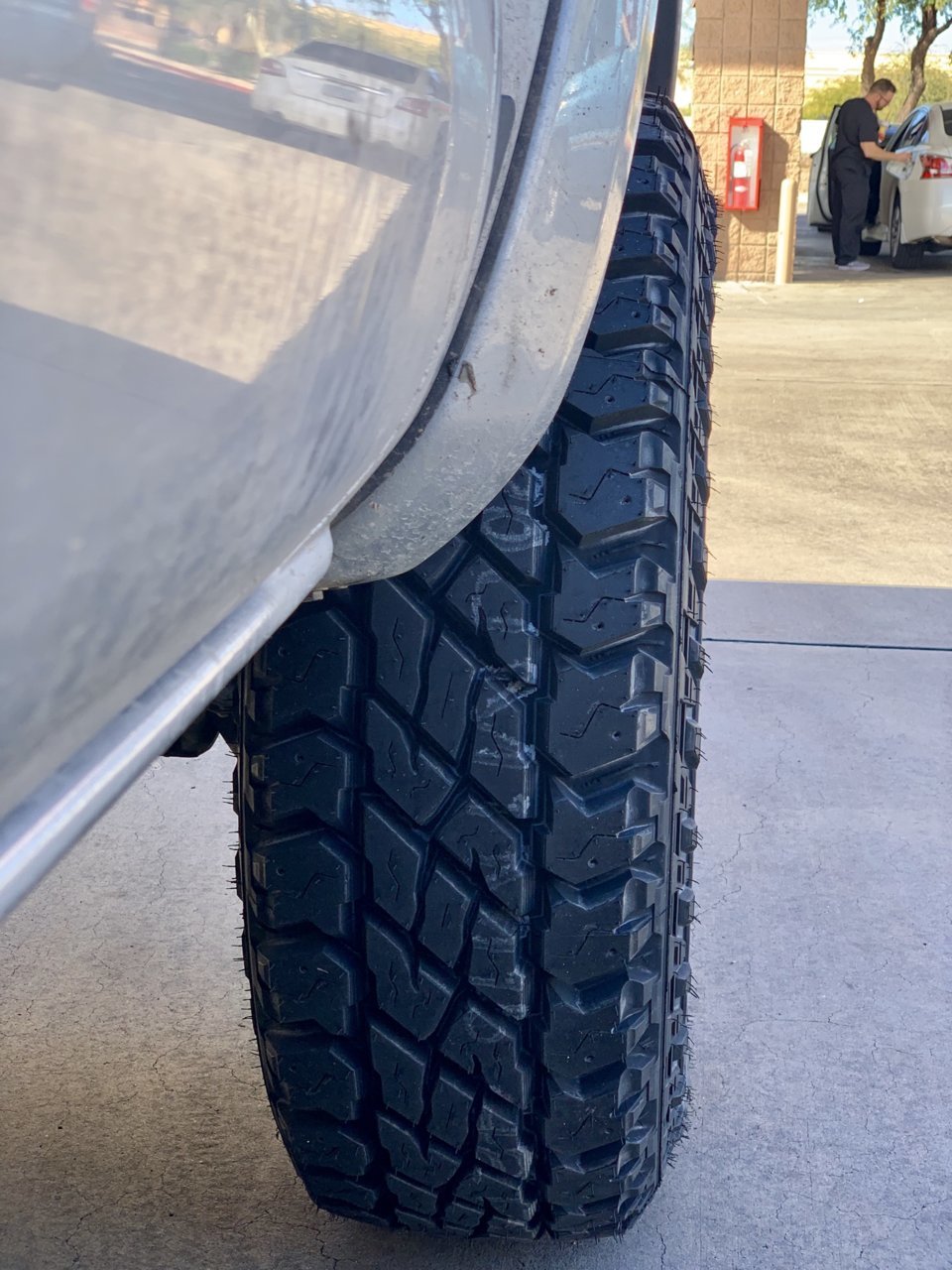

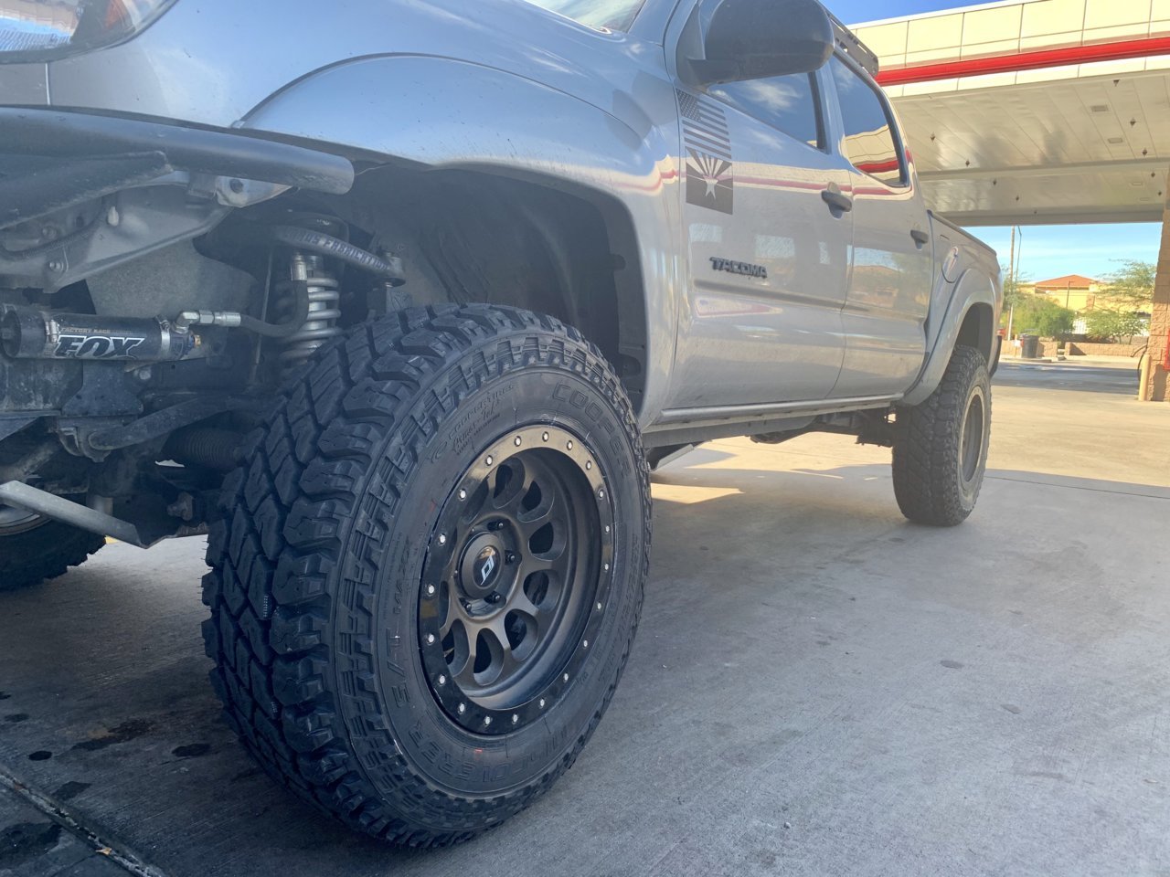

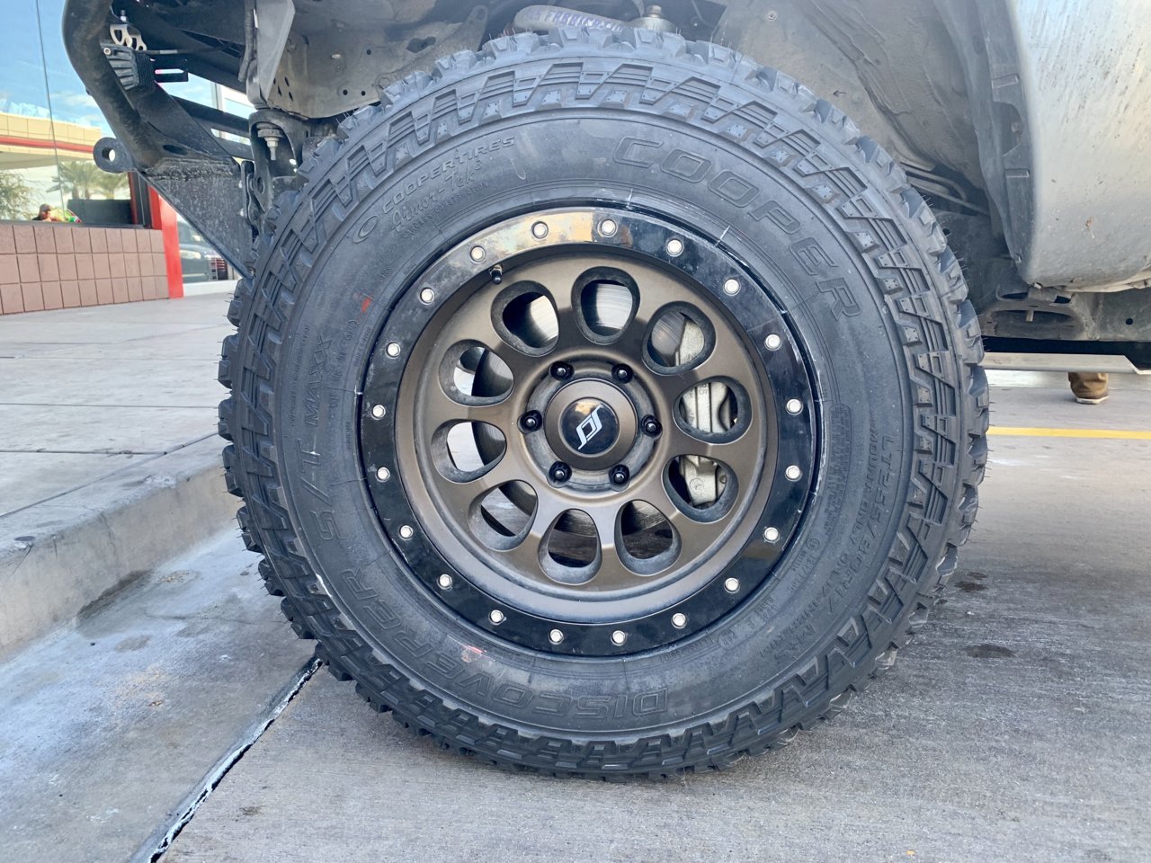

    Fresh 255/80r17 on my dirty Ray 10s

    Looks good man! Will be doing that very soon.

    Anyrub?

    You know offset and width of your wheels?

    The wheels are 17”x7” and I think they are -4 offset but not positive. They are the Sema TRD Pro wheels made originally for the T4R so someone should be able to chime in.

    Just be careful with those tires. When I totaled my last truck on ice I had those ties, and they absolutely were the worst tire I've ever run on ice/snow. I know that very few tires are good on ice, But the coopers I have now are actually much better. The spot I wrecked, I drive every day, and it has iced since I put these on. Just thought Id give you a heads up.

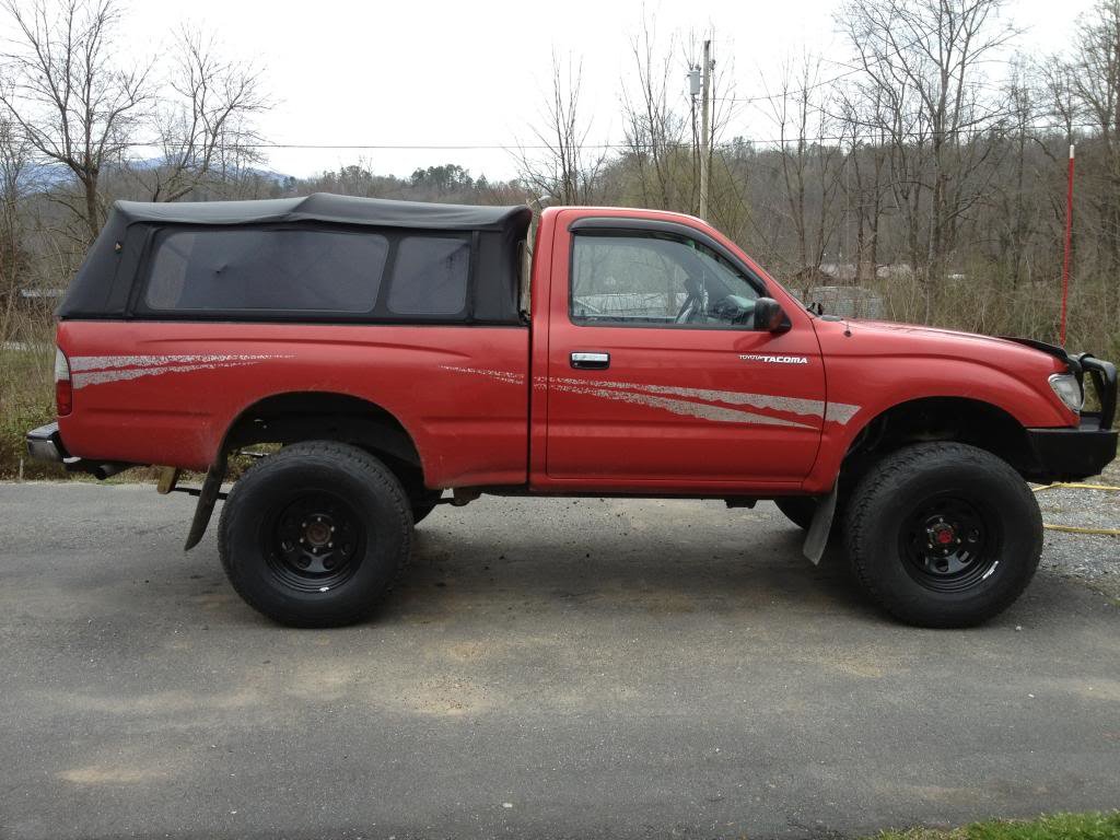

    They look magnificent without flares.

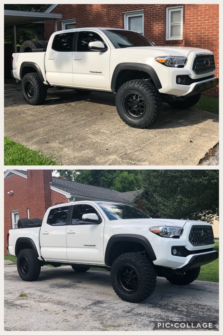

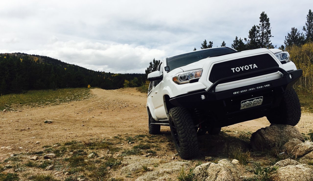

    F86E7156-F726-4047-A50D-2E5A5DD2DEDF.jpg Picture shows BFG MT’s 245/75r17, before I got my Cooper ST Maxx. 255/80r17. Love em, work great here in Colorado.

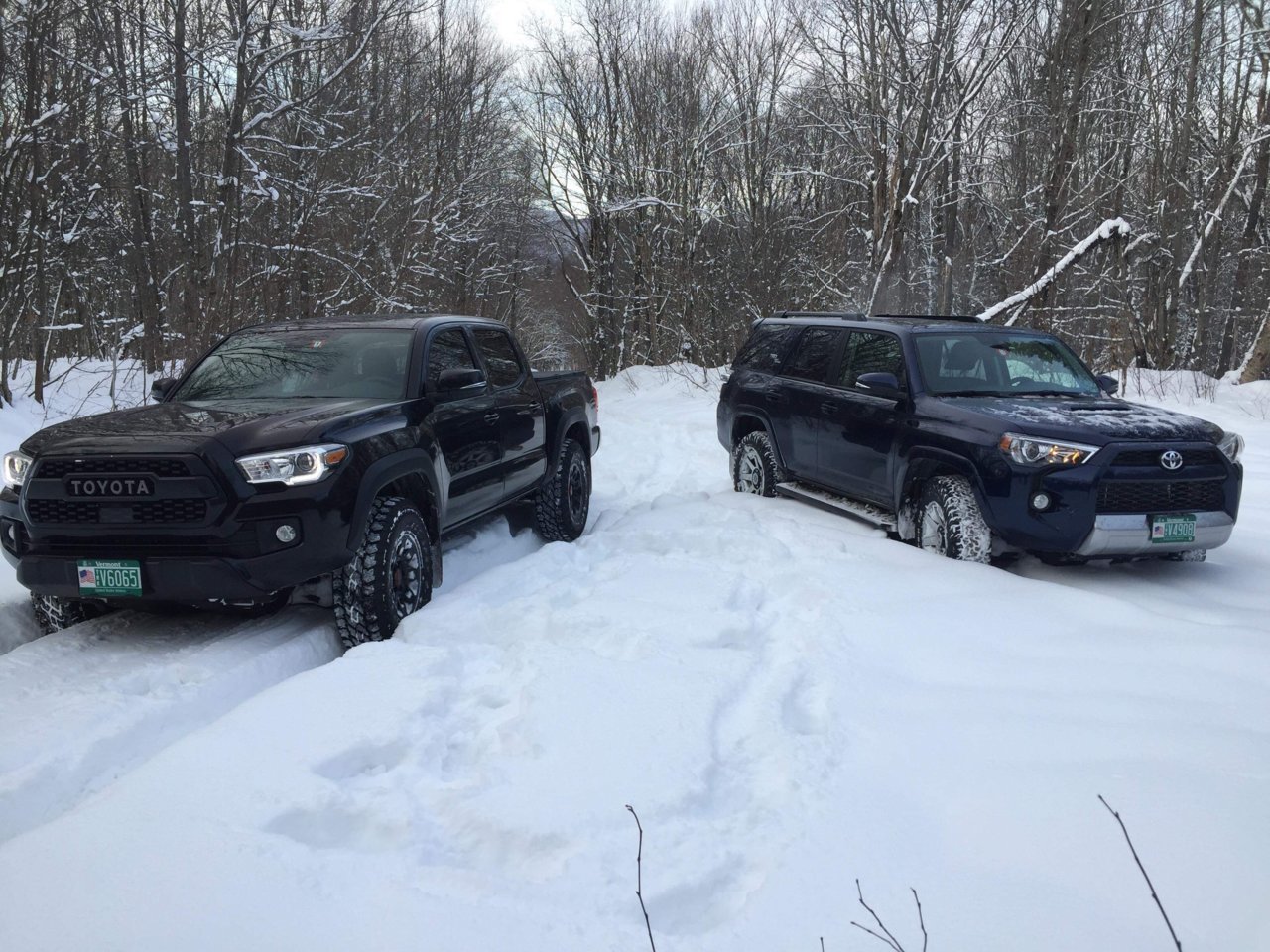

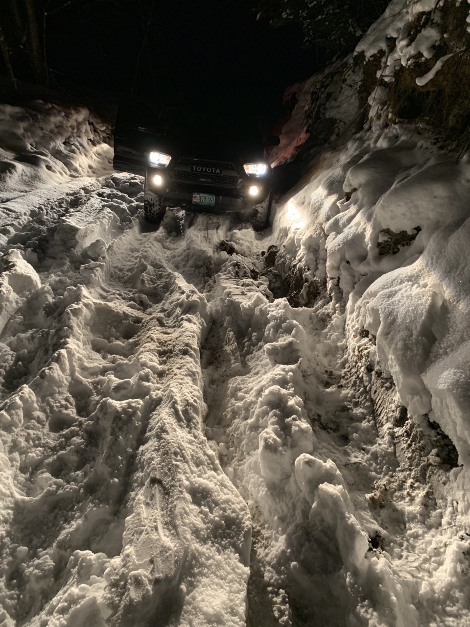

    So I had my first outing with the ST’s, these things are awesome! Every time I started to bog down in the snow, a little wheel spin would pull me right through. I love these tires. Planning on a lift but never hit a point where I needed it. Only issue i had was climbing a hill that my friends 4Runner made it up no problem. I had to back down and get a run at it. But it was coming right out of a stream and the Tacoma’s are super light in the back so it wasn’t a surprise. More reason to get a bed rack. And bumpers. Couldn’t believe how capable this thing was just by throwing on new shoes

    He chewed that hill up bad. Good hearing you made it with speed.
    I have no bad things to say about 235/85r16 stt muds. In a foot of snow all the other rigs would float and couldnt get up. At 20f and 15r psi I backed up the hill dug in. Then popped right out over and over, normally I run them at 10psi in the front and 8 in the rear, and can go anywhere not blowing a bead.
    Thus skinnys dig when you need it and float when you dont. You just gotta be mindfull of your throttle and not try and skinny pedal everything.

    I should have aired down, whoops
    I made good use of the rev limiter :)
